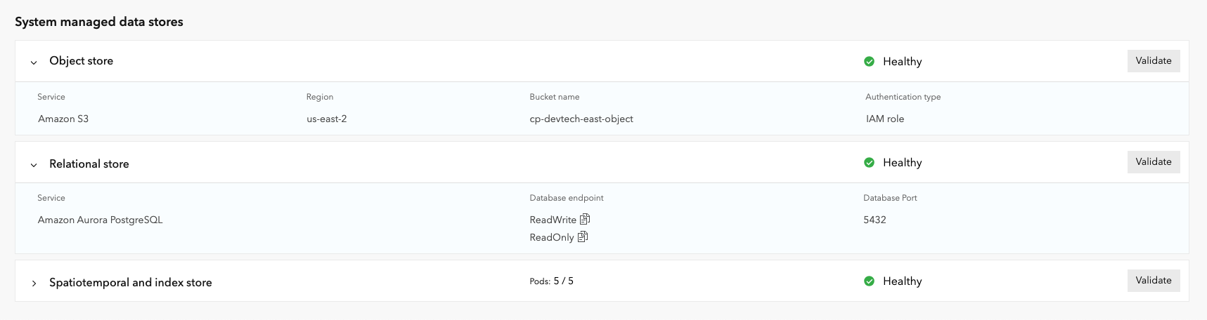

Organization storage is another area where you can increase the availability of your organization. When considering storage options, you can choose to integrate with cloud services for both the object and relational stores. This provides durable, easily scalable solutions and reduces the footprint of stateful workloads running within the cluster.

- Register a cloud object store as a backup store to provide increased durability and scalability

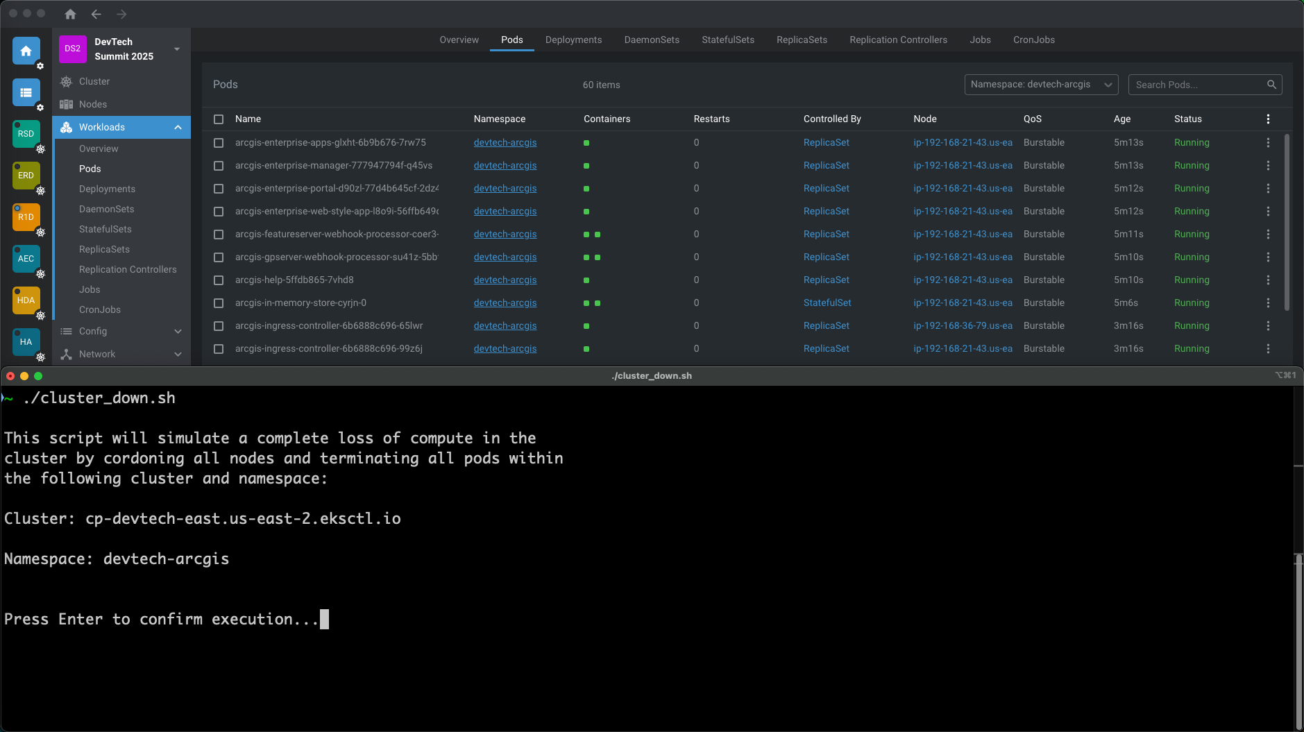

Testing the recoverability of an organization
To demonstrate the recoverability of the organization and to test that his recovery time objective (RTO) is met, Chris simulates a regional failure in which the primary cluster is taken completely down.
Chris has set up two clusters and named the organization to signify the region the traffic is routing to.
Chris runs a script that will cordon all nodes in his cluster and forcefully terminate all pods in the deployment namespace.

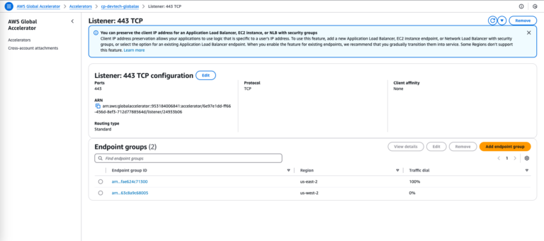

In his system architecture, Chris has implemented Global Accelerator as a traffic manager in front of the two regionally separate endpoint groups. This minimizes the downtime for end users and automatically reroutes traffic to the secondary organization following a failure in the primary.
Once he reopens his organization home page in a new browser, he is directed to the replicated organization in us-west-2 instead of the primary in us-east-2. During this interruption, his organization has accumulated under a minute of downtime, allowing his end users to continue work with minimal disruption.
