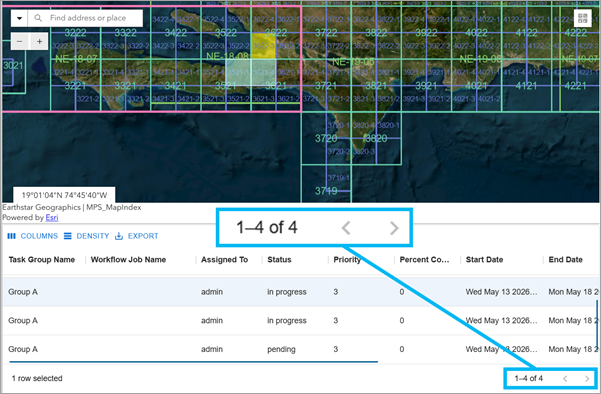

TPM app
As mentioned above, thanks to the enhancements to the query operation, the list of jobs in the TPM app are now displayed in manageable chunks with page numbers under the list to flip through subsets of jobs rather than scrolling one list.
Topographic Production Manager web app job list pagination
You can now click a job on the map in the app. This highlights its area of interest (AOI) and selects its record in the table to bring up the job’s details in a new Job Details pane. When a job’s details are updated, you can see the updates using the new pane’s included refresh button. This refresh button is also available on the list of jobs.
