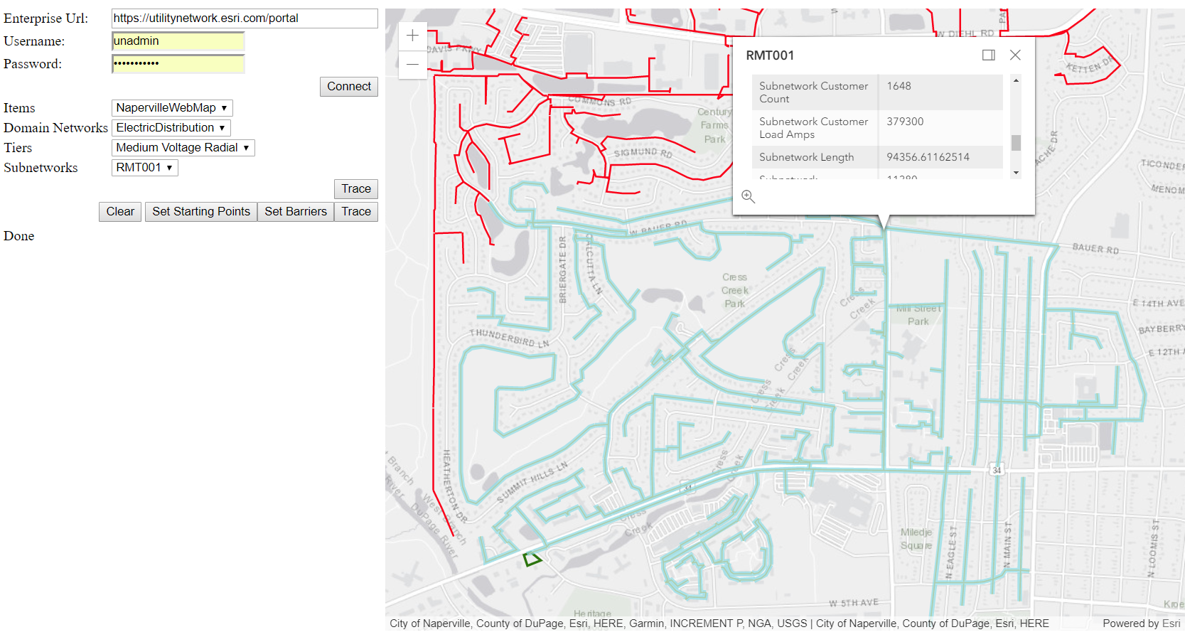

The fun part starts here when the user selects a subnetwork, and now we want to select the subnetline feature corresponding to the subnetwork. The subnetwork must be updated for this to work. Like the Subnetworks layer, the subnetline layer is a special system layer and we need to ask the utility network for its id. The utilitynetwork helper class has that method that returns the subnetline layer which is in the utility network definition. We then query that layer only returning geometry since that is the only thing we are interested in. Finally, we create a graphic of the returned geometry and add it to the map view making sure to clear all existing graphics to end up with multiple graphics on the map. Here is an illustration of the result.
Subnetline feature class
A graphic result of the subnetline feature class with RMT001 subnetwork selected. The Subnetwork Customer Count, Subnetwork Customer Load Amps, and other attributes pertaining to this subnetwork can be viewed here.

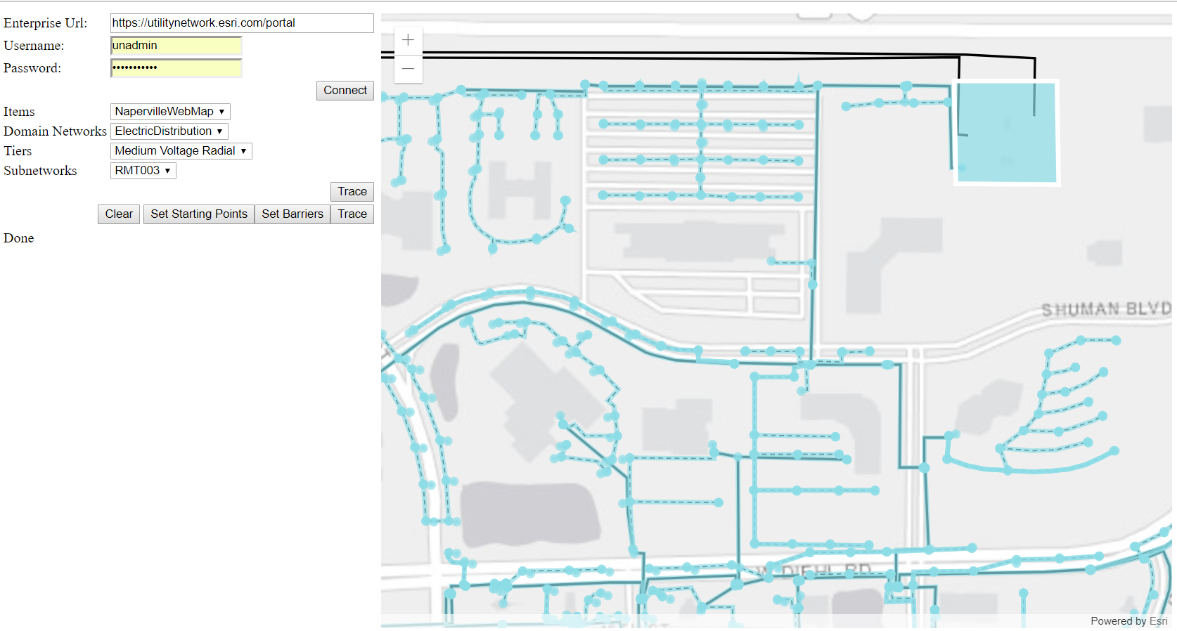

A graphic result of selected features from the trace result for the RMT003 subnetwork.
