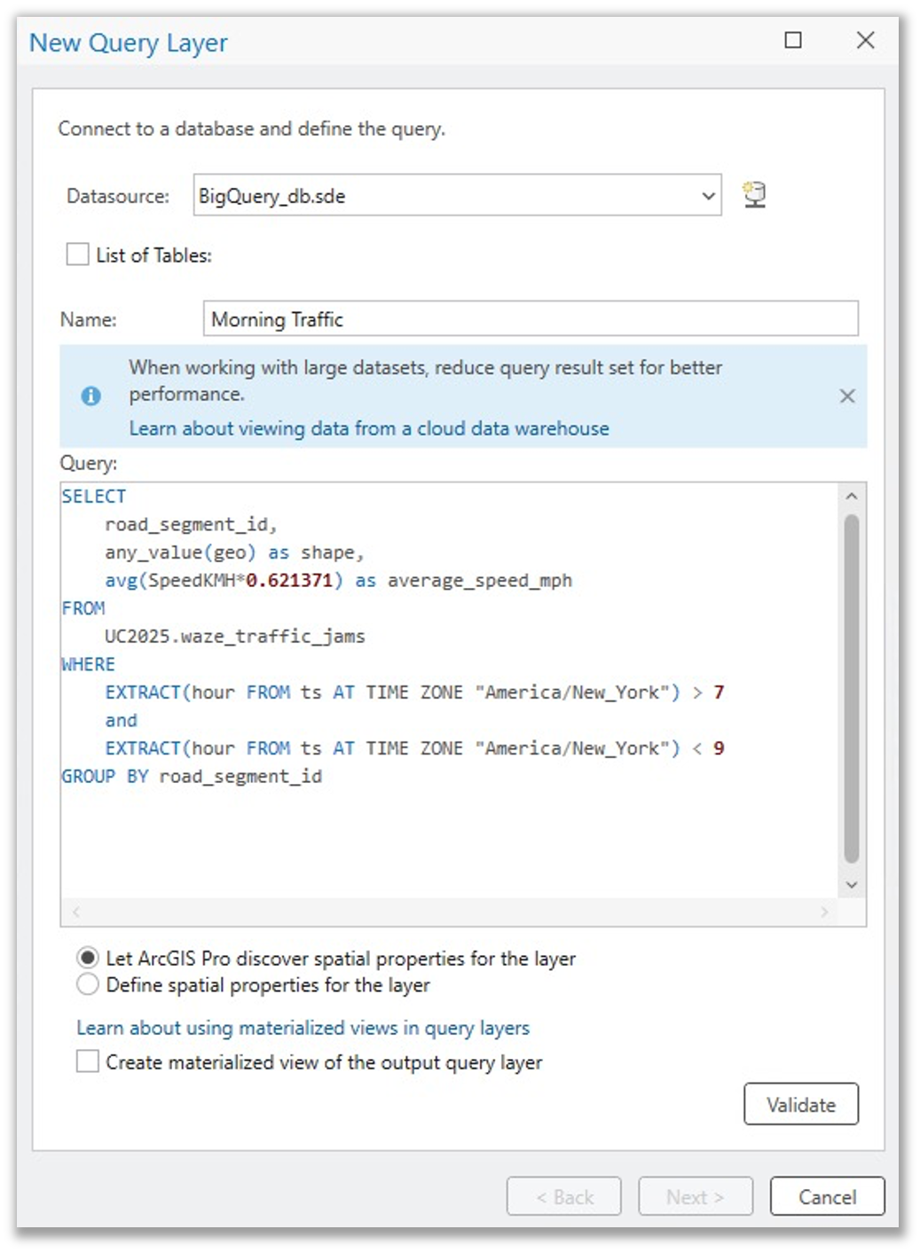

Cloud data warehouses store tremendous amounts of data, and it’s not uncommon to have a table that contains hundreds of millions of records. To effectively visualize or analyze this data in a GIS, like ArcGIS Pro or ArcGIS Enterprise, you should use SQL to define a query layer that aggregates that information into something meaningful.
For example, a traffic dataset could be brought into ArcGIS Pro using an analytical query layer that averages all speed readings taken between the hours of 7 and 9 am for each street segment.
New query layer tool in ArcGIS Pro.
Query layer summarizing morning rush hour speed data by street segment, with units converted from kilometers per hour to miles per hour.

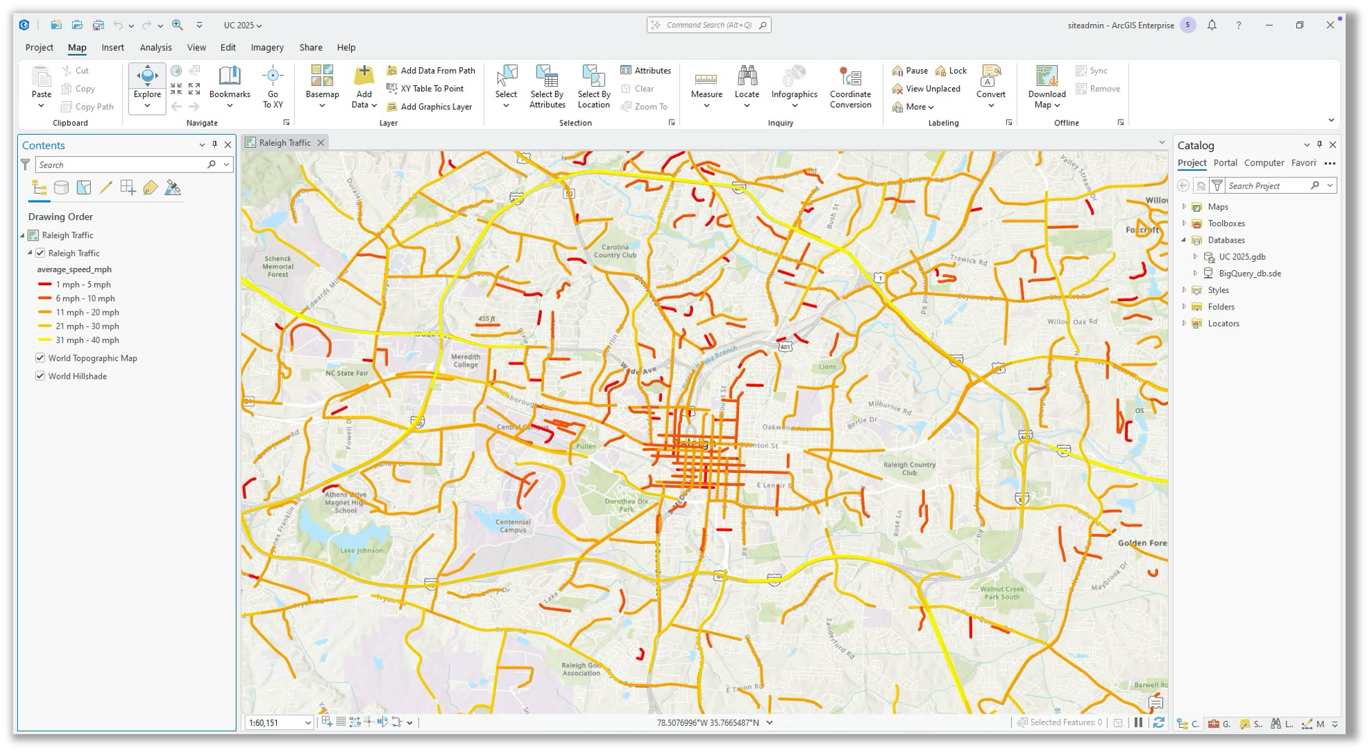

The resulting layer could then be used to visualize and analyze morning rush hour traffic patterns. The original table contains more than 27 million speed readings captured at specific intersections and street segments in Raleigh, North Carolina. But because we grouped the data by street segment in the query layer definition, ArcGIS Pro only needs to display 8,701 features.
Query layer in ArcGIS Pro
Layer symbolized by average speed to show morning rush hour traffic.

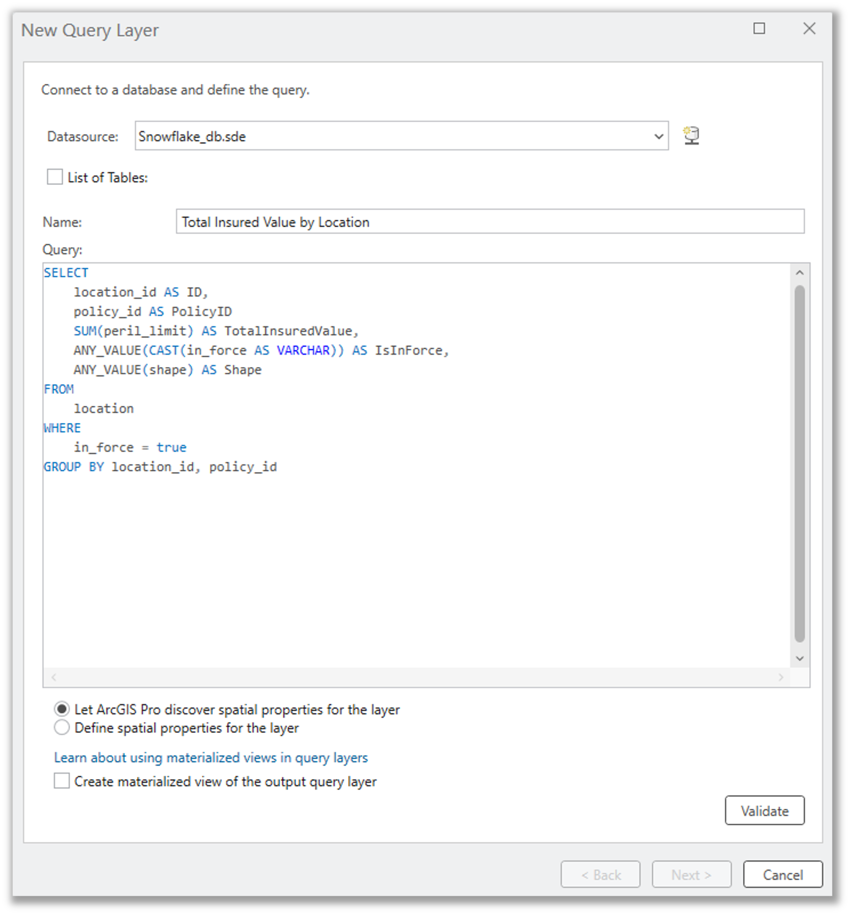

ArcGIS supports specific data types. When data is integrated from a user-managed database, like a cloud data warehouse, every field (or column) you bring in as part of your query layer definition must have a data type that maps to an ArcGIS field data type. If your table includes a data type that is not supported in ArcGIS, you will need to either eliminate the field from your query layer or you can convert it to a compatible data type using a cast function in the query layer definition.
For example, an insurance company stores property insurance statuses in a Snowflake table using the BOOLEAN data type, with values of True or False to indicate whether a property is currently insured. Since ArcGIS does not support Snowflake’s BOOLEAN data type, this field can be easily cast to the VARCHAR data type, which maps to the ArcGIS Text field data type.
Query layer that aggregates the total insurable value for each property across all peril types, limiting the results to only the properties that are currently insured.

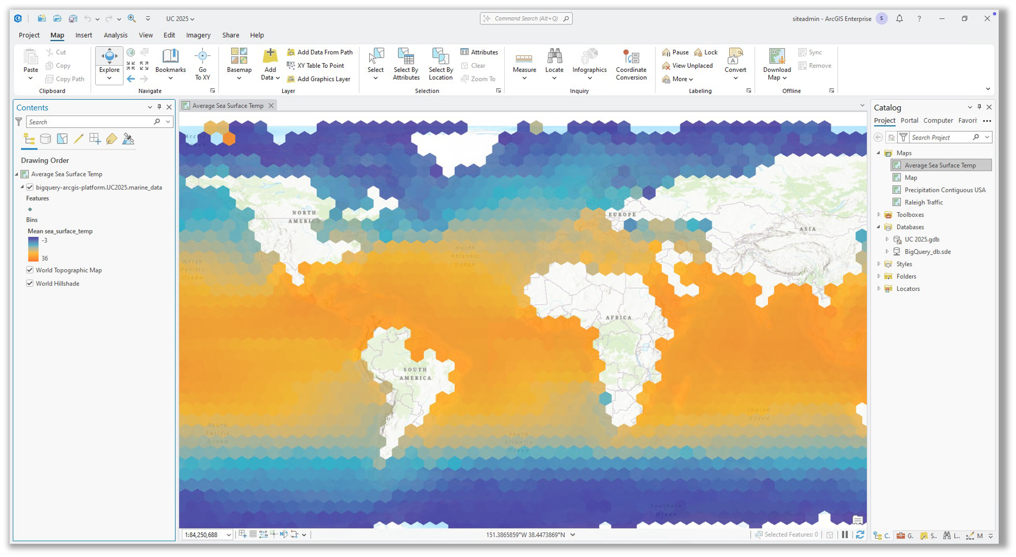

Did you know that ArcGIS Pro includes an Enable Feature Binning tool that can be used to aggregate large amounts of point features into dynamic polygons called bins? Well, it’s true! While users can set the display of a feature layer to draw using bins client-side by modifying the display properties of a layer in ArcGIS Pro or Map Viewer, database-driven feature binning is much more performant when working with hundreds of thousands or millions of features in a database or cloud data warehouse. This is because the feature bins are calculated in advance and stored within the respective database, instead of being generated on-the-fly as the data is being displayed.
Feature binning in ArcGIS Pro
Query layer in ArcGIS Pro showing average sea surface temperature from a Google BigQuery table with 358 million data points, aggregated into feature bins.

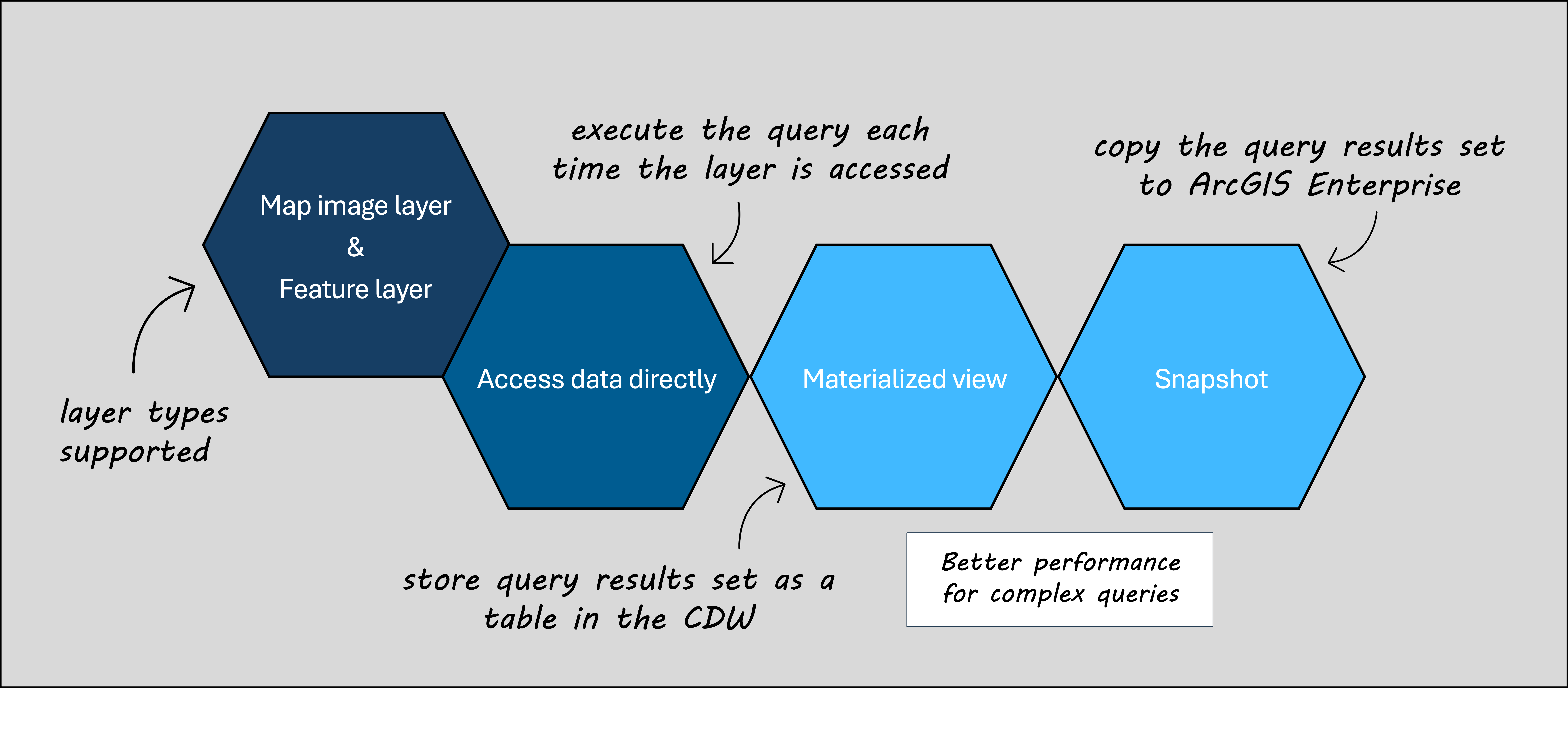

Best Practice #5: When sharing layers to ArcGIS Enterprise, use a materialized view or a snapshot
When a web layer is shared from a cloud data warehouse to ArcGIS Enterprise, the publisher has options for how the data should be accessed. The options are to access the data directly, create a materialized view, or to create a snapshot.
Share web layers from ArcGIS Pro to ArcGIS Enterprise
When sharing web layers to ArcGIS Enterprise, ArcGIS Pro presents the users with options for how the data should be accessed from a cloud data warehouse.
What’s the difference? Well, we are glad you asked.

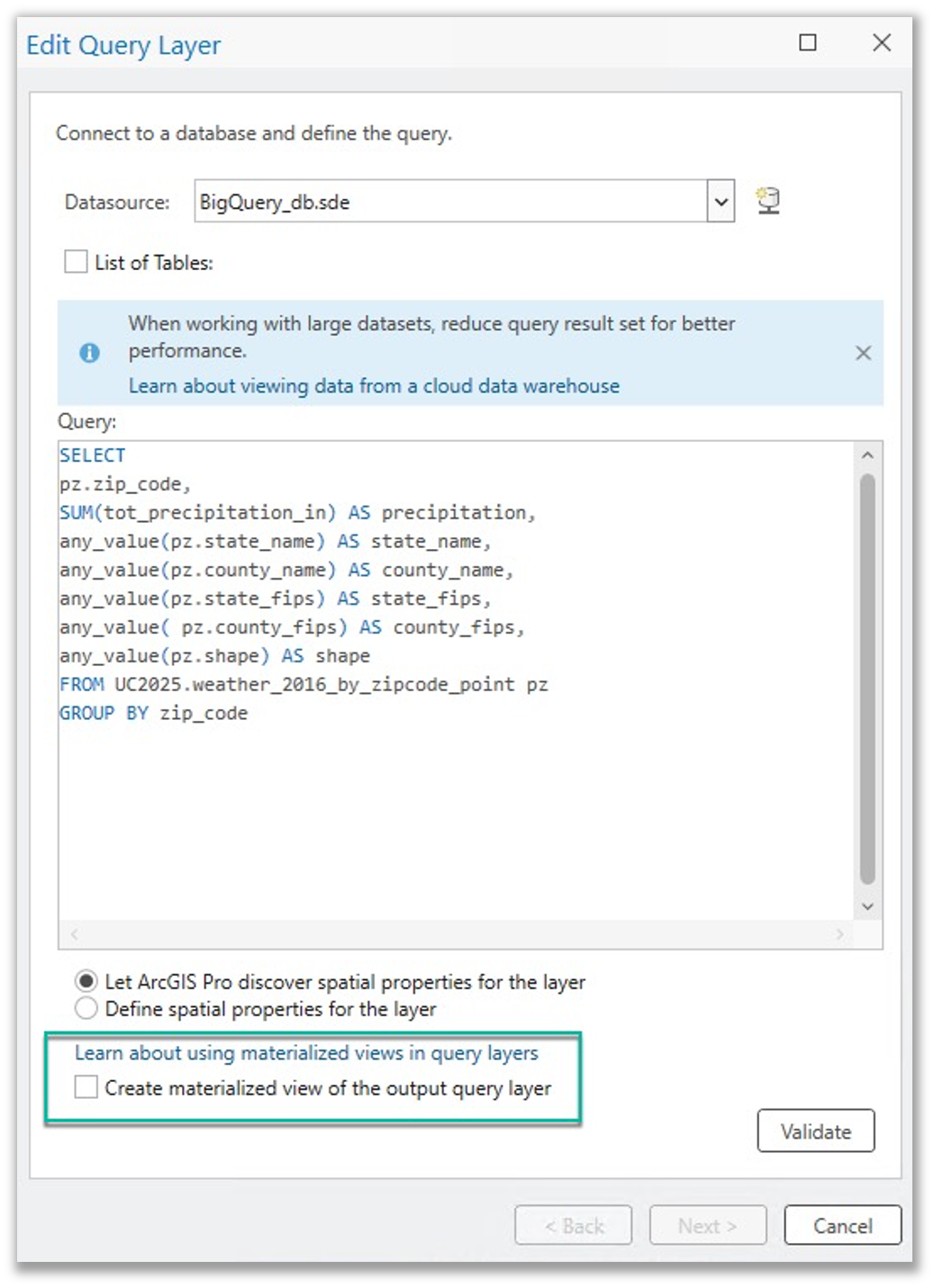

When creating a query layer in ArcGIS Pro from a cloud data warehouse, you will be presented with the option to create a materialized view.
Edit query layer in ArcGIS Pro
The option to create a materialized view is available when creating or editing a query layer in ArcGIS Pro.
A materialized view will store a copy of the query results set within the cloud data warehouse, and ArcGIS Pro and ArcGIS Enterprise will reference this instead of querying the tables directly. This provides an advantage from a performance perspective, especially for complex queries. If data is changing, the materialized views will be updated behind the scenes, with little to no delay. This also provides an advantage from a cost perspective, as reduced compute usage for each query generally results in fewer compute units or dollars spent on compute in the cloud data warehouse software.
If you do not create a materialized view, the query layer in ArcGIS Pro will result in the full query used to define the layer being used each time the layer is accessed. For complex queries, this can result in poor performance when compared to accessing the query results set that could have been persisted using the option to create a materialized view. That said, the benefit is that the results return real-time information without any delay.

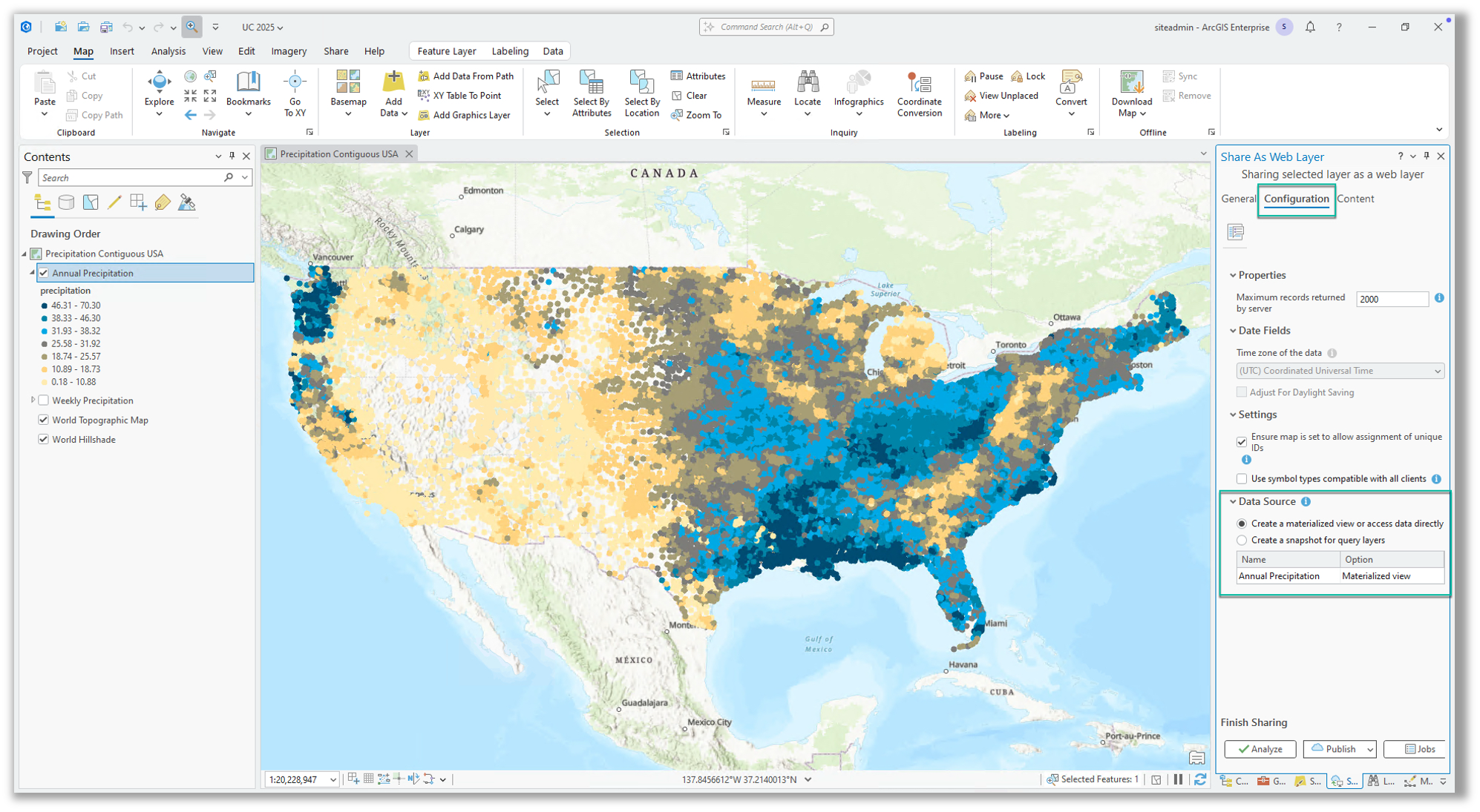

When publishing to ArcGIS Enterprise, the Configuration tab of the Share as Web Layer pane will present the users with the options for how the web layer should (or should not) reach out to and communicate with the cloud data warehouse. If a materialized view was created when defining the query layer, that will be the default option. Otherwise, it will be configured to access the data directly. Regardless of which is chosen, there is another option presented, unique to ArcGIS Enterprise, which is to create a snapshot.
If you choose to create a snapshot, you are telling the software to take the copy of the query results set and store it in ArcGIS Enterprise to support the web layer. With this option selected, interaction with the web layer will not result in any queries being pushed to the cloud data warehouse.
Sharing options for ArcGIS Enterprise
Sharing options for cloud data warehouses as they relate to ArcGIS Enterprise.

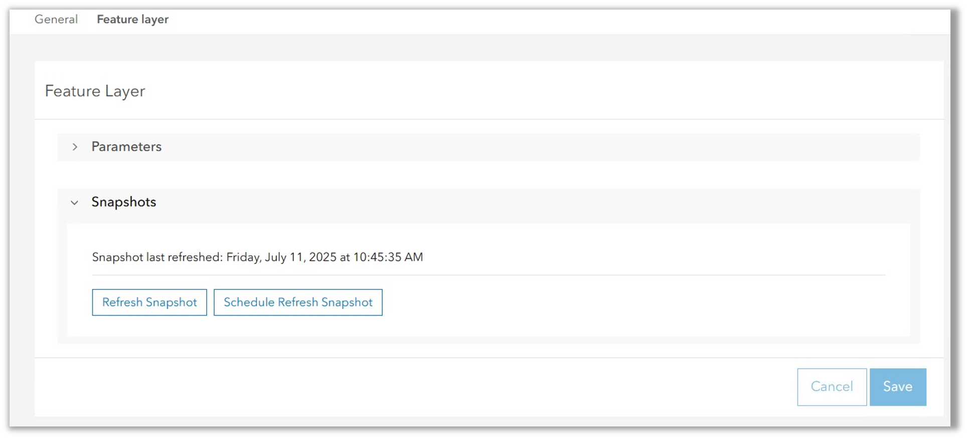

Sharing the data as a snapshot is a great option if the data is static, or if you are unable to co-locate ArcGIS Enterprise in the same cloud region as your cloud data warehouse. This is because the query results set supporting the layer is now co-located with ArcGIS Enterprise, stored in the relational data store. If the data needs to be updated, snapshots can be refreshed from the item page, settings tab. And, in ArcGIS Enterprise 11.3 we also added the option to schedule refreshes to snapshots, making this even easier.
Refresh Snapshot ArcGIS Enterprise
If data is shared as a snapshot, updates can be made on demand or scheduled from the item page in ArcGIS Enterprise.
To summarize, when sharing layers to ArcGIS Enterprise from cloud data warehouses, it is generally a best practice to configure the layers to access the data using either a materialized view or a snapshot. Otherwise, the full SQL query is going to be run against the tables in the cloud data warehouse anytime the web layer is accessed.
