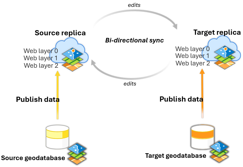

With the latest release of ArcGIS Enterprise 12.1, we are expanding these capabilities to support two-way synchronization between feature services.
This enhancement enables bidirectional data exchange, allowing edits to flow between two services that are backed by separate data sources—unlocking new collaboration and data management workflows.
Two-way feature service-to-feature service sync workflow diagram

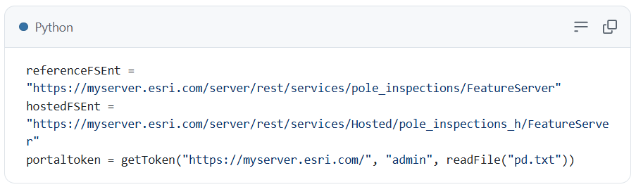

The script starts by calling the ArcGIS REST API to connect to the existing, already published feature services that act as the source and target services in this workflow. So, the first things you need are as follows:
  • The REST URLs to both FeatureServer endpoints
  • A valid token
In the sample script:
Access the feature services

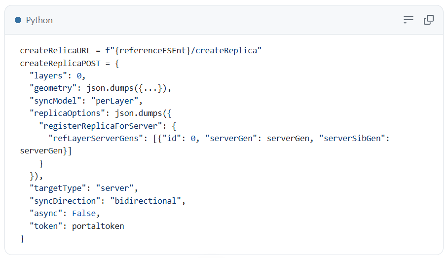

Create the replica on the source (referenced) service
The script calls the createReplica function on the referenced service with the following parameters:
    • targetType = server (server-to-server style)
    • syncDirection = bidirectional
    • syncModel = perLayer (in this example the data is non-versioned with archiving enabled)
    • a geometry envelope for the replica extent
    • The serverGen parameter defines the starting point for synchronizing edits. It is a Unix epoch timestamp in milliseconds that marks the replica creation time and tells the server from which point to send changes. Before running the script, generate a Unix epoch timestamp (in milliseconds) representing the moment you want synchronization to begin, such as by using an online epoch timestamp converter. It is important to choose a time when the source and target services contained identical data, as this establishes the baseline for change tracking.
Key parameters in the sample:
Create replica on the source feature service
Note: If you are familiar with the one-way feature service sync workflow, you will notice the key difference is that the syncDirection parameter is now set to bidirectional.

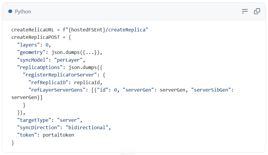

Create the replica on the target (hosted) service
Once you have the replicaID from the source, you create a replica on the hosted service using refReplicaID allowing both replicas to align and participate in the same replica pair.
In the sample:
Create replica on the target feature service
At this point, you have a paired replica setup: source ↔ target.

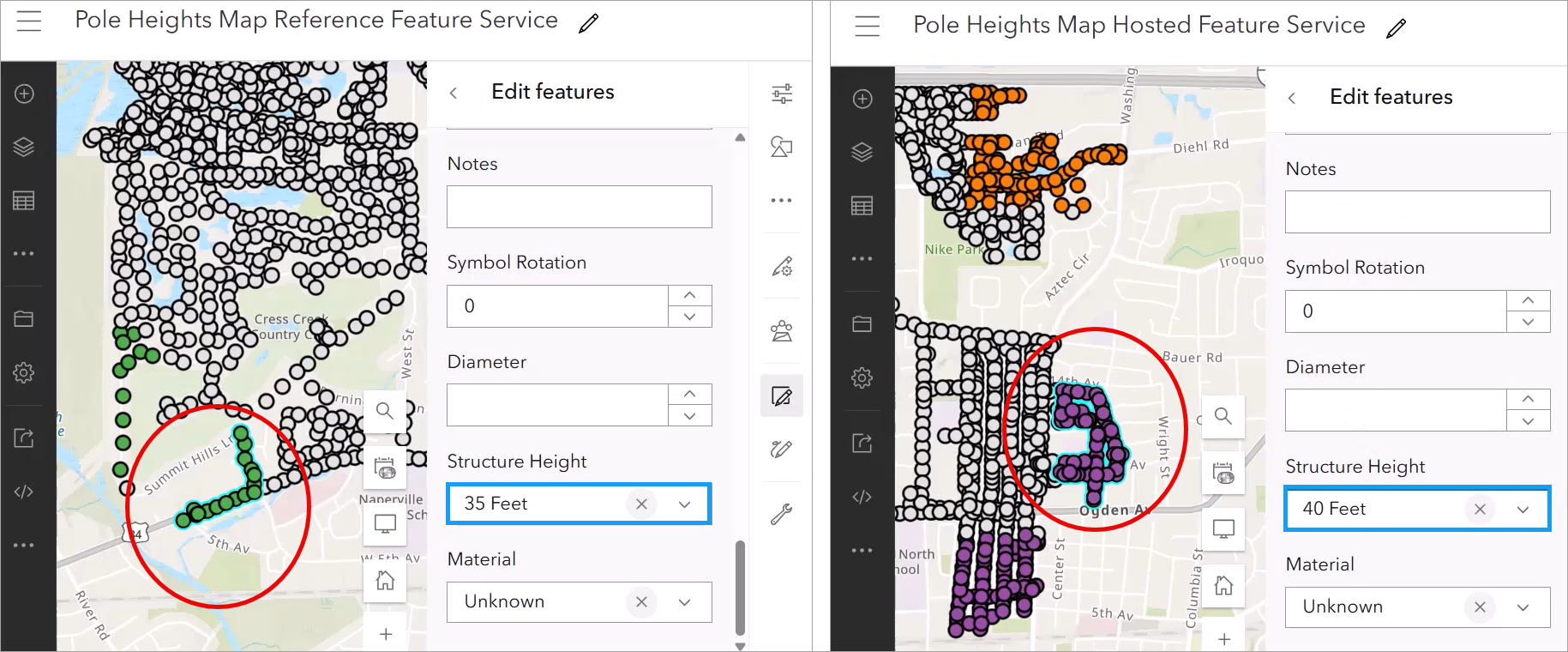

In this example, attribute edits are made to both the source and the target feature services by changing the pole heights.
Making web edits to the pole inspection data

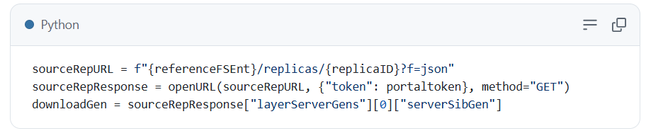

A. Sync download from the source (pull edits made on the source)
To start the two-way synchronization, the script performs a download on the source feature service (in this case, the referenced service). This download is performed based on the last edits received by the target feature service, so the source only packages what the target still needs.
Read the target replica state
The script queries the target’s replica metadata to get the “last received edits” generation number.
Read the target replica state by checking for the last edits received.

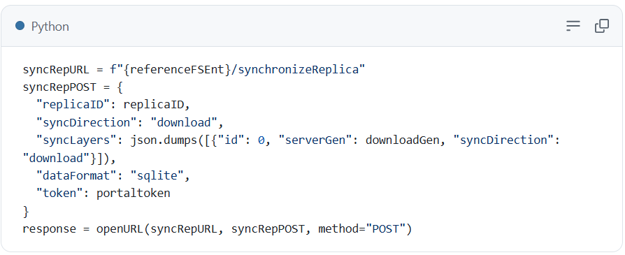

Call the synchronizeReplica function with syncDirection=download
Then it calls synchronizeReplica on the source service with syncDirection=download, passing serverGen based on the generation retrieved above.
SynchronizeReplica function with syncDirection=download
If there are edits to download, the response provides a delta file URL (in SQLite format) that can be passed along to the target service in the next stage.

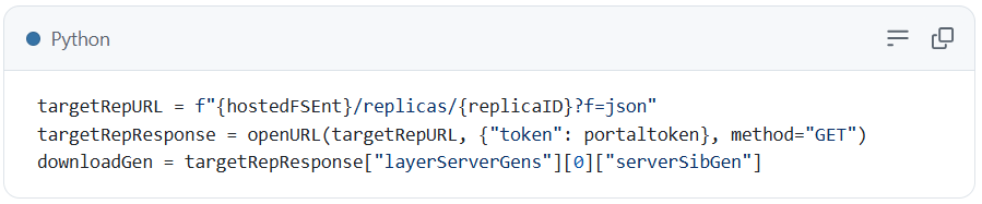

Read the source replica state
Before calling bidirectional sync on the hosted service, the script checks the source replica generations (so the target side knows what the source has already received):
Read the source replica state by checking for the last edits received.

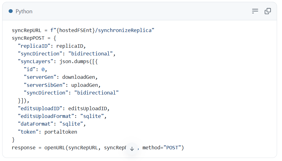

Call synchronizeReplica with syncDirection=bidirectional
Now the target service synchronizes bidirectionally.
SynchronizeReplica with syncDirection=bidirectional
If the target service has no edits to return, it will respond with a “no edits” response type and the workflow ends.

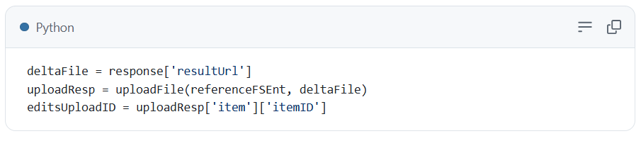

C. Sync upload back to the source (push edits from the target back to the source feature service)
If the bidirectional step produced edits to send back, the target service returns a delta file (in the sample as resultUrl).
Upload the delta file to the source feature service
Upload the delta file that contains the edits from the target to the source feature service.

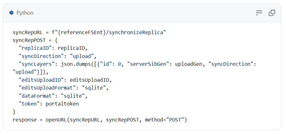

Call synchronizeReplica on the referenced service with syncDirection=upload
SynchronizeReplica on the referenced service with syncDirection=upload
At this point, edits have been exchanged in both directions, and both services are in sync.
