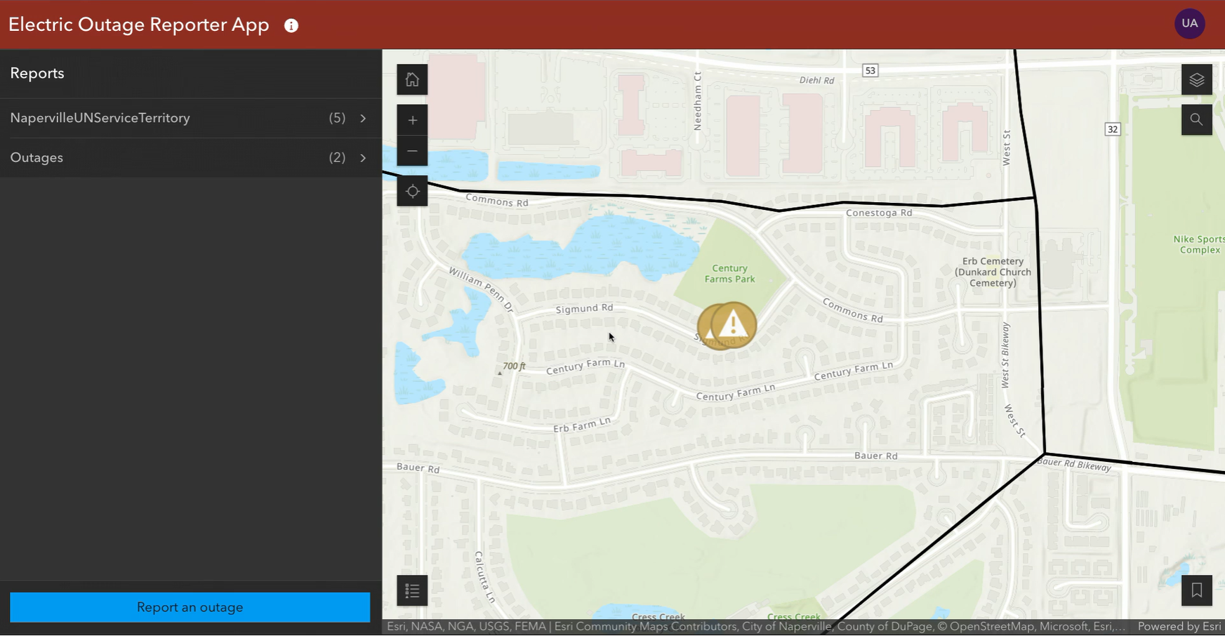

The company also maintains a customer-facing application that customers use to report any outages they experience. When a customer reports an outage, a new feature layer that contains the date and customer ID is added to an outage feature service. This feature service powers a map that displays all reported outages.

First, Shreyas submits an outage report. No sooner had Shreyas submitted the outage than the feature layer with his outage information is added to the feature service. As soon as the feature service updates, the service webhook triggers, which in turn runs the outage management notebook. The notebook then performs the following tasks:

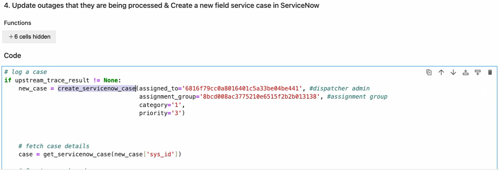

- Create a ServiceNow case and work order that targets the identified location

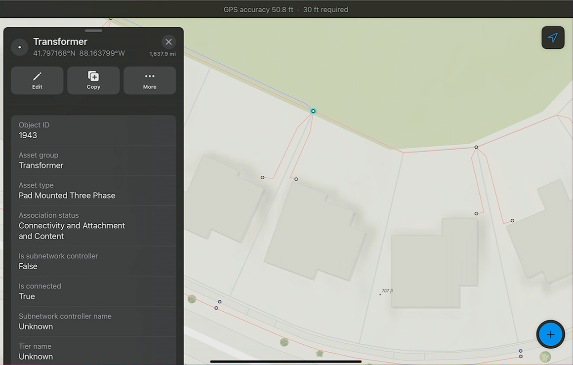

Once field workers have finished with their repairs, they use the field app to make a corresponding update to the utility network service. The utility network service updating triggers the second notebooks. The notebook reads the incoming changes made to the service and compares them to the outage information. The notebook validates that the repairs and outage match up and updates the outages record with the resolution details.
