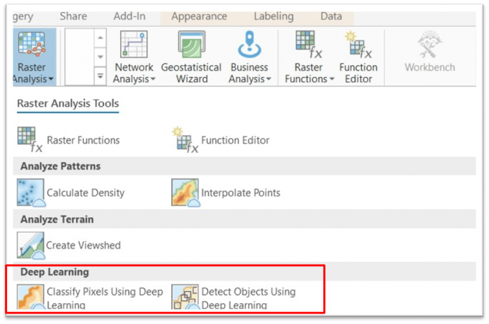

Once you’ve decided on using Enterprise for processing on the backend, you’ll need to choose which client you want to use to invoke your processing/inferencing: ArcGIS Pro, Map Viewer in your ArcGIS Enterprise portal, the ArcGIS API for Python, or ArcGIS Notebooks. All four can be used to kick off deep learning on ArcGIS Image Server, but each option has a different user experience and slightly different benefits.
Benefits of using ArcGIS Pro as a client to invoke deep learning tools on Enterprise:
You can implement your deep learning workflow using the familiar desktop experience. This is especially useful for a GIS analyst who’s already working within the ArcGIS Pro environment and will need access to the full suite of geoprocessing tools to perform post-analysis on the deep learning results.

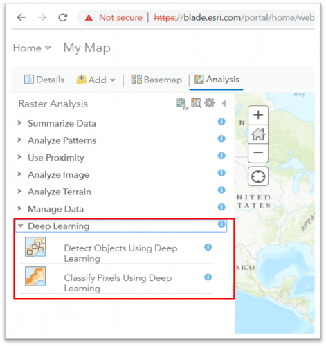

Benefits of using the Map Viewer as a client to invoke deep learning tools on Enterprise:
Use the Map Viewer when you want to invoke processing using a thin web client, especially one that’s accessible to anyone within your organization. With the release of Enterprise 10.7, the existing suite of raster analysis tools in the Map Viewer has been extended to include all the deep learning tools.
