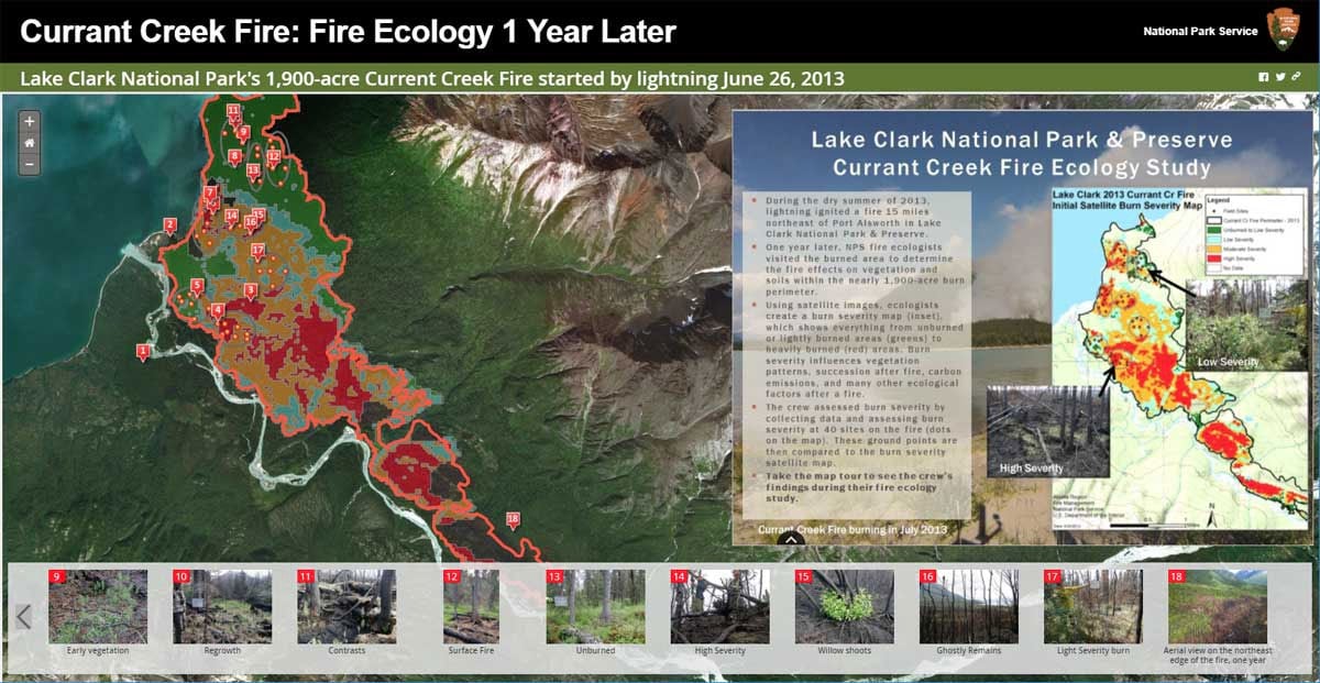

This Story Map Tour uses an image from a PowerPoint slide as the introduction for the Tour.

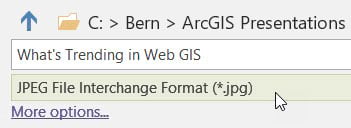

In PowerPoint, go the to File tab and click Save As
then choose JPEG or PNG as the Save as type.

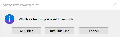

PowerPoint provides the option to save individual slides, or all slides in your presentation.
