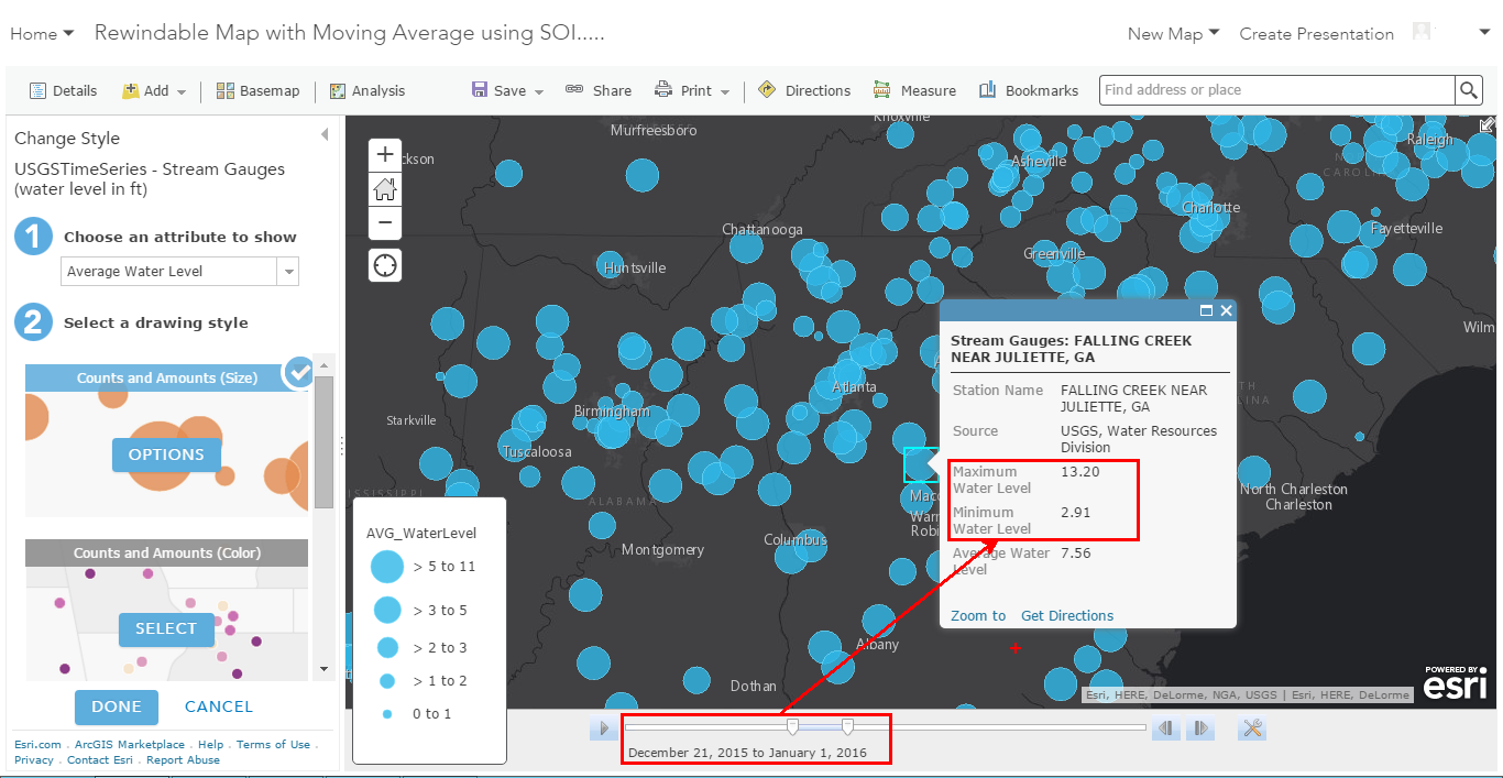

Viewing on the fly computed average water level on the map and popup produced by the SOI powered dynamic map service for a time extent set on the time slider
