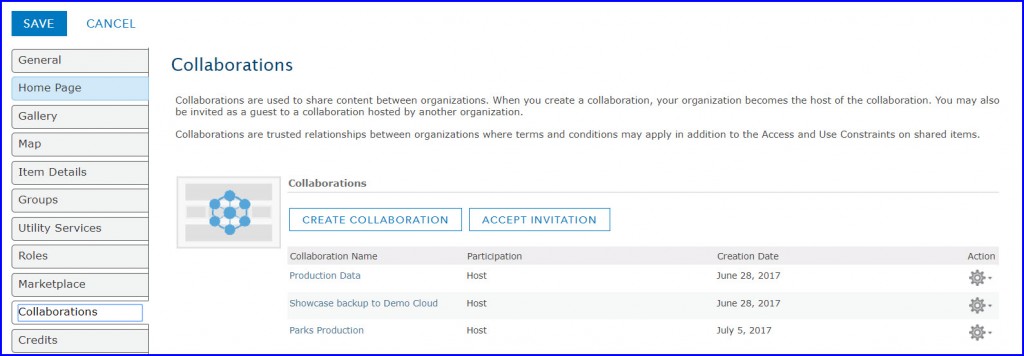

Create the collaboration and workspace in the host environment by following the prompts to create a name, description, and workspace. Currently, ArcGIS Online must be the host of collaborations, so the host in this example will be the Showcase Organization.

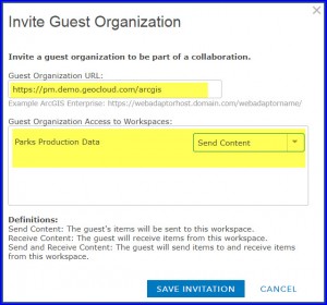

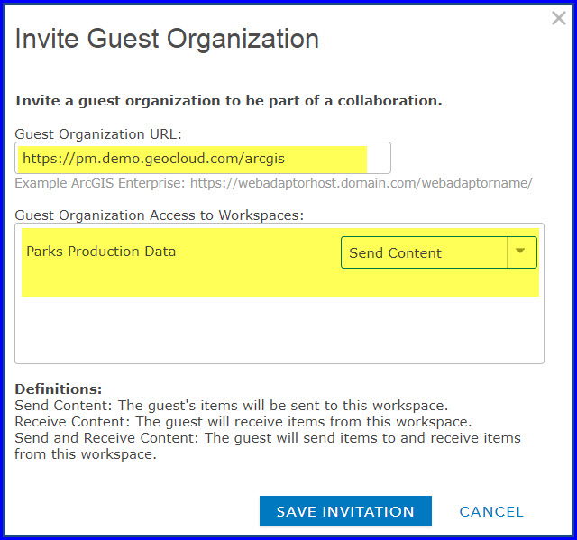

- Invite the guest and establish the workspace access mode of the collaboration. The host must indicate the portal URL of the guest to create an invitation. The host must also define the workspace access mode of the collaboration in the invitation. For this collaboration, the web maps and layers will be sent from the Geocloud Deployment (guest) to the Showcase Organization (host) so the Send Content option should be selected.

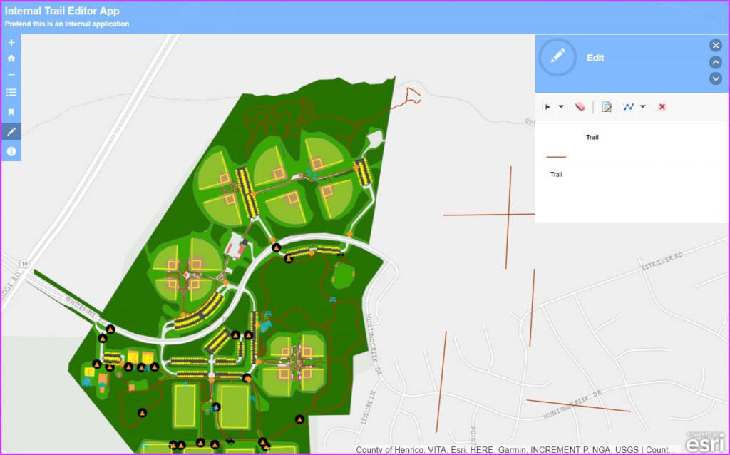

- Internal members of the Geocloud Parks and Recreation department can also access an internal version of the data and edit the data as needed. Once a day, edits to this data will be updated to the Showcase Organization. To demonstrate this, navigate to this editing application (pretend it’s internal) and add a new trail using the editor widget. You can monitor the requests to see that the data is being added to a service hosted in the Geocloud Deployment.
Wait for the synchronization interval to pass and view the edits to the feature layer in the Showcase Organization application. Note: The synchronization interval for the example is set to 1 hour on the hour for display purposes. Add the trail line and look for it in the Online application once the hour passes.

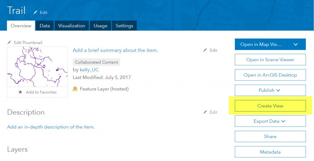

- ArcGIS Online will display on the Data tab of the collaborated data item page when your data was last updated, so you can verify how recently the data was updated.
- You can use ArcGIS Online functionality, like feature layer views and automatic tiles, with the collaborated content.
