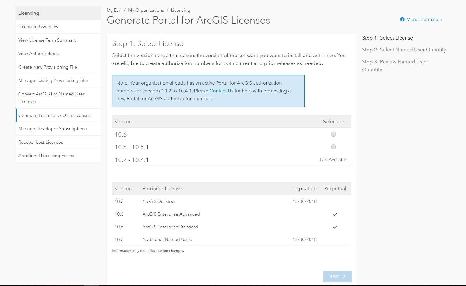

2) Within the Licensing section, you will need to open the Generate Portal for ArcGIS Licenses option and follow through the steps:
  • Step 1: Select license:

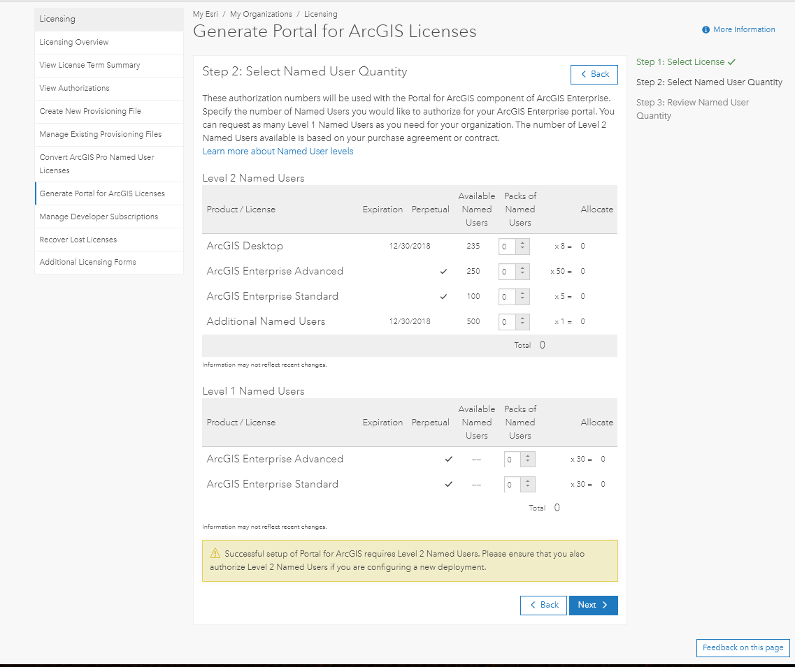

  • Step 2: Select Named User quantity:
  • Step 3: Review Named User quantity:

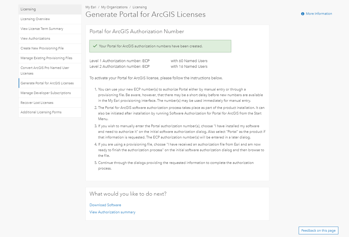

  • Step 4: Use your authorization numbers to activate your Portal for ArcGIS license:
Your new authorization file will contain all the named user licenses (Level 1 and Level 2) that you would like to add to your portal.
Once you have created a new authorization file, you are ready to reauthorize Portal for ArcGIS. Note the last steps in the ‘generate licenses’ process in My Esri for additional information on how to use the EPC number(s) or create a provisioning file. To reauthorize your portal, launch the Software Authorization Wizard – be sure you launch the one for Portal for ArcGIS, not ArcGIS Server. The steps to reauthorize are the same as when you initially authorized the Portal for ArcGIS software component. The help topic Authorizing Portal for ArcGIS walks you through the steps required for portal authorization.
