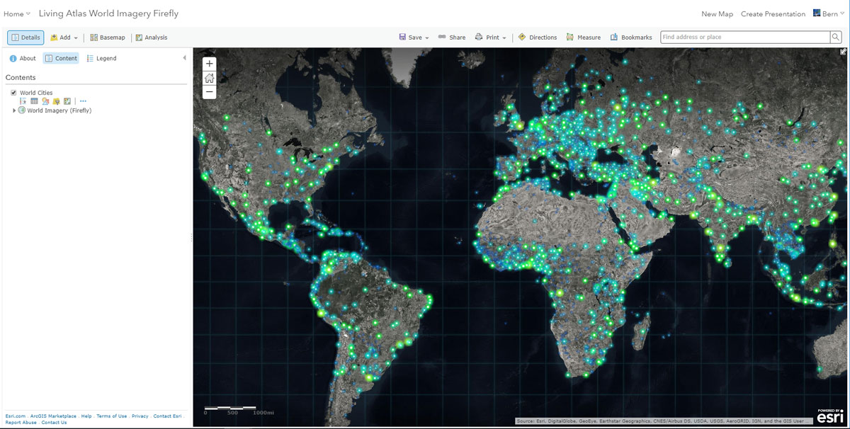

Below, Firefly is used as a basemap for world cities, symbolized by population using bright, neon “firefly” symbols.

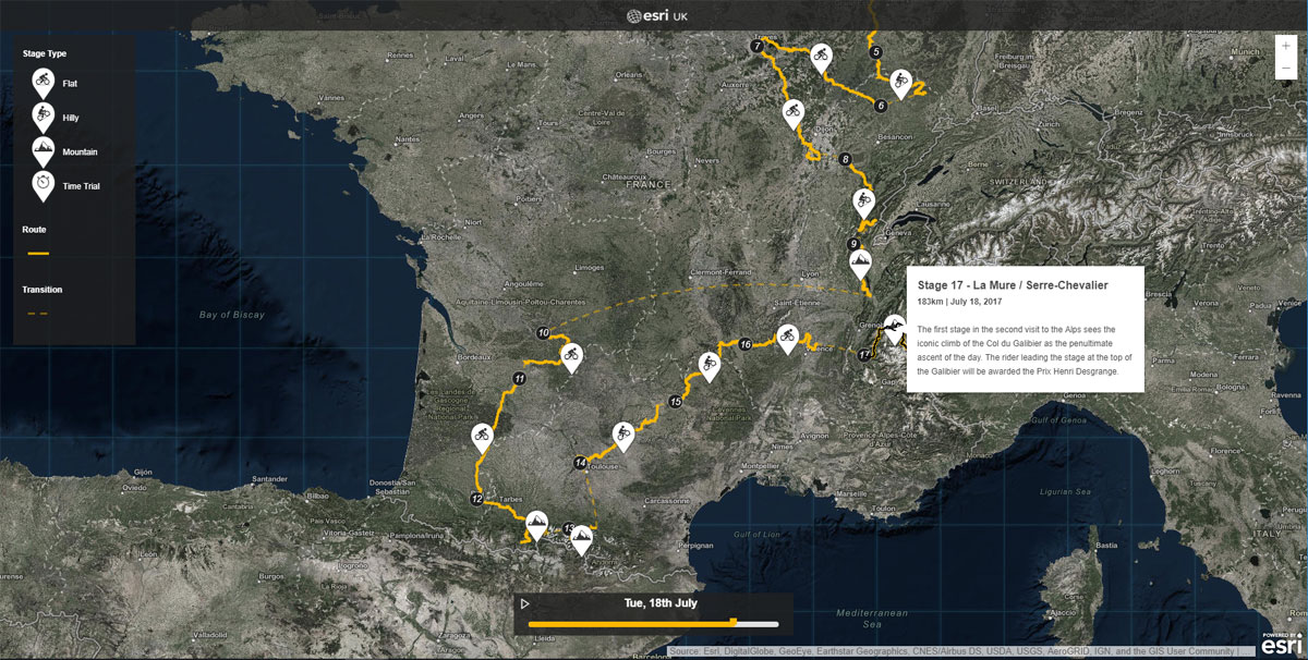

Here Firefly is used to show the 2017 Tour de France route. The imagery is slightly more saturated at this scale than shown above, but still does not compete with the layers.

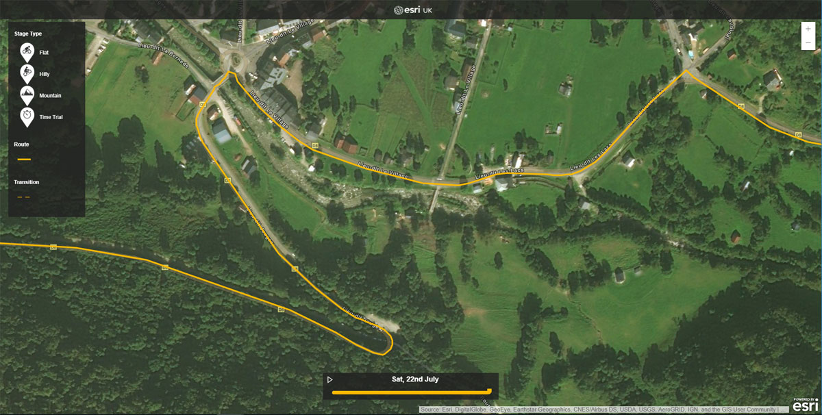

As you zoom in, the colors become more saturated until the full color imagery is revealed.

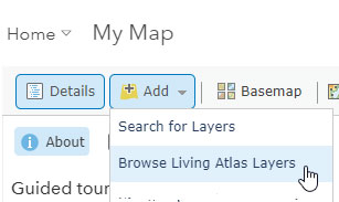

Step 1. Using the Map Viewer, click Add, then Browse Living Atlas layers.

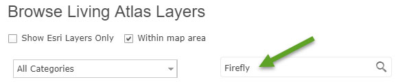

Step 2. Search for Firefly
