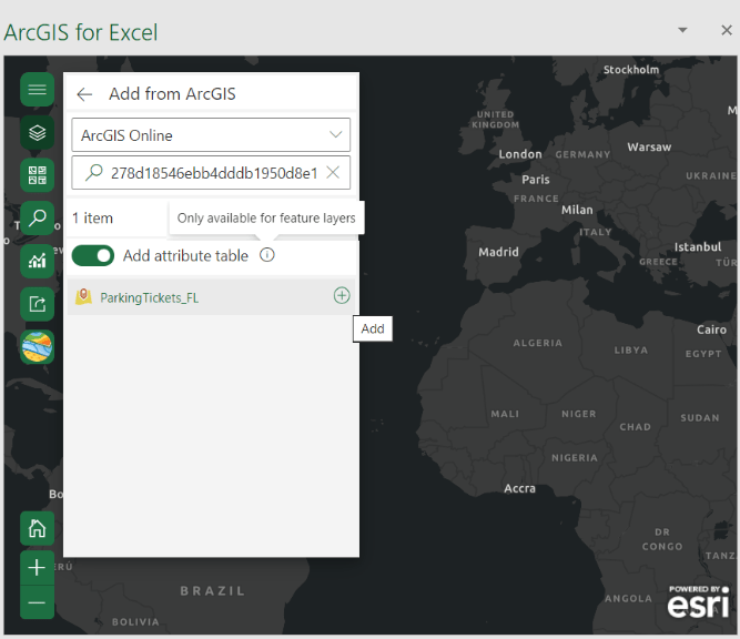

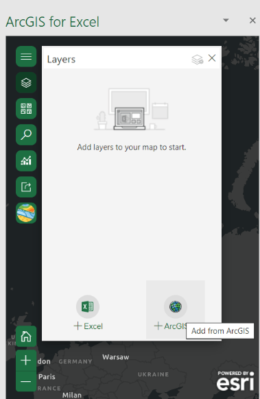

Sign-In to ArcGIS for Excel, open Layers and select ‘Add from ArcGIS’.

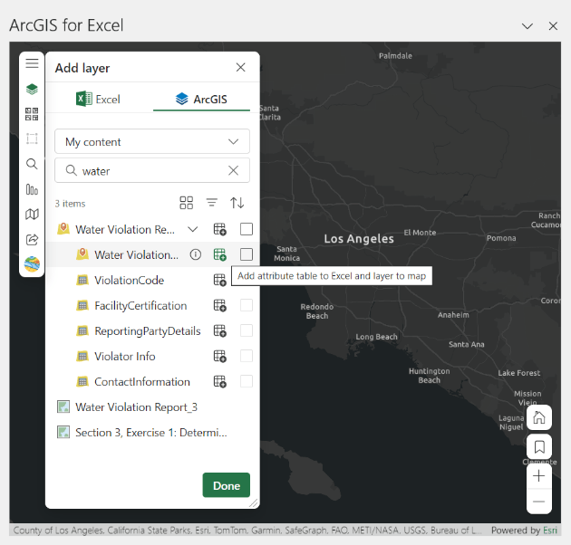

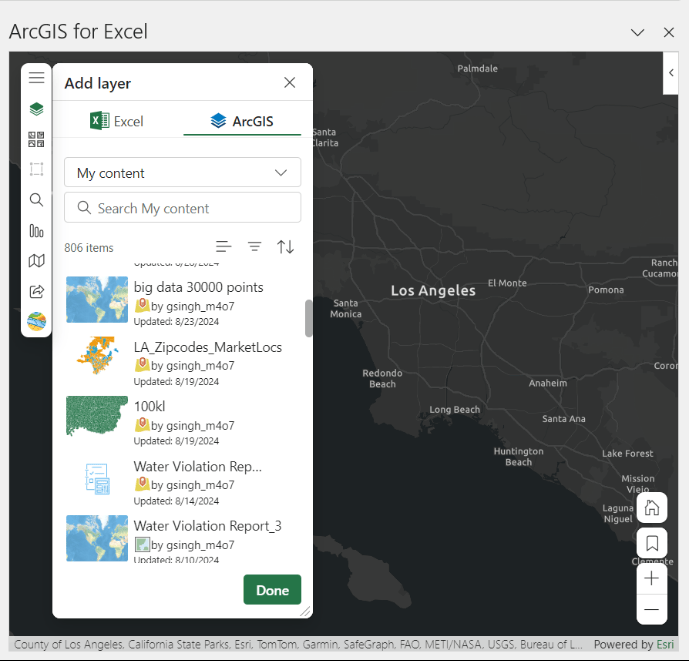

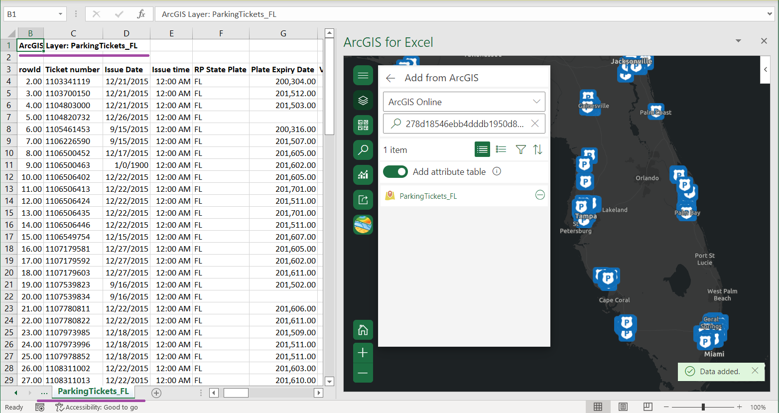

After selecting ‘add the attribute data to Excel and layer to map’ button, the attribute data from your ArcGIS layer will be added instantly into a new Excel worksheet, and the ArcGIS layer also added to the ArcGIS for Excel map. Use the search box to search for an ArcGIS layer by its name or layer ID.
In some cases, you may have selected a feature service that contains multiple feature layers. In this case, you can select which feature layers attribute table or tables you want to add to a worksheet. Each attribute table will be added to a new worksheet within the workbook.
With the ArcGIS layer attribute data in an Excel worksheet, any edits made on the ArcGIS layer attribute data will be synchronized and reflected in the hosted layer on ArcGIS Online or Enterprise. With editing permissions, you can:
