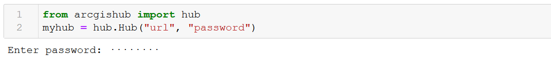

Before you get started, you will need to install the library. Read through the steps to install. You start by signing into your Hub/Enterprise organization:
login

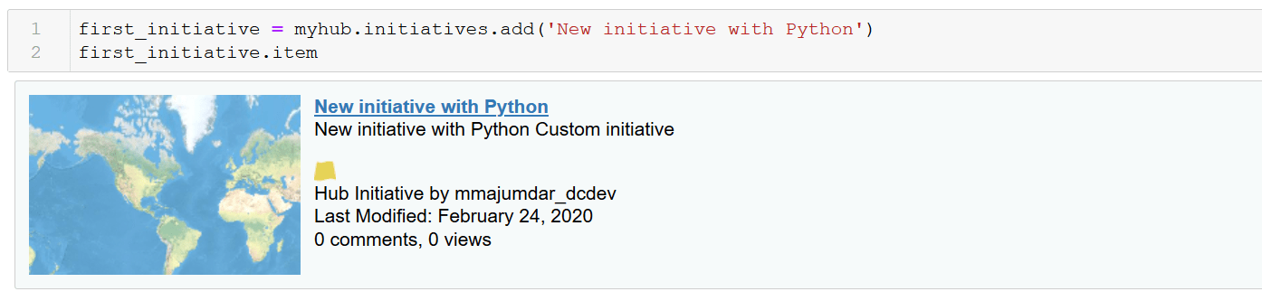

If your organization has licensed ArcGIS Hub Premium, you have access to the premium feature of Initiatives. We will start by creating an initiative and accessing the site created along with it.
new_initiative

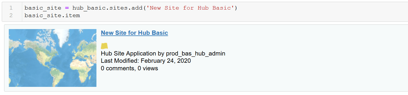

However, if you are using Hub Basic or ArcGIS Enterprise, you can connect to an instance of Hub in the same way, and create a site as shown below:
basic_site

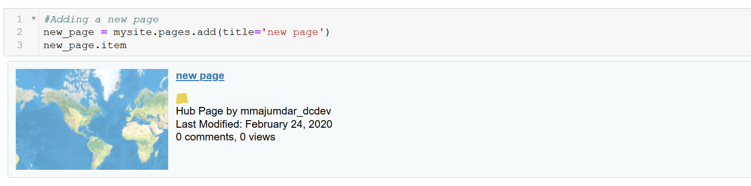

To add a new page to your existing site:
new_page

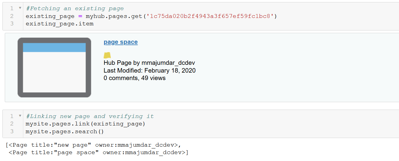

Hub’s Python API allows you to link existing pages to your site, with an optional new slug specific to the site.
link_page

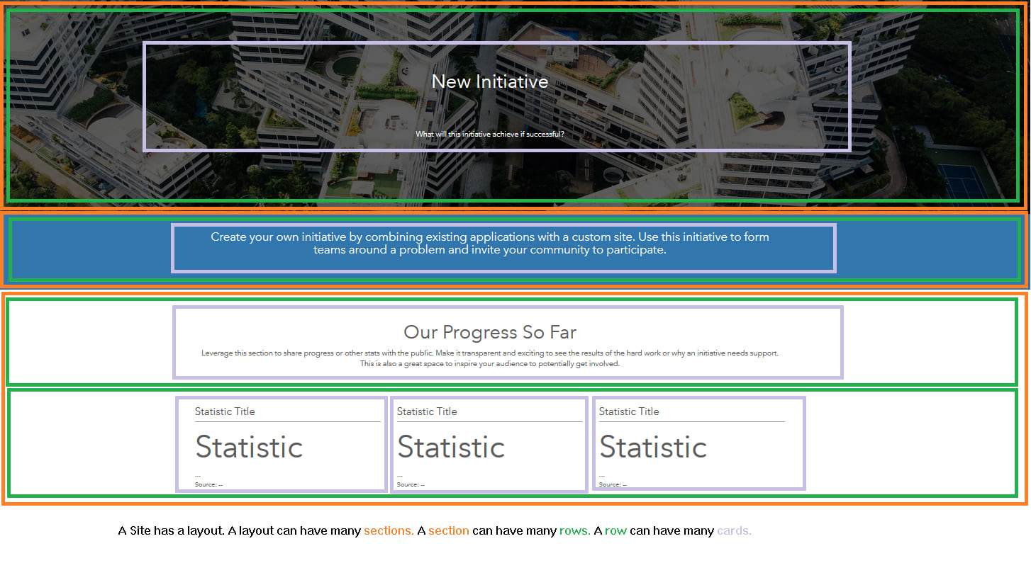

In order to programmatically edit a site, we need to take a deeper dive into the data model of a Site/Page item. The site layout has Sections which contain Rows within, and the row contain Cards within.
Sections have configurable attributes such as background color and font-color and are used to theme a site or page. Rows are the building blocks of your site are implicitly created when you add a card to a section below another card. Whenever you want to add a card, such as a text card or image card, you must have a row card positioned where you want to add the content. Multiple cards can fit in a row card.
site_layout

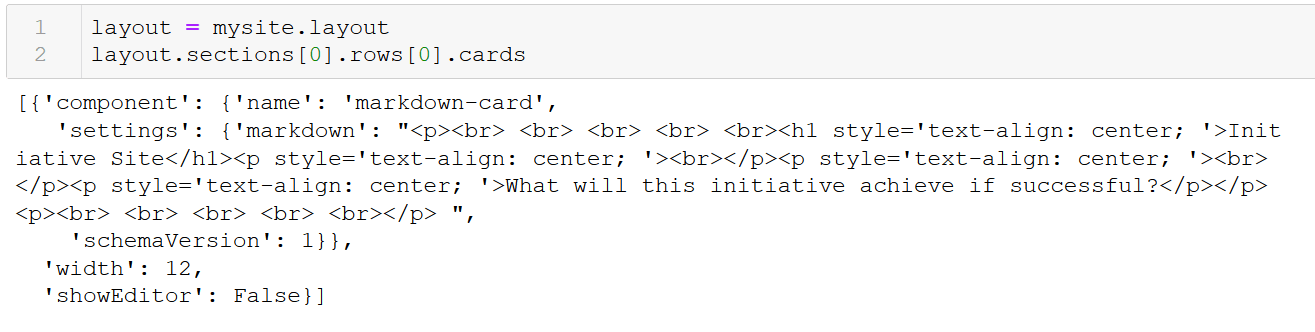

We will now see how these components of a site can be accessed using our Python API.
site_layout_access
As we see in the image above, a section could have many rows, and a row could have one or many cards (as seen in the second row with 3 statistics cards).

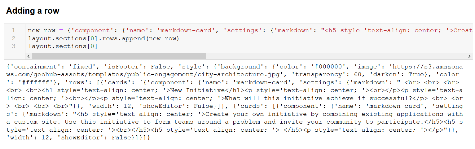

To add a new section, row or card to the existing layout, you use the append list method of Python, with the dictionary for the new section, row or card to be added.
add_row

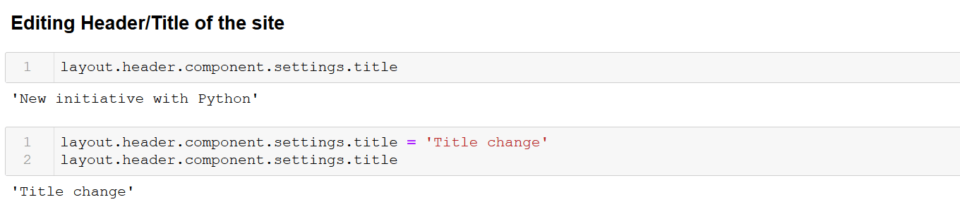

For editing a particular element of the site layout, you access the particular element and make changes to the layout object as shown below
edit_header

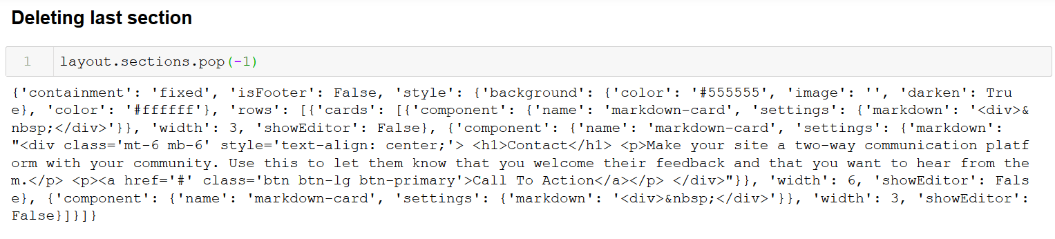

To delete a new section, row or card from the existing layout, you use the `pop` list method of Python, with the index for the section, row or card to be deleted.
delete_section

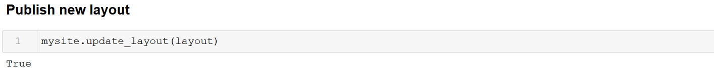

However, to overwrite these changes to the site item and modify the site layout, you can use the update_layout method on the site object with the modified layout.
publish_layout

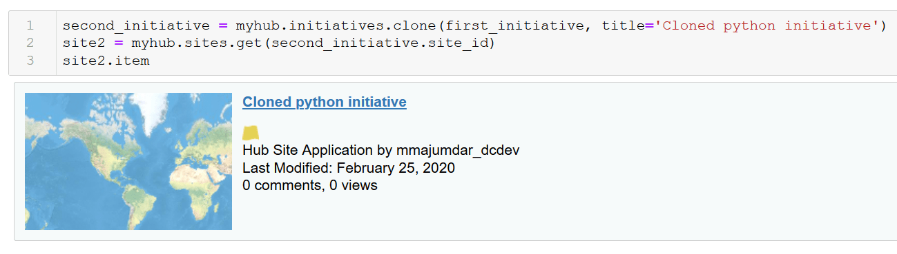

Based on your ArcGIS Hub license, you can clone the initiative or site. For a Hub Premium organization, you can clone the initiative and access its site as follows:
initiative_clone

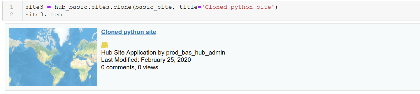

And cloning a site for Hub Basic or Enterprise organizations can be achieved using:
site_clone

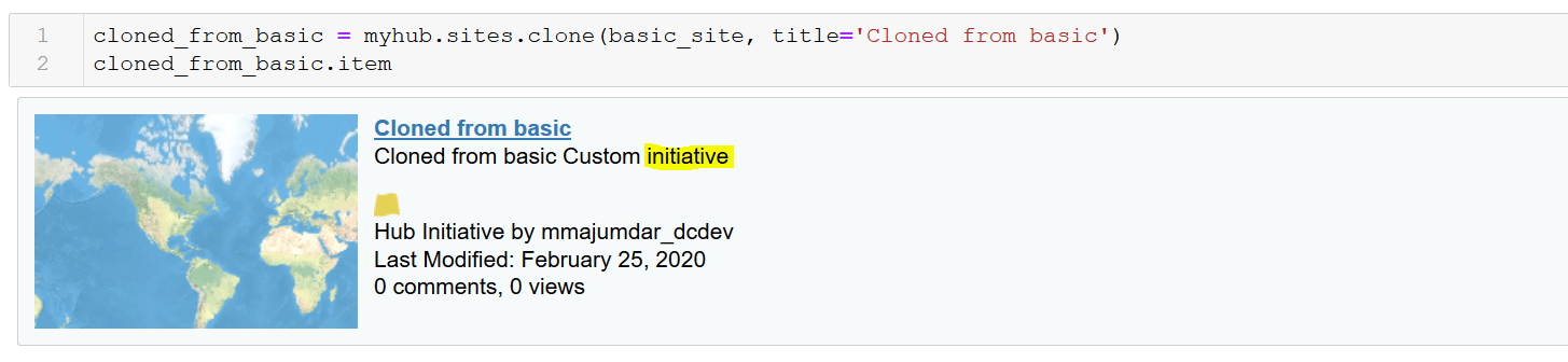

Using Hub’s Python API, you can also clone a site from one organization to another, provided it is a public site or you have access to the site from the other organization.
We will see an example of cloning the site we created previously in a Hub Basic organization to a Hub Premium organization. Notice that it creates the initiative for the site as well, per the added features of the organization.
cloned_from_basic
