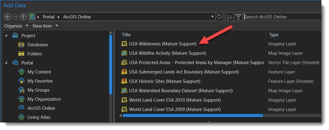

  1. Put “Mature Support” in the title. Mature Support means the item will remain available for “the following time frame” and then after the time frame expires, the layer will be unshared and turned off, unable to be accessed any longer. Adding the Mature Support language into the title will ensure that someone adding your map through Pro or the ArcGIS Online map viewer will see that the item is outdated, and a newer, more accurate layer exists.
Mature Support
Add Mature Support to Title.

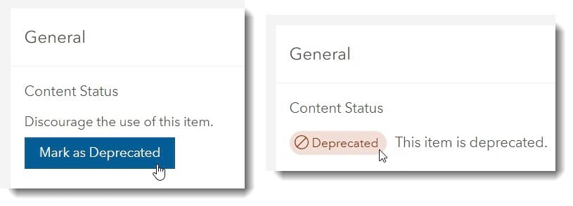

3. Mark as Deprecated on the Settings tab. Deprecated means this layer will be removed in a future release and is no longer recommended for use.
Mark as Deprecated
Mark as Deprecated.

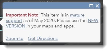

4. Add a statement in the pop-up indicating the deprecated status and linking users to the newer layer. By adding this statement to the pop-up, users who have included your layer in their webmap will see that there is a newer layer available when they interact with their webmap. Then, they can swap out the old layer for the new layer.

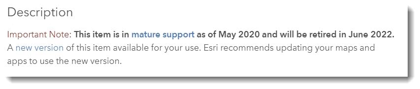

5. Use the same statement from your pop-up in the first sentence of your item description and terms of use. So, anyone accessing your layer from the content item page will see that the item will be taken down at a future date, and there is a replacement which should be used instead.
Important note
Important note to include in the Description.
