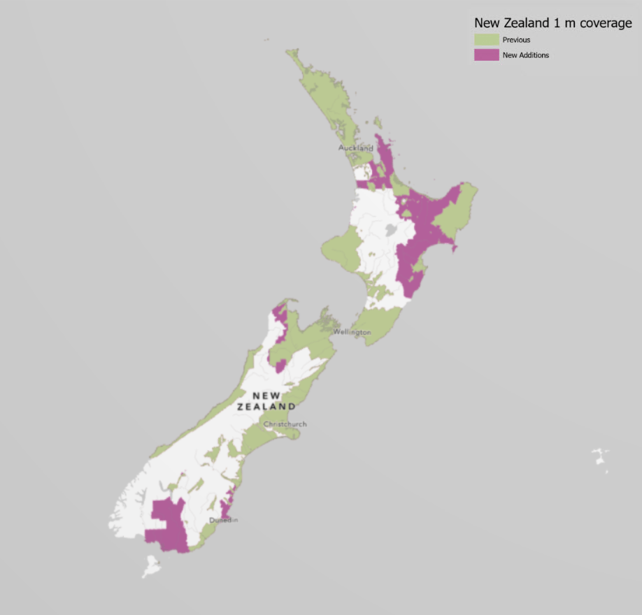

  • Land Information New Zealand’s LiDAR derived 1 meter DTM’s covering partial areas of New Zealand. In this release, ~44,570 sq kms (~ 17208 sq miles) of new data has been added bringing total coverage to ~144,870 sq kms (~ 17208 sq miles) (see map below).
New Zealand 1m coverage as of October 2023

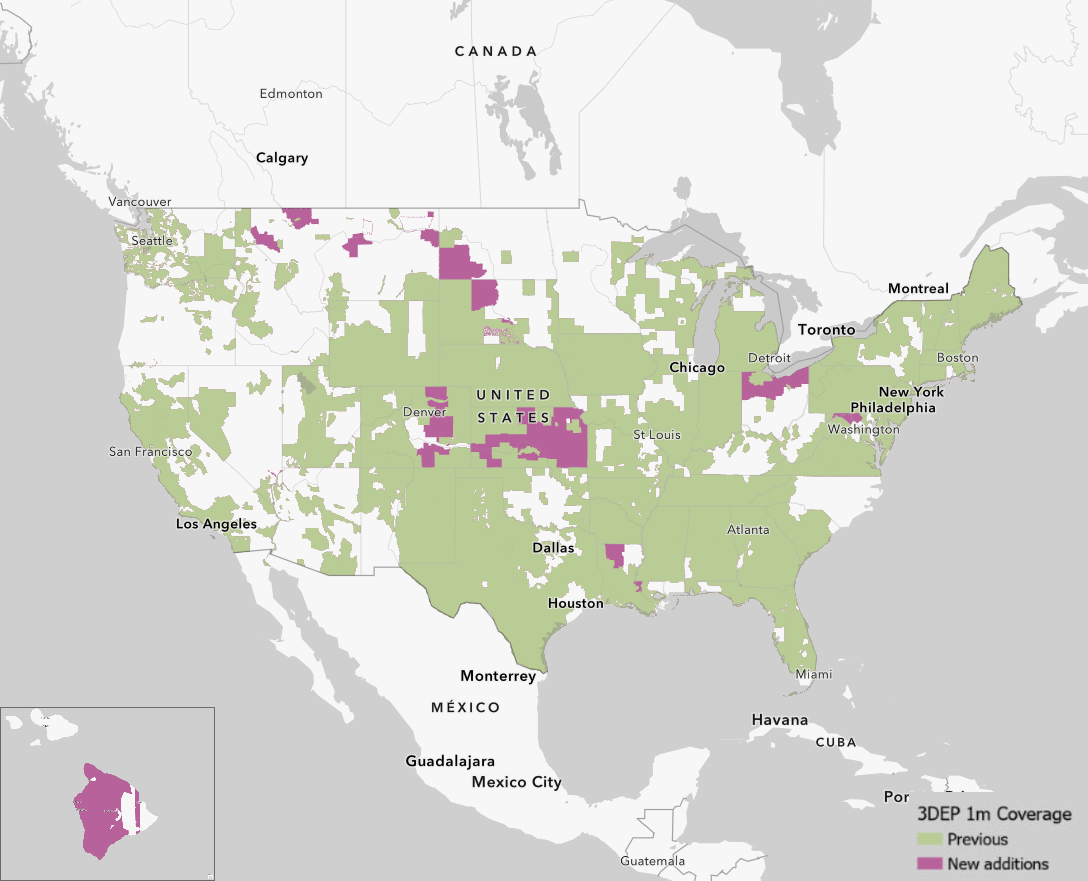

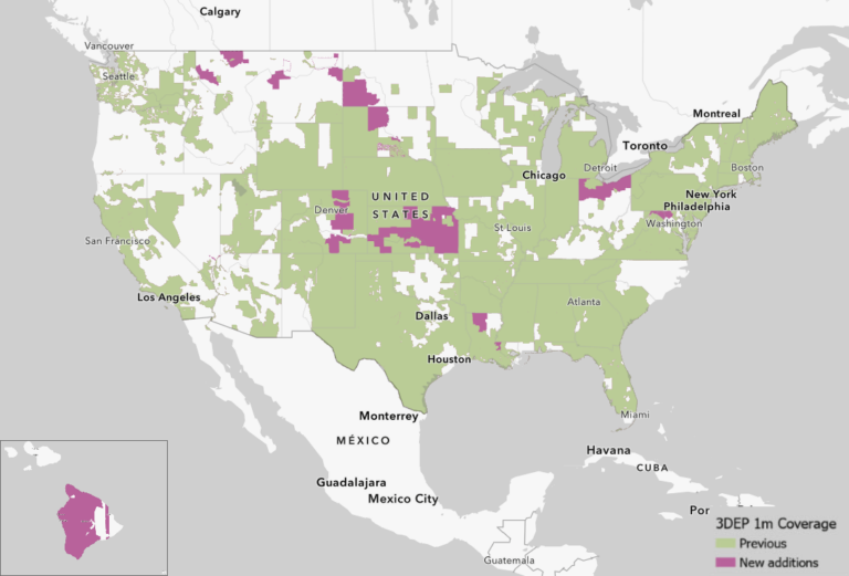

  • USGS’s 3DEP 1 meter lidar derived DTM’s covering areas of the conterminous United States and Island of Hawaii. In this release, approximately 307,860 sq kms (~ 118,865 sq miles) of new coverage has been added. The graphic below shows the new addition (magenta) along with previously available coverage (green).
USGS 3DEP1m coverage as of October 2023

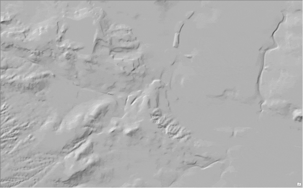

Lyon, France – hilly urban areas depicted with lidar derived 1-meter DTM’s in comparison to 24 meters WorldDEM4Ortho

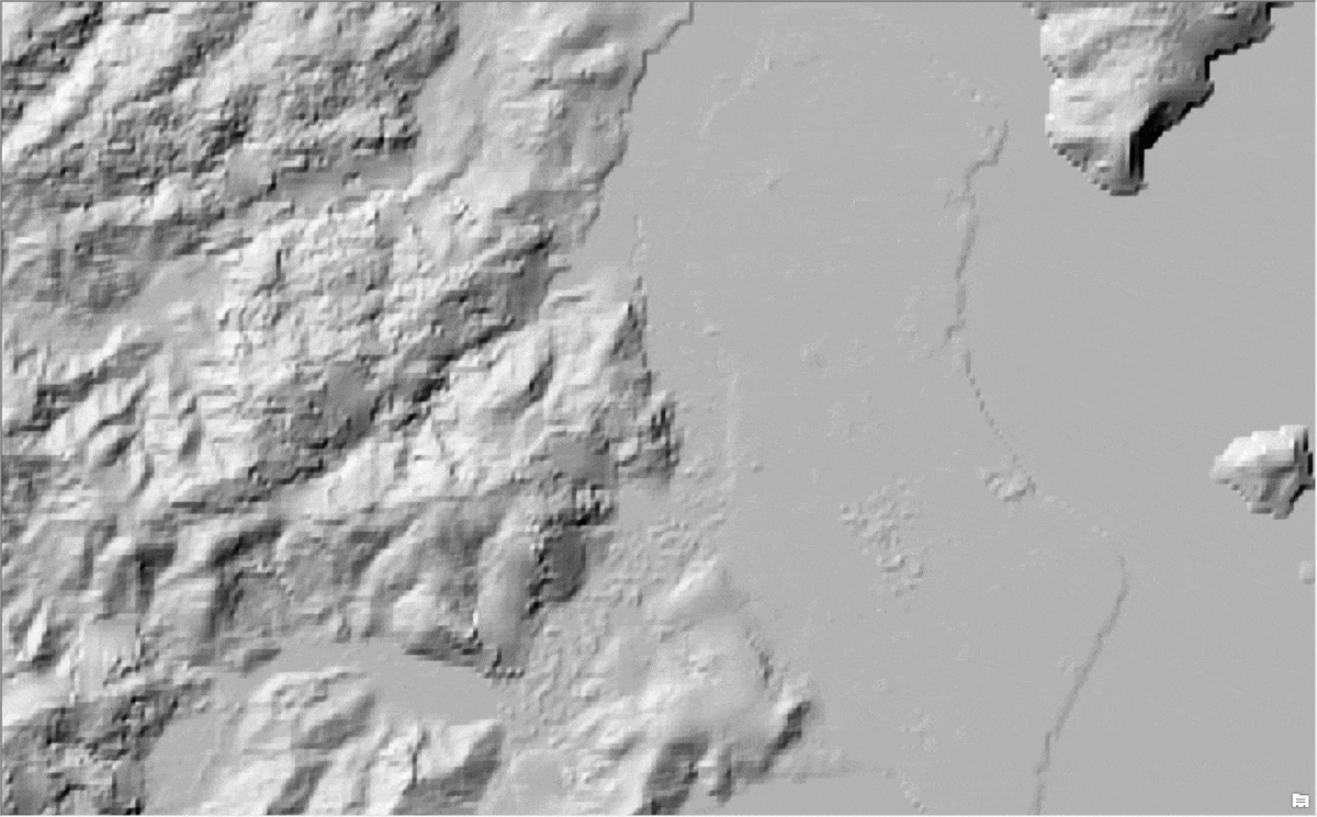

Saint-Laurent-du-Var, France – a suburb of the city of Nice depicted with lidar derived 1-meter DTM’s in comparison to 24 meters WorldDEM4Ortho

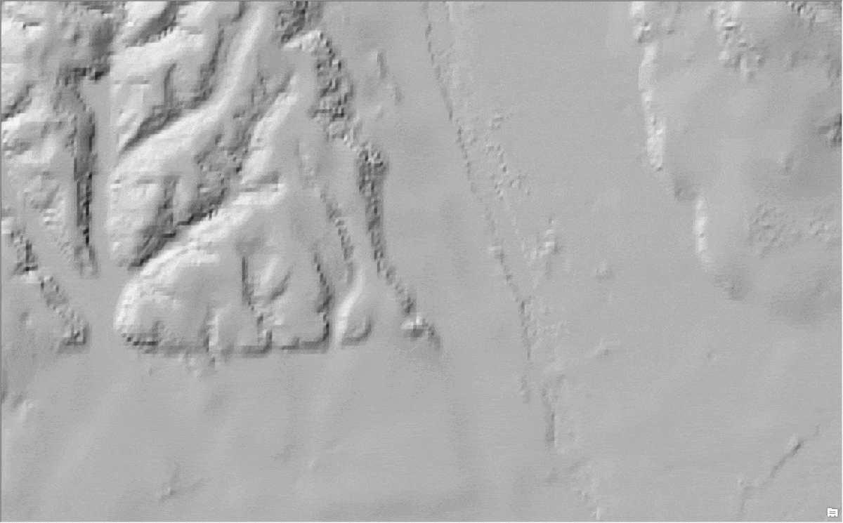

Whangamatā, New Zealand – improvements depicted with lidar derived 1-meter DTM’s in comparison to 24 meters WorldDEM4Ortho
