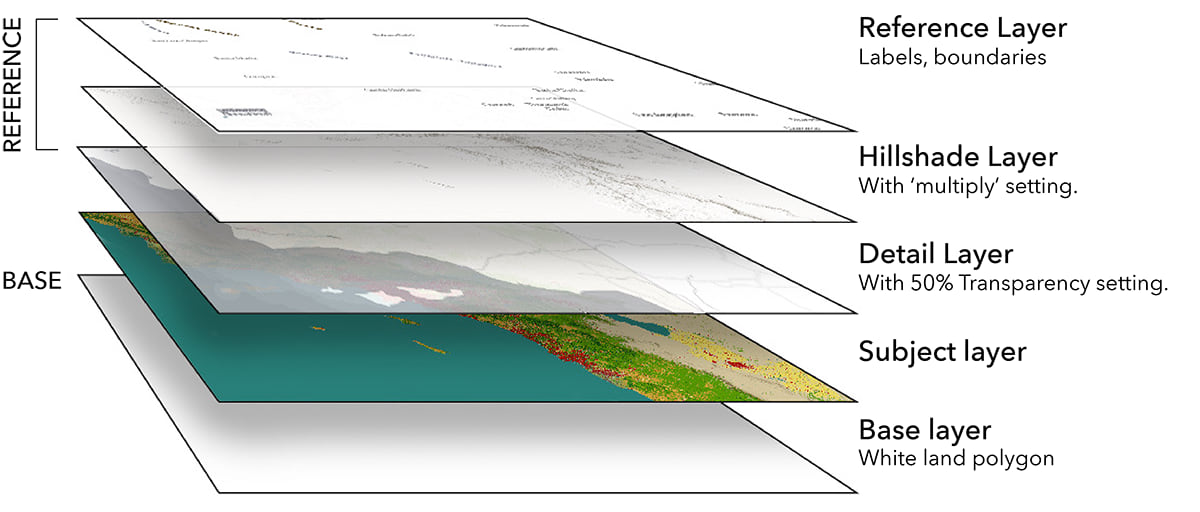

The Light Version
A diagram showing the 3-layer construction of the Physical Geography basemap, and how it interacts with other layers
The Base layer includes a land polygon in white. It is there to establish a foundation for the basemap, but it can also be used as a mask if you want to exclude any information from the land.
Use it with…
Anything you like! But the Physical Geography Basemap is designed to work well with the hillshade layers in the Living Atlas (vector and raster).
For the moment, the web map includes some additional layers.
  • World Hillshade (set as a reference layer above the Detail, with a ‘multiply’ blend setting).
  • As an alternative, the World Hillshade (vector) set as a base layer (it can be a reference layer if you prefer). Although it is not needed in this position, the ‘Multiply’ blend is set, so that it can be combined with…
  • … the World Oceans Base. The base layer acts as a mask for the land. The Grayscale Effect is applied, to bring the layer into keeping with the rest of the map, but it can be used without it. Make sure that you have at least one layer below the Oceans Base to stop it limiting the scale range (I’ve added the ‘Blank White’ basemap). If you are a premium user, the ‘Topobathy’ version is available to you at all scales.
Use any combination of these (or any other layers) to form your basemap.

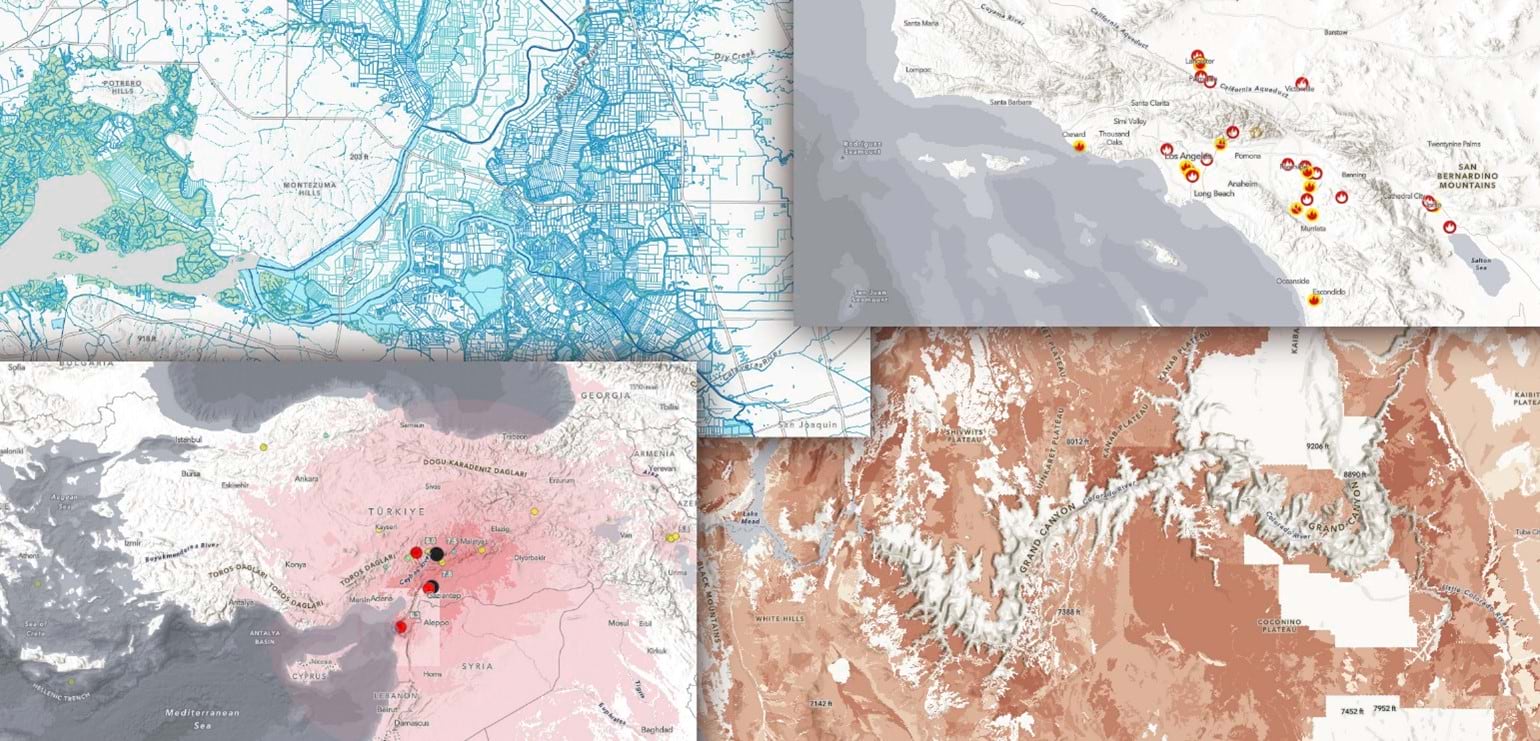

Here are some examples of the basemap in use (The original maps and further details can be found in the ArcGIS Living Atlas).
Samples of the Physical Geography basemap in use
Clockwise from top left: NHD Plus HR map; Current wildfires live feed; Soil erodibility factor; Earthquakes live feed.

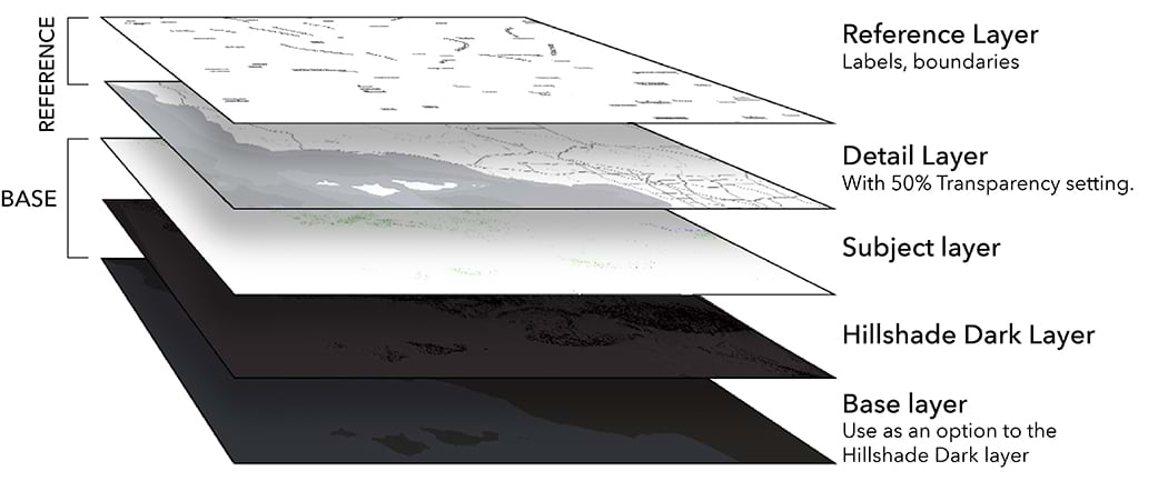

The Dark Version
A diagram showing the 3-layer construction of the Physical Geography Dark basemap, and how it interacts with other layers
The Physical Geography Dark Basemap is is structured slightly differently.
Use it with…
World Hillshade (Dark). ‘Contrast’ and ‘Hue Rotate’ Effects have been added to the hillshade to achieve this look. It works well with this map, but it is tricky to use it as a reference layer (Feel free to try it out though).
The base layer is switched off – Switch it on if you don’t want to use the hillshade.

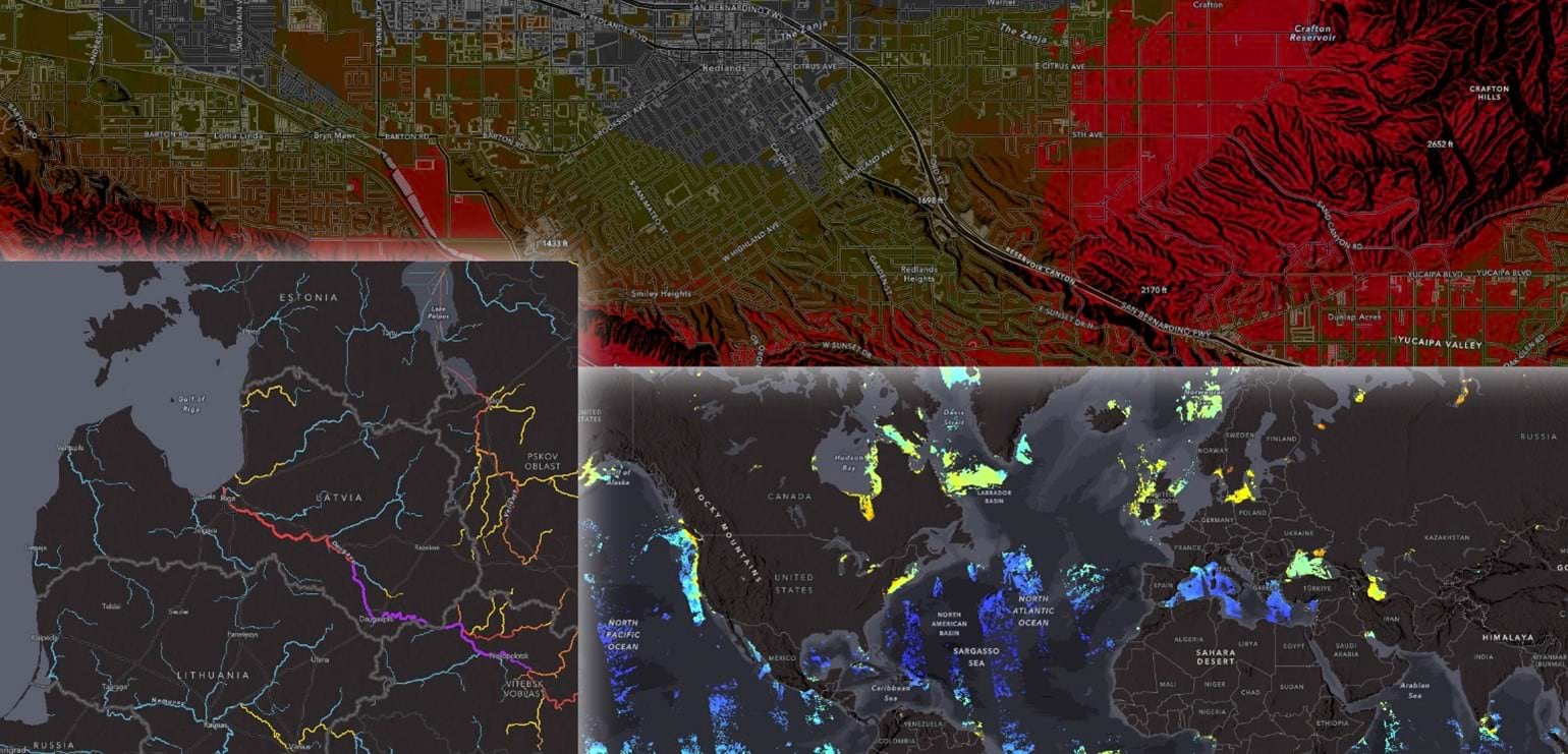

Here are some examples of the basemap in use (The original maps and further details can be found in the ArcGIS Living Atlas):
Samples of the Physical geography Dark basemap in use
Clockwise from top: Wildfire risk to potential structures (with a ‘color’ blend applied); Chlorophyll-a concentration; Forecasted stream flow.
