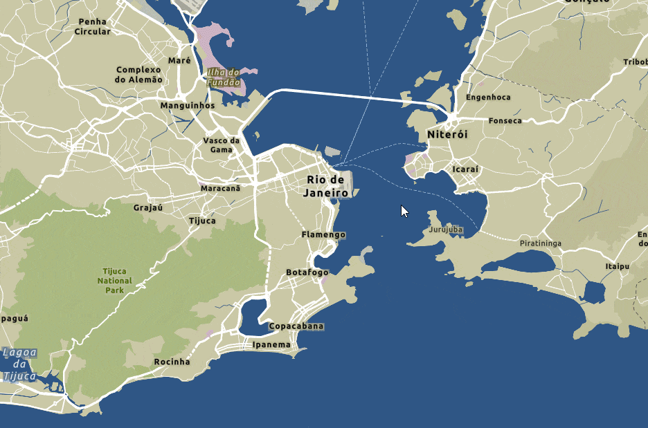

Animation to demonstrate the transition from map to imagery through multiple zoom levels.
I’ve built a map palette that I hope fits in well with the transition. Working with color over Imagery can be a bit of a nightmare as you try to match  an ever-changing imagery palette. Fortunately, at these scales it’s calmed down a bit
The fade-in of Imagery begins around Zoom/Level 13, and transitions completely around Zoom/Level 17. The fades were achieved using the opacity tools in the VTSE on individual layers. Not all of them work over the same scale range though, as I tried to finesse the final look.  Labels and some features (such as tunnel tracks) continue into the Imagery.
