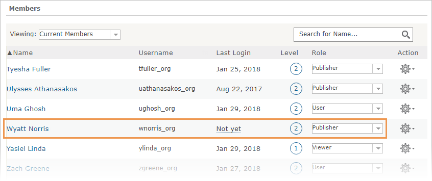

I added Wyatt to our organization as a Level 2 member. I gave him the Publisher role so he could share hosted web layers.
List of current members of an ArcGIS Online organization
You must be a Level 2 member of the organization to get an ArcGIS Pro Named User license.

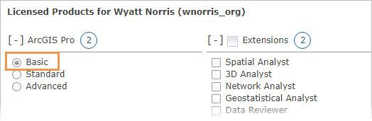

On our organization’s Manage Licenses page, I assigned him an ArcGIS Pro Basic license. I didn’t give him any extension licenses because we don’t have many to spare.
ArcGIS Pro license level and licensed extension check boxes for selected user
As the ArcGIS Online administrator, I assign licenses for ArcGIS Pro and other apps.

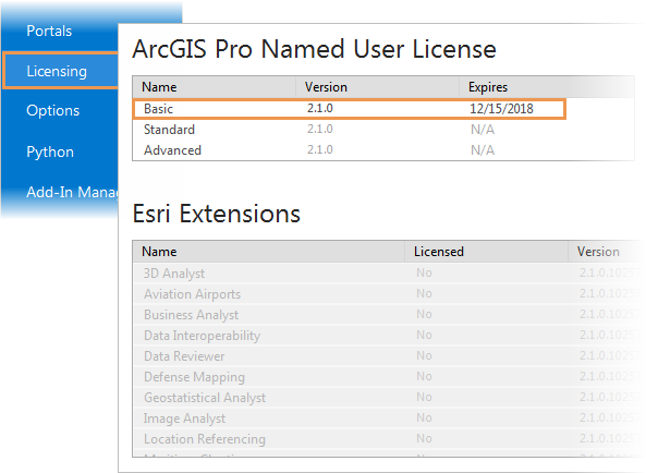

Burros, I thought. The marauders of Reche Canyon. I told him that his Basic license level didn’t give him access to certain tools. I also showed him how to view his license information in ArcGIS Pro. From an open project, he clicked the Project tab on the ribbon and then clicked Licensing in the list of side tabs.
License information on the ArcGIS Pro Licensing page
Wyatt has a Basic license—its values are not dimmed. He isn’t licensed for any extensions.
Wyatt asked me to change his license level to Advanced and give him the Spatial Analyst and 3D Analyst extensions. I told him to send me a written request with a business justification. New guy.

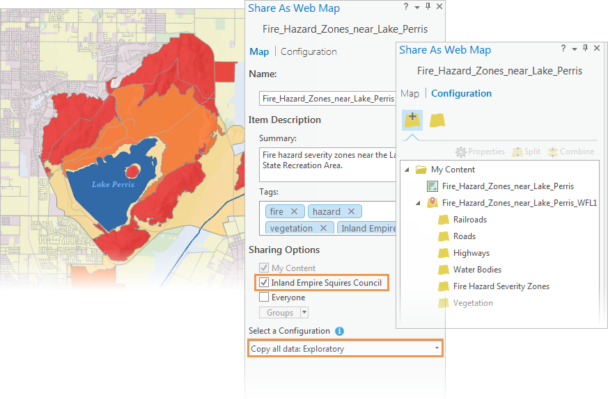

Most of the layers in his map were based on geodatabase feature classes. As a publisher in our organization, Wyatt could share these layers as a web feature layer when he shared the map.
Map configured for sharing
On the Share As Web Map pane, Wyatt configures his map layers as a web feature layer (WFL). Web map users can query and interact with a web feature layer.

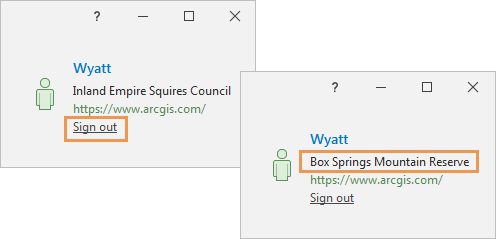

He’d figured out how to sign out of our portal and sign in to his new portal in the upper right corner of the ArcGIS Pro window.
ArcGIS Pro sign-in status
Wyatt signs out of his company’s ArcGIS Online portal and signs in to his trial organization portal.
When he restarted ArcGIS Pro and checked the Licensing page, he had an Advanced license and a bunch of extensions.

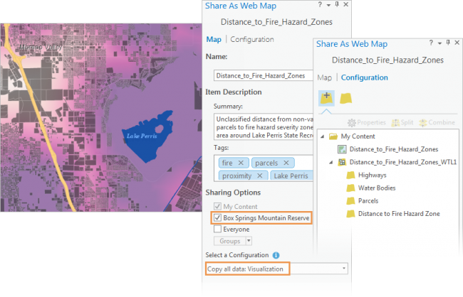

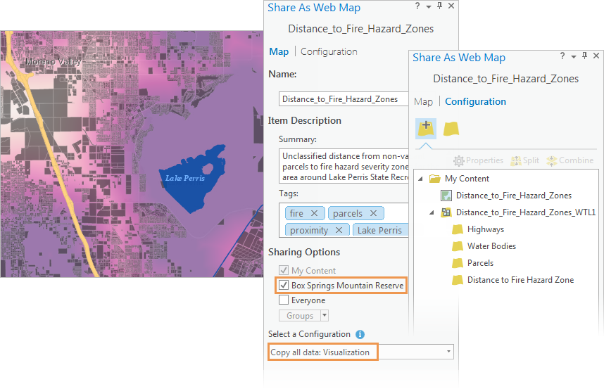

Wyatt also had the Publisher role in his trial organization. His Distance to Fire Hazard Zones layer, based on a raster dataset, had to be shared as a web tile layer. The other layers could have been shared as a web feature layer, but Wyatt decided to share them all as a tile layer.
Wyatt configures the map layers as a web tile layer (WTL). The layers can be viewed on the web but not queried.
Wyatt shared this map to his trial organization, the Box Springs Mountain Reserve.

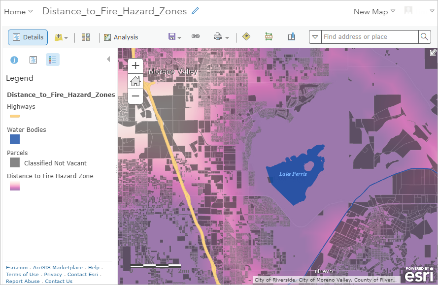

Web map in ArcGIS Online
Wyatt could have published the map once and shared it publicly. Instead, he chose to publish it separately to his two ArcGIS Online organizations.
