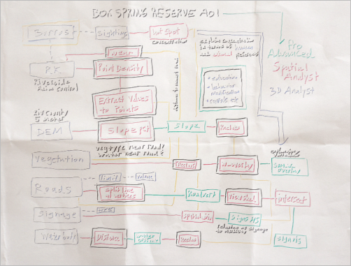

“It’s not my call. It’s up to our treasurer.” He took a piece of paper from his back pocket, unfolded it, and handed it to me. “Here’s that justification you wanted me to write for an Advanced license,” he said.
I’d been expecting an email with a few bullet points. Instead, I got a weird schematic drawing.
Hand-drawn analysis workflow
Wyatt’s sketch for a risk analysis of motor vehicle collisions with burros on Box Springs Mountain.
It was an analysis model. I couldn’t follow it very well—I haven’t done any hands-on GIS in years—but it seemed plausible. Something about donkeys crossing the road and visibility and whatnot. I guess Wyatt really did need all those specialized tools. “Okay,” I said. “I’ll change your license settings.”

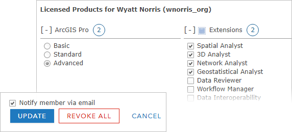

I selected Ulysses and revoked his extensions. That freed up four analysis extension licenses. Then I selected Wyatt. I changed his ArcGIS Pro license from Basic to Advanced and assigned him four extensions. I clicked Update.
ArcGIS Pro license settings for an ArcGIS Online member
When I update the license, Wyatt gets an email notifying him that his account has been modified.

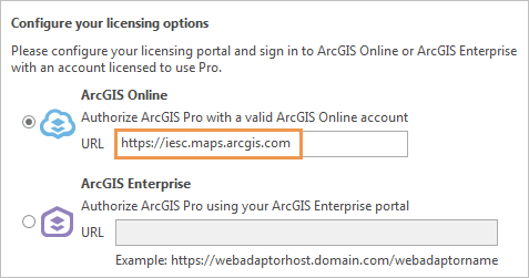

He clicked Configure your licensing options. In the Licensing dialog box, under ArcGIS Online, he replaced https://www.arcgis.com with our organization’s URL.
The new URL in the Licensing dialog box.
After the licensing portal is changed, ArcGIS Pro needs to be restarted.

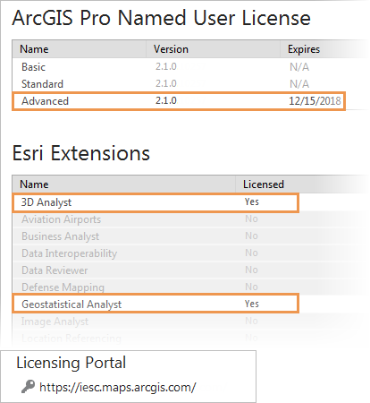

After restarting ArcGISPro and signing in, he went back to the Licensing page. He had an Advanced license and the four extensions I’d given him. His licensing portal was set to https://iesc.maps.arcgis.com.
Licensing page in ArcGIS Pro
Wyatt’s new license configuration.

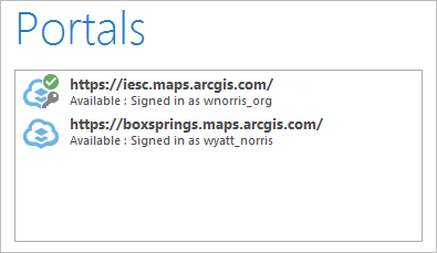

On the Portals page, his licensing and active portal were now both set to our organization. He could have kept using https://www.arcgis.com as the portal for his trial account, but he decided to replace it with the organization’s URL. He added that portal and signed in to it. He selected and removed the arcgis.com portal.
Portals connections after updates
Wyatt’s licensing and active portal are set to the Inland Empire Squires Council. A connection is available to the Box Springs Mountain Reserve.

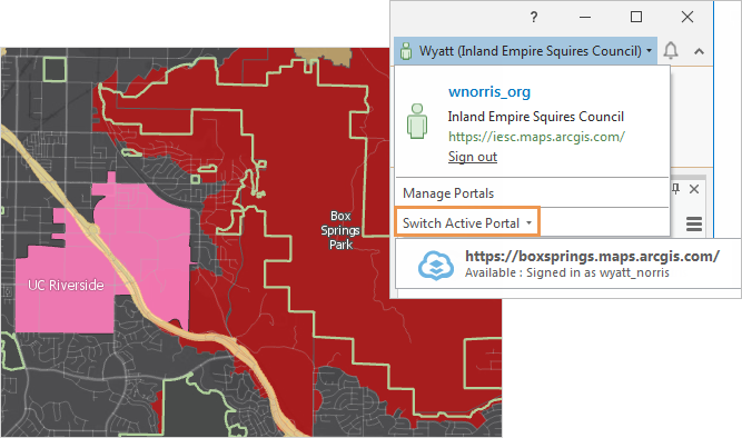

He continued to make maps for both organizations, changing his active portal as needed. He discovered that he could do this easily by clicking his sign-in status in the upper right corner of the ArcGIS Pro window and clicking Switch Active Portal.
Sign-in status with a map in the background
Wyatt switches his active portal from the sign-in status drop-down menu.
