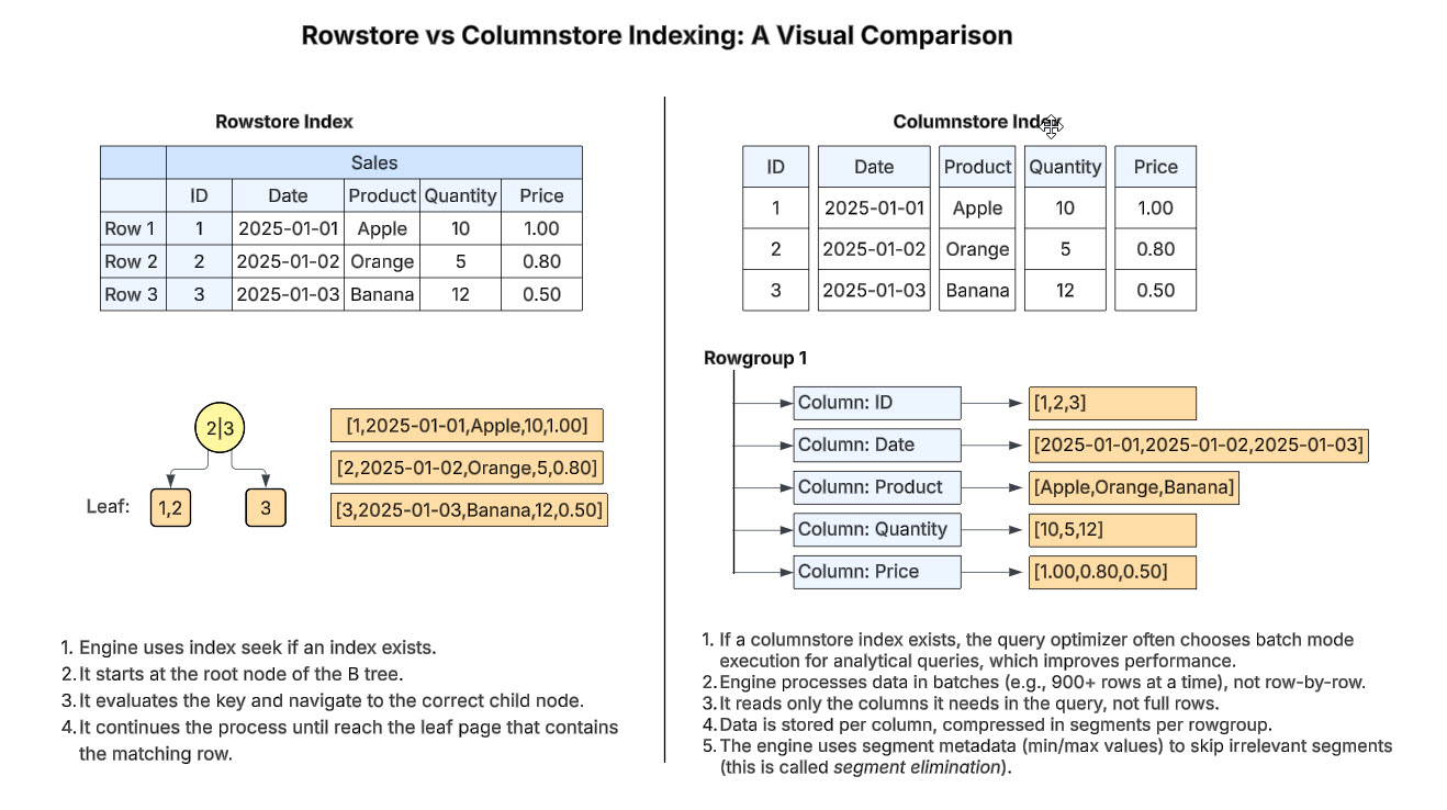

Rowstore vs Columnstore Indexing: A Visual Comparison
A Simple Analogy: Finding the Price of an Apple
Imagine you walk into a library where data is stored in books. You want to find the price of an apple.
  • In a rowstore index, each book contains full rows: Apple, 2025-01-01, 10 units, $1.00, etc. To find the price, you need to read every row, even if you only care about one column.
  • In a columnstore index, data is neatly organized by column. There’s a whole shelf just for “Price”, another for “Product”, and so on. To find the price of an apple, you just:
    1. Go to the “Product” shelf and find all rows labeled “Apple”.
    2. Then check the “Price” shelf at the same position.
This makes columnstore faster and more efficient for analytical queries because:
  • It reads only the columns you need.
  • It skips irrelevant chunks of data using min/max values.
  • It works in batches, not one row at a time.

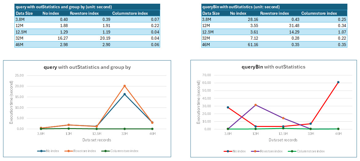

The charts below illustrate the significant impact of indexing on performance in large-scale operations. We compared queryand queryBin operations across datasets ranging from 3.8 million to 46 million records, using three configurations: no index, rowstore index, and columnstore index.
The difference is striking. For both operations, the columnstore index consistently delivers the fastest execution times, even as data volumes grow. In contrast, rowstore indexing and no indexing result in noticeably slower response times, especially evident in the queryBin results, where no indexing performance declines sharply with larger datasets.
These results confirm that columnstore indexes are a powerful optimization for analytics workloads, dramatically reducing execution times in operations that involve grouping, binning, and summarizing on massive datasets.

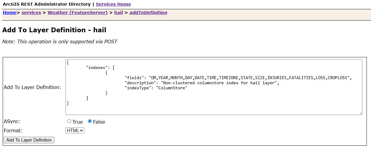

Adding a Columnstore Index Using the REST Admin API
You can add only one columnstore index per layer.  Use the Add To Definition (addToDefinition) operation via the layer’s REST Admin API. Here is the syntax of the JSON payload you will need:
      "indexes": [
          "name": "<index name>",
          "fields": "<field1,field2,field3,...>",
          "description": "Description of the index",
          "indexType": "ColumnStore"

An example of adding a non-clustered columnstore index
