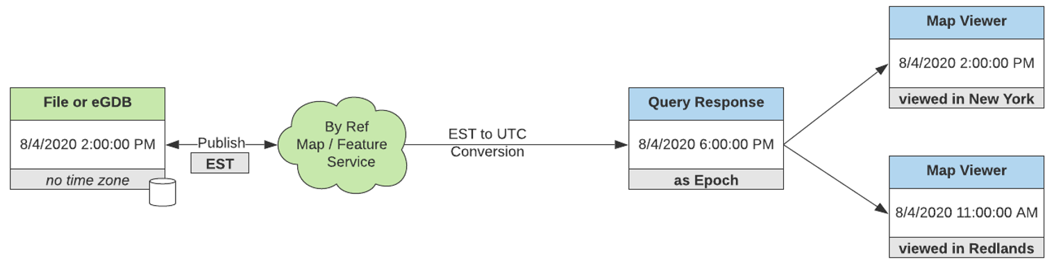

If you ever shared layers containing date/time attributes as map or feature services, you for sure know that date/time values are always passed around in UTC epoch values. This is per ArcGIS REST API specifications. In order to make sure date/time values are processed correctly, it is required that you set a time zone for your service while authoring. This time zone gets applied to all date attributes for all layers in this service.
How date/time values are passed around and displayed on web clients.
The problem:
This can be a big limitation if you have use cases where data comes from multiple time zones such as traffic incidents, summer meal programs, etc. that require date/time values be stored and displayed in their respective time zones instead of your device time zone.
In addition, the dependencies on two different time zone conversion libraries by ArcGIS enterprise services and JavaScript made date/time values show up incorrectly on web maps in some instances especially with historic dataset.

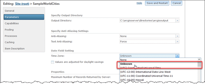

To set a service time zone to Unknown, here is what you need to do:
  • After publishing a map or feature service in your enterprise portal (or standalone server), go to the server Manager site. Find your service and click the pencil icon to edit the service.
  • Switch to the Parameters tab, select Unknown from the Time Zone drop down.
  • Click Save and Restart.
