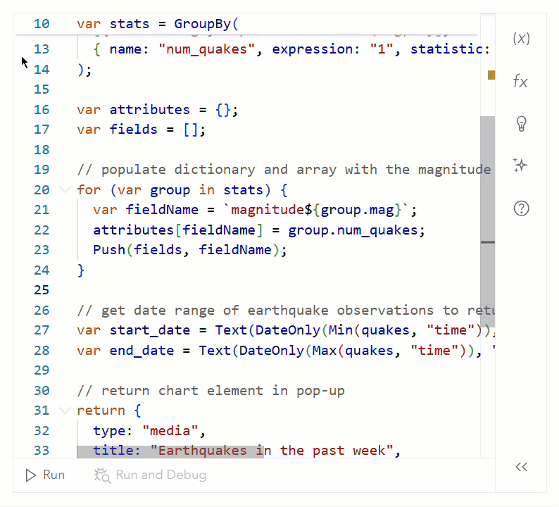

So now that we know what a debugger is, I’m sure the next question you’re asking is: how do I use it? When you open the Arcade editor in Map Viewer (or elsewhere in ArcGIS Online) you will now see a Run and Debug button on the bottom action bar. The button is how you open the debugger, but it will be disabled until you have placed at least one breakpoint within your script.
Setting breakpoints
Breakpoints indicate where in the script to pause so you can determine the current state of variables and other script elements. You cannot access the debugger without at least one breakpoint present.
Three breakpoints are added to a script before opening the debug experience.
Breakpoints can be added to the script by clicking to the left of the line number. Once the script has one breakpoint, the Run and Debug button will become enabled.
Script breakpoints are indicated by a red circle and can be set on specific lines of code by clicking to the left of the corresponding line number. To remove an existing breakpoint, simply click on it again. The placement of your breakpoint(s) also matters, so be intentional. For example, a breakpoint set on an empty line or a line with a comment will be ignored by the debugger. Likewise, if you set a breakpoint in a loop, it will pause there on every iteration until the loop is completed.

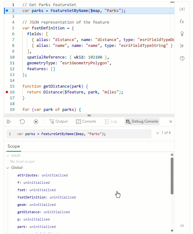

Once you select Run and Debug, the debug console will open, and the script will run and pause when a breakpoint is encountered. The current breakpoint will be indicated in multiple ways: the icon will change from red to blue, the line will be highlighted in the editor window, and a preview of the code will be displayed at the top of the debug console. A summary of all script breakpoints is also visible from the dropdown menu to the side of the breakpoint preview.
When actively debugging, controls to navigate through the script will replace the Run and Run and Debug buttons:
  • Continue – Resume execution of the script until another breakpoint is encountered or the script exits. When the script exits the editor will switch to the Output window automatically.
  • Reset – Stop the current execution and restart from the beginning of the script.
  • Stop – Exit the debugger and stop the script. The debugger navigation controls will disappear and be replaced with the Run and Run and Debug buttons.
Breakpoints can be added or removed while actively debugging, but these edits will not be active until you restart the script execution via the Stop or Reset action.

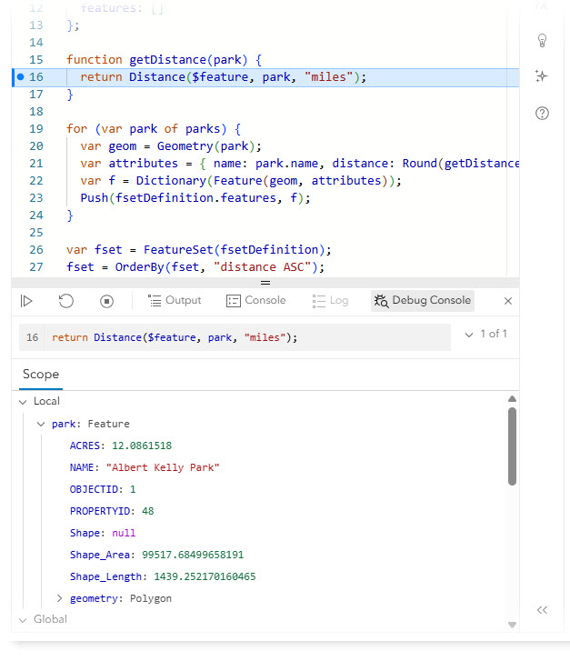

Under the navigation controls and breakpoint preview, the current scope of the script is shown. Scope is separated into three different levels: local, global, and profile. Let’s break down what each of those sections contains.
Arcade debugger is paused in a user-defined function body called getDistance and displays the current values for the local variable park.
The local scope section of the debugger willl display variables from the current function body.
Local scope will display variables declared within the current function and function arguments when paused in a user-defined function body. Global scope includes all variables and functions declared outside of user-defined functions in your script.
