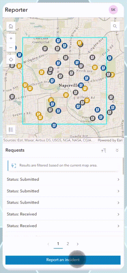

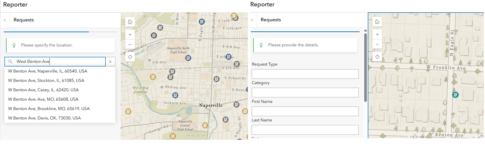

Residents start by clicking the Report Incident button (configurable), then search for an address using the search bar. This places a point at the selected location on the map, using either the default World Geocoding Service or a custom locator defined by the app author. Alternatively, a point can be added by clicking directly on the map.
The image shows an address being typed, and upon selecting the suggested result, a matching location is added to the map and highlighted in cyan.

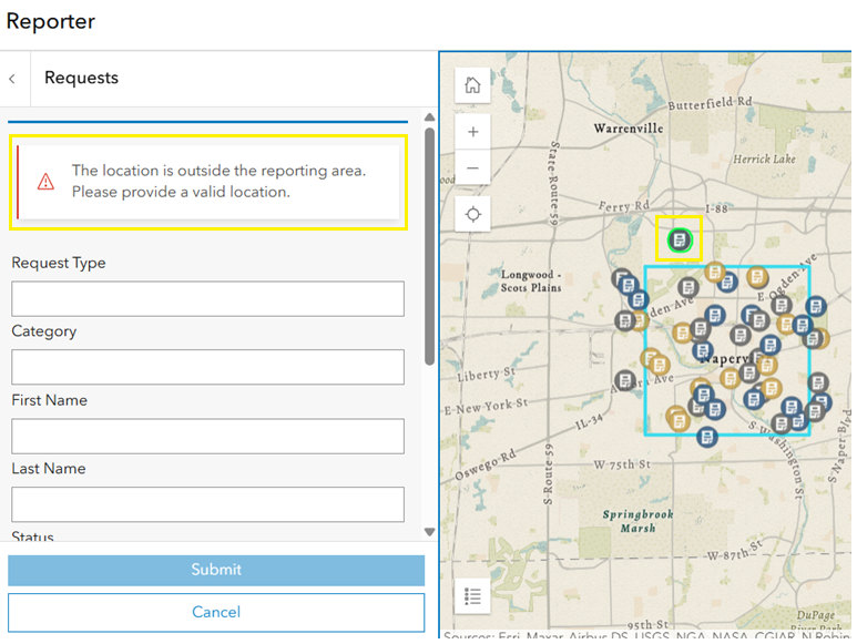

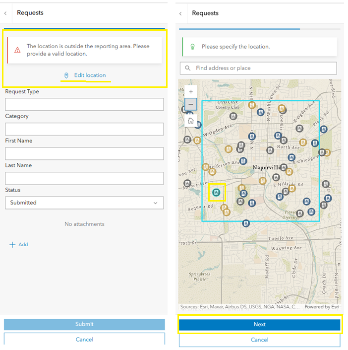

Consider a scenario where suggestions for new benches are only accepted within city-owned public spaces or a specific region in the neighborhood. To support this, the app can be configured with the Set report boundary setting, which uses an uneditable polygon layer added to the web map to define where reports are allowed. If someone selects a location outside this area, the app displays a warning message and disables the submit button until the location is adjusted.
In the image below, the blue rectangle represents the report boundary. When a report’s location falls outside this boundary (highlighted in yellow), a warning message appears on the panel, and the submission is disabled until the location is corrected.
Location can be adjusted during the report submission workflow, whether on desktop or mobile, and regardless of whether a report boundary is enabled:
  • On desktop, drag the point to refine the location.
  • On mobile, tap Edit location to open a map interface and reposition the pin.
In the image below, the mobile workflow is illustrated, showing the Edit location option used to adjust the pin. When the location falls within the boundary, the Next button is enabled.

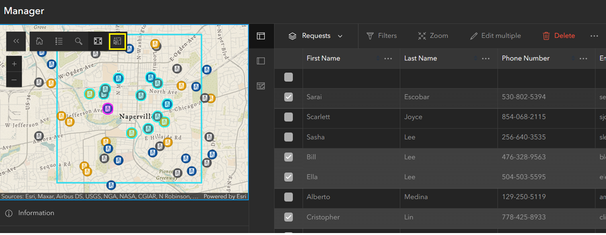

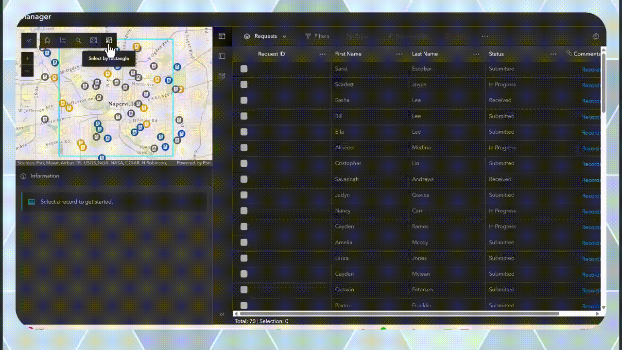

To focus on requests in a specific part of the map, the Select by rectangle tool can be used to quickly draw a box over the region of interest and capture all relevant features.
In the image below, Select by rectangle tool is used to draw an area on the map (not shown), and the selected features are highlighted in cyan.

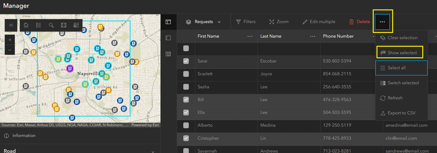

The selected features appear on the map, and their corresponding rows in the table are marked with a check to indicate selection.

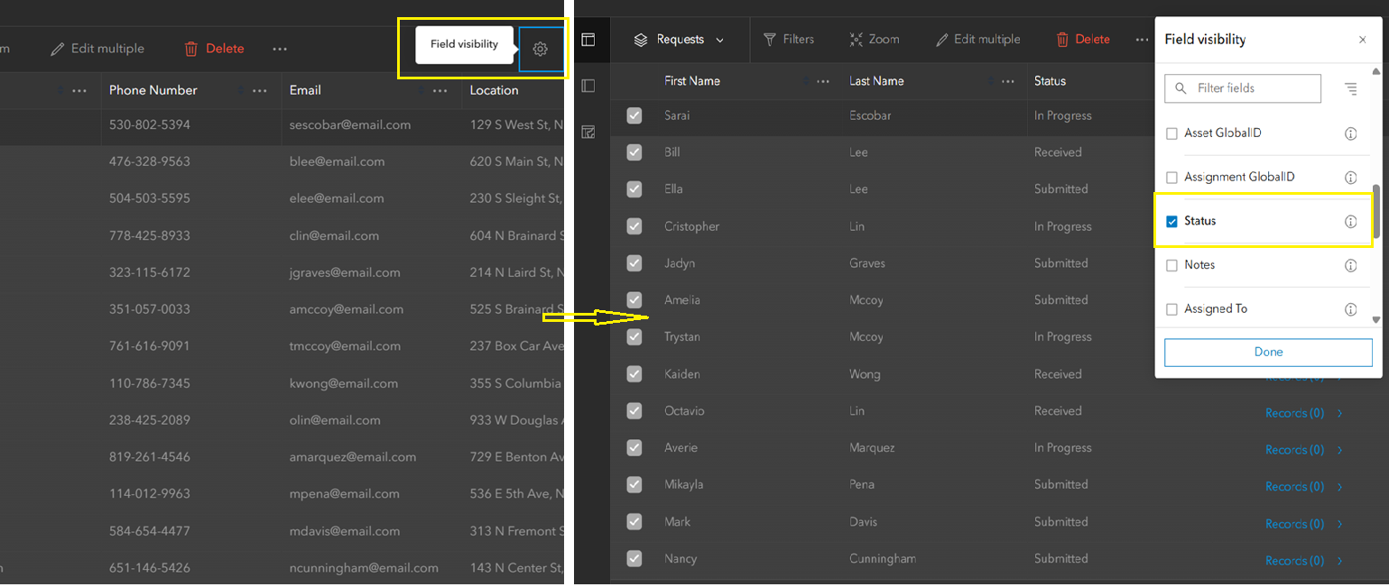

As shown in the image below, selecting Show selected from the ellipsis menu filters the table to display only the selected reports.
To simplify the view and show only important fields, the Field visibility button (gear icon shown in the image) is used. In this case, First Name, Last Name, Status, and Related Record are selected.

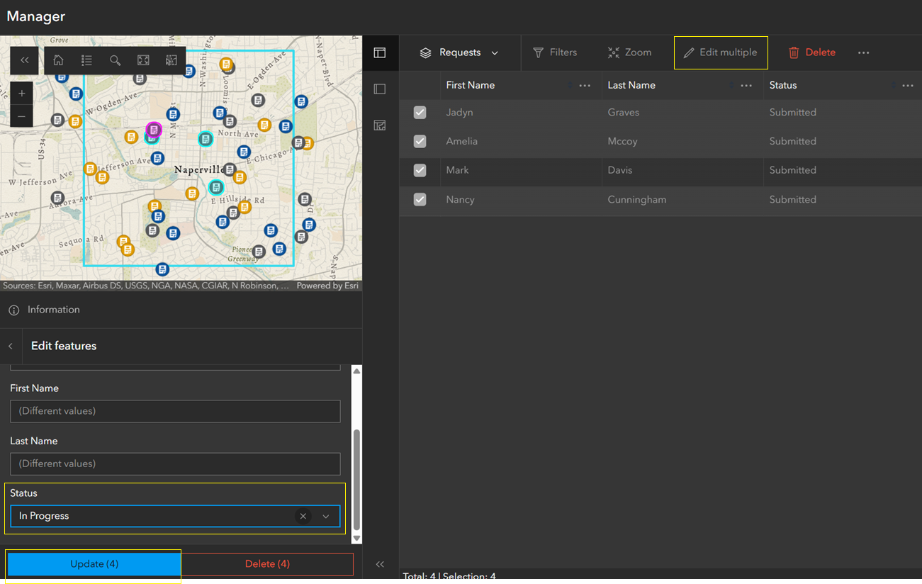

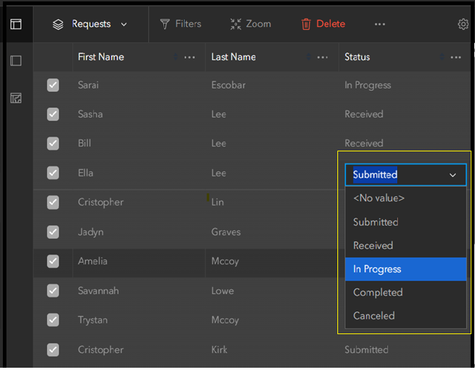

The selected features have mixed values in the Status field and are further narrowed down by deselecting records, keeping only those marked as Submitted. Once the records are filtered, the status can be updated using one of two methods:
  • Edit in table
  • Edit multiple
When Edit in table is enabled in the configuration, individual records can be updated directly within the table, powered by the FeatureTable widget from the ArcGIS Maps SDK for JavaScript. This method supports editing one record at a time, typically by double-clicking the cell to make changes.
To enable Edit multiple, the feature selection mode must be set to Multiple under Interactivity > Modify in the app configuration panel. This allows multiple features to be updated simultaneously using the Edit multiple button in the pop-up panel.
In the image below, selecting Edit multiple opens a popup panel in the bottom-left corner. The Status field is updated from Submitted to In Progress, and the Update (4) button is clicked—where the number in parentheses reflects the count of selected records. The panel also provides an option to delete multiple selected features.

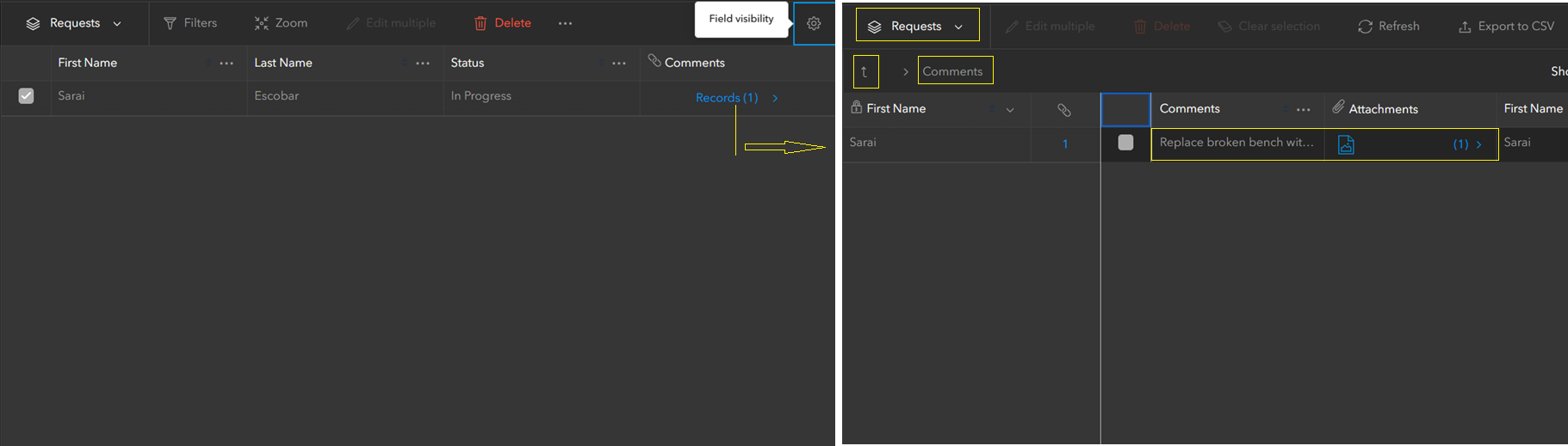

To explore additional details, planners can view comments or images linked to a specific bench request. These are stored in a related table associated with each request and submitted through the Reporter app.
As shown below, clicking the Related records button (with a number showing how many records are linked) opens a side panel. For clarity, the top of the panel shows the name of the current feature layer (Requests), while the related table (Comments) appears below. The table displays the fields and, if supported, any attachments. The view can be closed using the Exit related records (up arrow) button.
