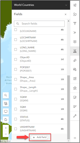

The Add field button is located at the bottom of the Fields pane in Map Viewer.
The Add field button can be found on the bottom of the Fields pane.
Adding fields

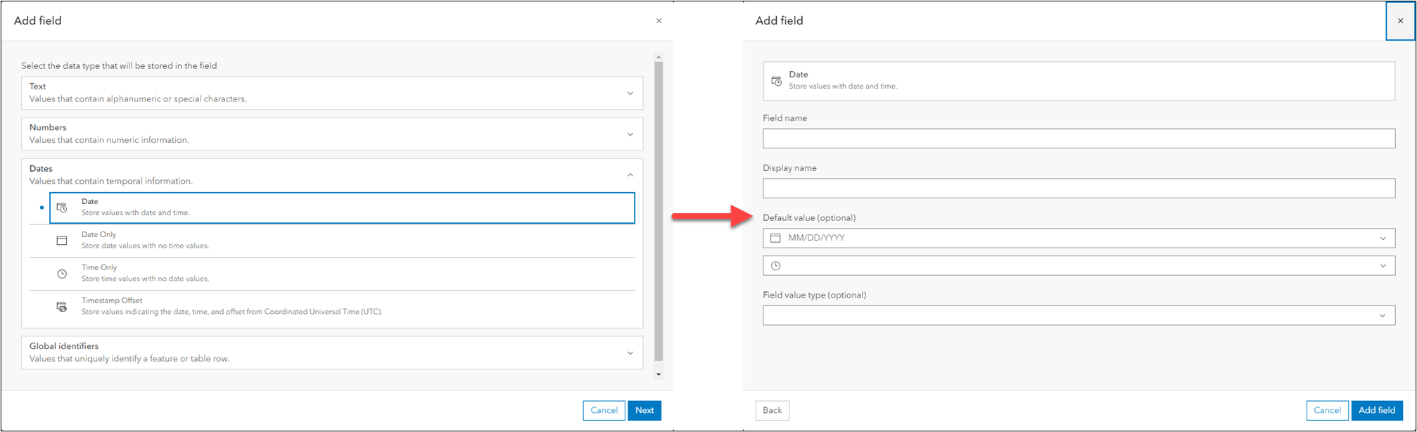

At the bottom of the Fields pane, there will now be an option to Add field. Clicking this button opens the new add field experience. You will then need to select what type of field you want to add to your layer. The available field types are separated into general categories based on the type of data they can contain (text, numbers, etc.).
After you’ve selected the field type, select Next to fill out your field parameters. The parameters shown in this step will vary depending on the selected field type. For example, the length parameter is only applicable to string fields. Some of the parameters are optional, and this is indicated in the text above each input. You must ensure all non-optional parameters are filled out before you can successfully add the field to your layer.
A side-by-side view of the two steps in the add field workflow. Depending on the field type chosen, the list of input parameters will dynamically change.
The inputs required when adding a field will vary depending on the chosen field type.

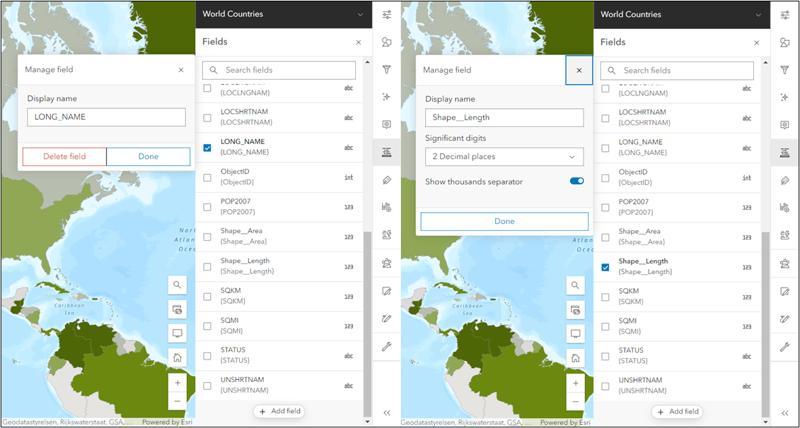

A side-by-side view of the fields pane showing one field that is eligible for deletion and one that is not.
If a field is eligible for deletion, the Delete field option will appear when it is selected in the Fields pane. Some fields, including system-maintained geometry fields, are not able to be deleted.
Deleting fields
To delete a field, select it from the fields pane to open the Manage field window. If the field is eligible for deletion, you will see an option in this window to Delete field.
Some fields are not eligible for deletion for data integrity reasons. This is primarily to prevent deleting a field that could corrupt existing web maps that use the layer or table. For example, fields used to style or filter the layer, or those being actively used to label in the web map cannot be deleted. Other fields that are not eligible for deletion via the Fields pane include:
