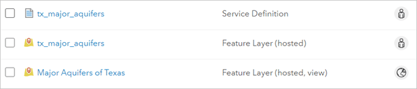

First, we have a feature service and a hosted view of the Major Aquifers of Texas (tx_major_aquifers) which is missing the Trinity Aquifer (green). The feature service item ID is 218b88c26fb240ae9a7c2e2609b07915.
Note: The Major Aquifers of Texas feature service has a hosted view linked to it. Hosted views are ideal for keeping different data representations such as symbology. After updating or overwriting a feature service, a hosted view retains the previous data representation and properties.

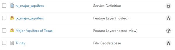

Texas Aquifers Items

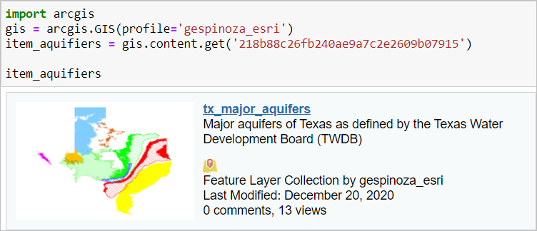

We use the ArcGIS API for Python to retrieve the tx_major_aquifers feature service using the GIS module and an authentication schema.
Notebook Get Item

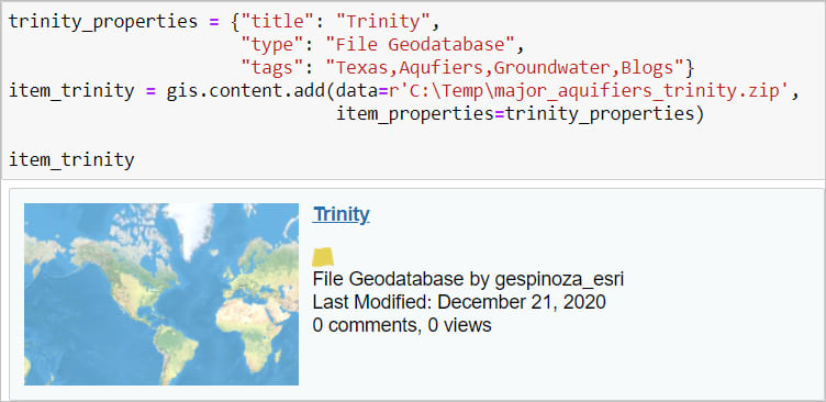

We use the GIS module to add the local zip file (major_aquifiers_trinity.zip) that contains the Trinity aquifer geodatabase to ArcGIS Online. We provide a dictionary with the item properties such as title, type, and tags.
Notebook Add Item
The Trinity geodatabase is added to our ArcGIS Online content.
Trinity GDB Item

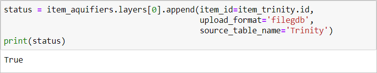

Append GDB to Feature Service
We now append the Trinity geodatabase to the first and only layer (id=0) in the tx_major_aquifers item.
Notebook Append

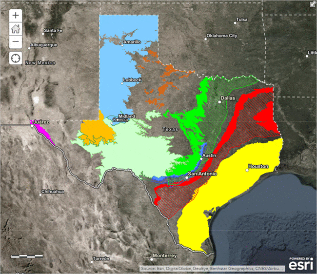

The Major Aquifers of Texas feature service and its hosted view are now displaying the missing Trinity Aquifer.
Major Aquifers of Texas (complete)
