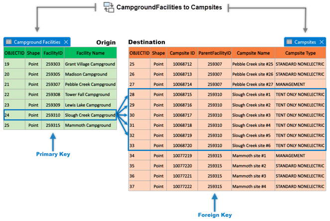

This is an example of a one-to-many (1:M) relationship class. The relationship is between the origin (Campground Facilities) to the destination (Campsites).
Before creating a relationship class, it’s important to think through a few key design choices to ensure it supports your workflow correctly. Decisions around the relationship type and cardinality directly affect how features connect and behave.
Primary and Foreign Keys
To create a relationship between features in different tables, there must be a way to match records across those datasets. This is done using fields that contain corresponding values in the origin and destination tables—known as the primary key and foreign key.
  • Primary keys – are unique identifiers for each record in a table. They ensure that every feature or row can be referenced reliably.
  • Foreign keys – are fields in the related table that store the primary key values from the origin table, creating the link that identifies which records are related.

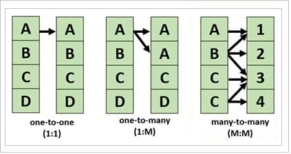

Cardinality
When you create a relationship class, the cardinality defines how many features in one dataset should be related to features in another. There are three different options:
Cardinality types diagram.
  • One-to-One (1:1) – Each feature in the origin dataset relates to no more than one feature in the destination, and vice versa.
  • One-to-Many (1:M) – A single origin feature can relate to multiple destination features.
  • Many-to-Many (M:N) – Features in each dataset can relate to multiple features in the other. To support this type of relationship, the geodatabase automatically creates an intermediate table that stores the keys linking each pair of related records.
Note: In ArcGIS Online, managing a many‑to‑many relationship class currently requires manually adding records to the relationship class table and entering the appropriate keys to create each relationship. If the relationship class is composite, it will not cascade the deletion to related features in the destination table.

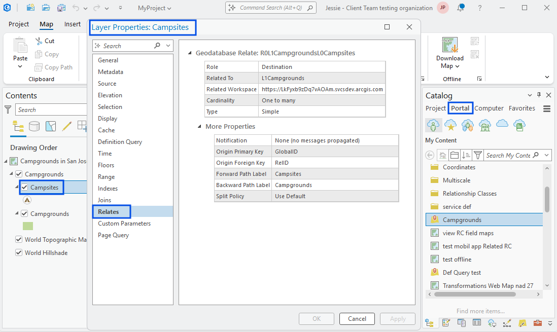

ArcGIS Pro
  1. Open a map in ArcGIS Pro.
  2. Connect to your instance of ArcGIS Online.
  3. Add the hosted feature layer to the map through the portal connection or using the feature layer’s URL (Add Data > From Path).
  4. In the Content pane, right-click on one of the datasets that is participating in the relationship class.
  5. Select Properties.
  6. Go to the Relates tab and there will be a summary of the details of the class relationship parameters.
Screenshot of the Properties tab in ArcGIS Pro on the Relates section, displaying the relationship class properties.
