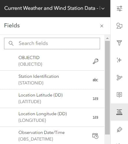

Open Map Viewer and add the layer above or choose your own layer to follow along. Click the layer from the layer list to activate the tool bar, and complete the following steps:
- Click on the Fields button (right toolbar)
- Select the attributes to be batch formatted (must be the same data type)
- Select the preferred format in the formatting window
- Click Done

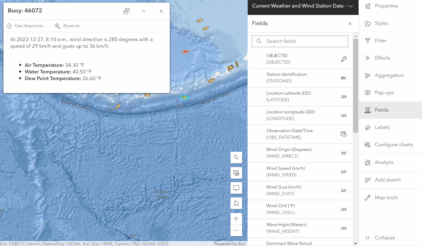

The batch formatting feature is useful for layers with multiple numeric or date fields that aren’t in the same format or aren’t meaningful in their current format. In this example, I want to display the air, water, and dew point temperatures for buoy weather stations in a way that is easily understood. The attributes are shown with two decimal places by default, but the second decimal place is unnecessary. In just a few clicks, I can format all three temperature fields so that only one decimal place is shown.
Notice how making these changes with a pop-up open allows me to see the format change in real-time. Although it is a minor change, my pop-up looks cleaner and more readable.
