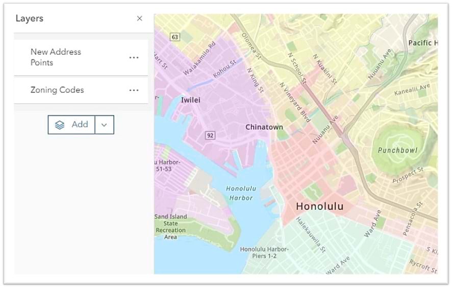

Layers added to Map Viewer appear in the Panel on the Left.
Step 1: Author a map with an editable layer and reference layers
You’ll need a map with at least one editable layer, and a reference layer that contains the zoning codes. In this example, we have the following layers:
  • Editable layer: New Address Point
  • Reference layer: Zoning Codes
Let’s take a look inside the attribute table for Zoning Codes. The field ‘zone_class’ contains the information we want. We need to take note of both the layer name and the field name, as we’ll use these later in our Arcade expression.
A look inside the Zoning Codes attribute table
Explore the data to get both the name of the layer and the name of the field that contains the information you want

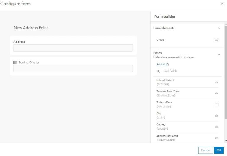

Step 2: Author a form
  1. With the editable layer selected, click the Configure Editing button on the Settings (light) toolbar
  2. In the menu that opens, select Forms Forms button
  3. The form builder opens.
  4. Add fields to the form by dragging them onto the canvas on the left.
Add fields to a form using Form builder.
