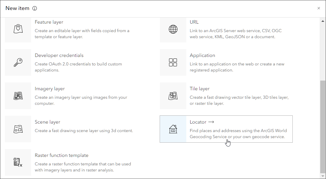

		Step 3 — Scroll down in the New item pane to find and select Locator.

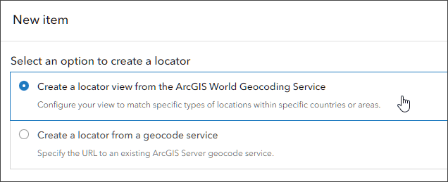

		Step 4 — Choose Create locator view from the ArcGIS World Geocoding Service. Then click Next.

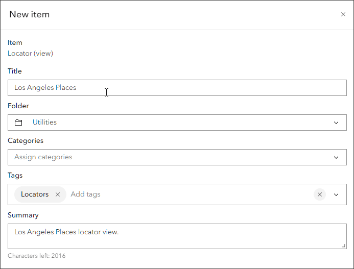

		Step 5 — Add a title and other optional information to the new Locator (view) item. When finished, click Save.

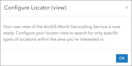

		Once you click Save, the new locator item is created. You will be prompted to configure the locator view. Click OK to begin.

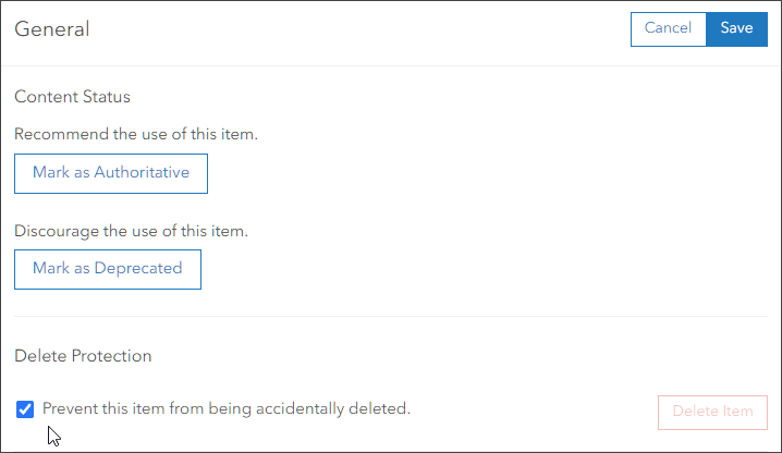

		Step 6 — The item Settings tab will open. Since you will be using this locator in your organization, it’s a good idea to set Delete Protection in the General section. Click Save to ensure delete protection is set.

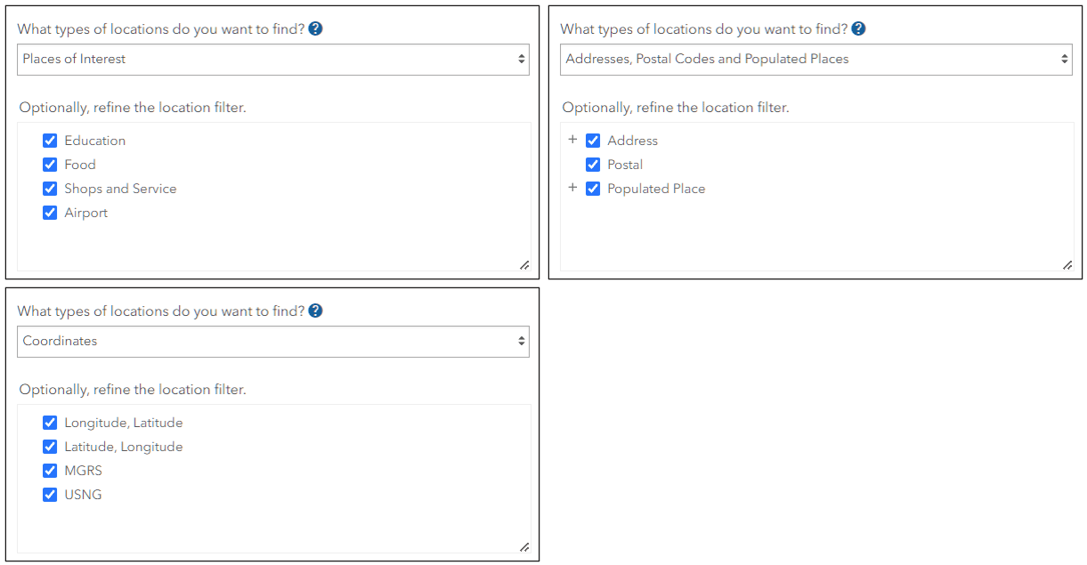

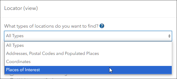

		Step 7 — Scroll down to the Locator (view) section. From the location type drop-down, choose Places of Interest. This limits the results returned by the locator view.
		Once chosen, you can refine the location filter as desired. Each location type will offer different options. For the locator view we are configuring, all location options will be left toggled on.

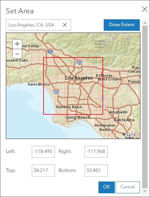

		Step 8 — Since the locator view should focus on Los Angeles places, in the next section choose Within a specified area, then click Set Area.
		Step 9 — Enter a place to find (in this case Los Angeles) and click Draw Extent to refine the area. When finished click OK.

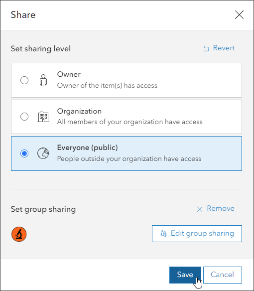

Step 11 — In order to use the locator view, it must minimally be shared to your organization. You can also share it publicly if desired.
Note that anonymous users will only have access to locator views that are shared with the public. Locator views that are shared with the organization are only accessible to organization members. Anonymous users will not be able to perform geosearch in any apps using locators that are only shared with the organization.
Since we want to publish an public app that anonymous viewers can use to find places in Los Angeles, the locator will be shared publicly.

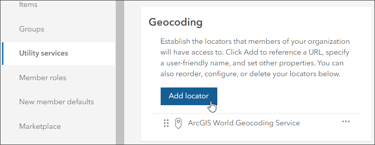

Step 1 — In the organization setting, choose Utility services and locate the Geocoding section. Click Add locator.

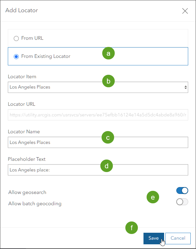

		Step 2 — In the Add Locator pane, consider the following settings:
(a) – Choose From Existing Locator
(b) – Select the locator item.
(c) – Set the locator name.
(d) – Add placeholder text.
(e) – Review search settings.
(f) – Click Save when finished.

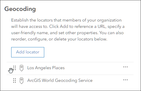

		The locator view is now available. You can order organization locators via drag and drop.

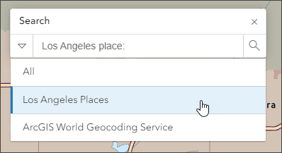

Once configured for your organization, the locator view is available in Map Viewer for all members. If you share the map using your organization URL, anonymous viewers can also see the locator view as a search option.
Open search, click the locator you want to use, and begin entering text.

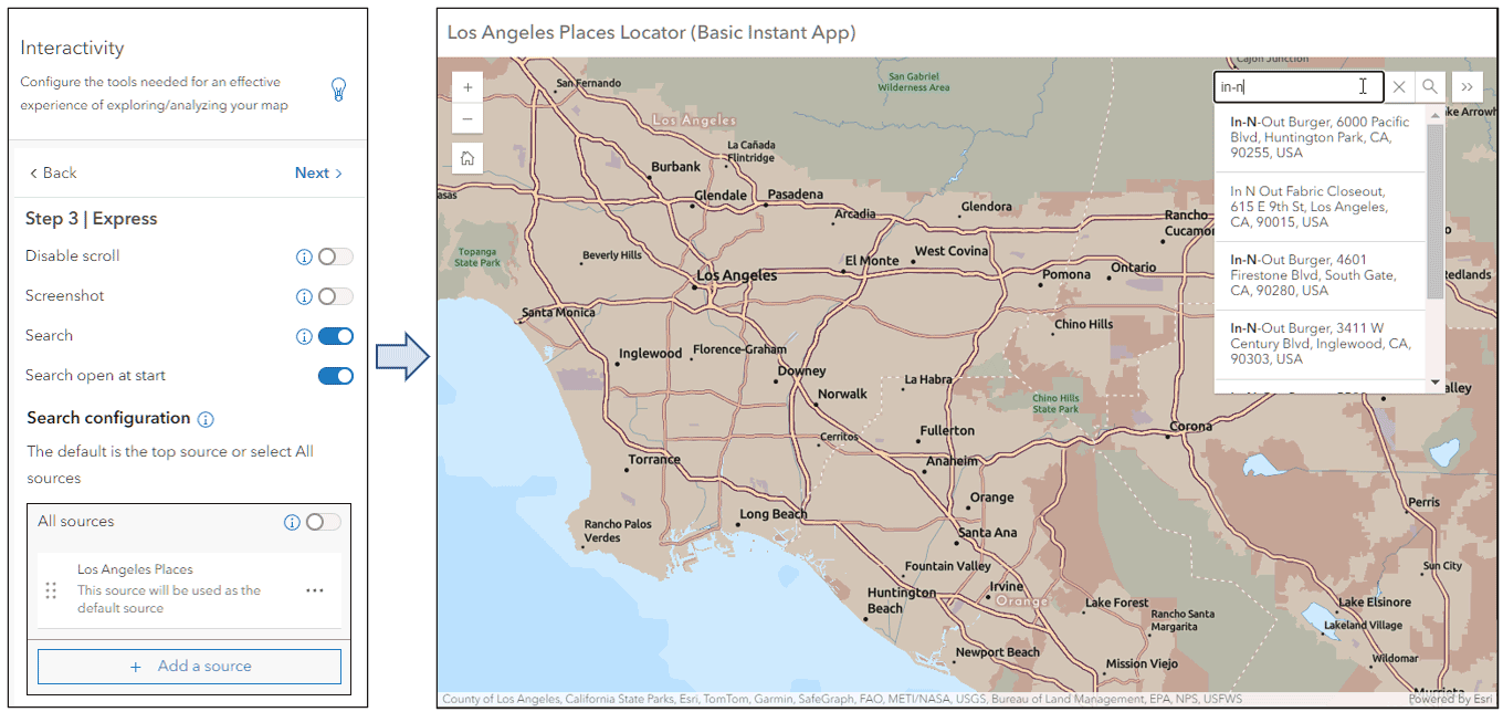

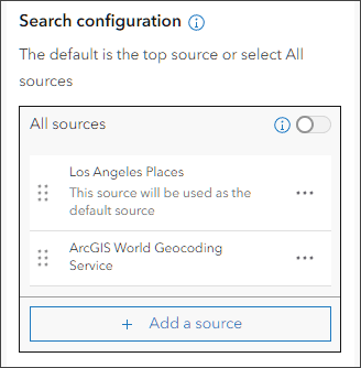

ArcGIS Instant Apps can be configured to use locator views and by default any locators configured in the organization settings will be available in the app. The app can be configured to use all locators or just one, and the locators can be ordered as desired.
		The Los Angeles Places Locator (Basic Instant App) example, whose search setting are shown below, has been configured to use only the Los Angeles Places locator by deleting the ArcGIS World Geocoding Service in the app settings. It has also been configured to open Search when the app opens.
