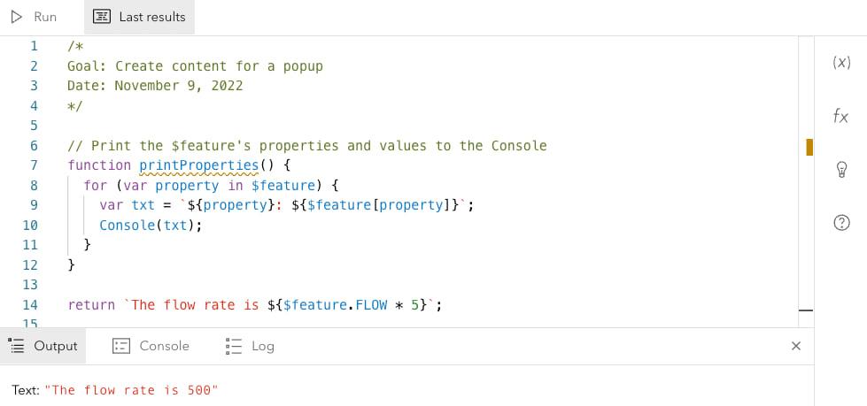

The panels in the Results window will show you what your expression returned, the outcomes of your Console() function call(s), and the performance of your executed expression.

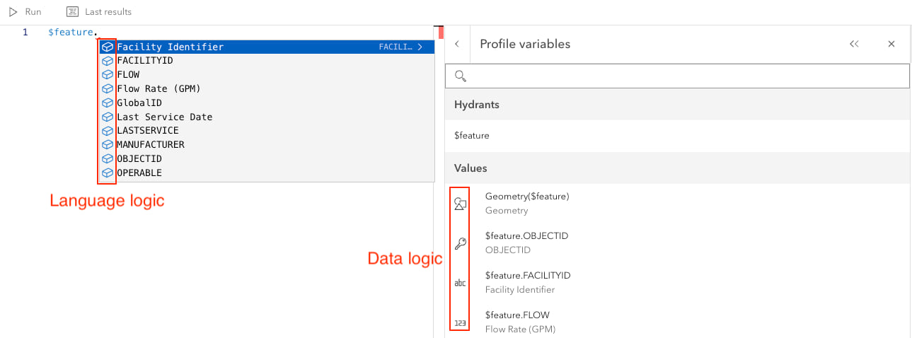

The side panel is your go to for in-editor help. In this section, you’ll find information about profile variables relevant to your profile, documentation for constants and functions, a link to the official Arcade documentation, and, in some case, suggestions.

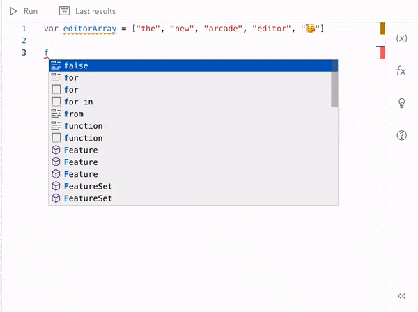

As soon as you start typing in the Expression window, suggestions will begin to appear and continue to appear until there are no more suggestions. Each suggestion has an icon, a description, and a name.
Types of icons:
| Icon | Name |
Functions |
Variables |
Fields |
Namespaces |
Constants |
Keywords |
Code snippets |
When you find the suggestion you want, click on it to add it to the Expression window. By pressing Enter on the suggestion, you can achieve the same outcome.

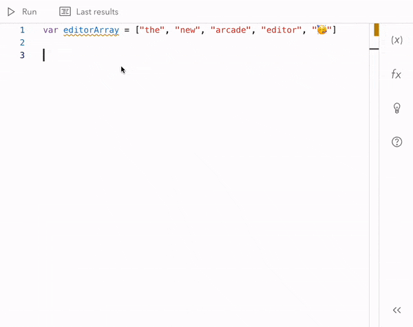

If you’ve already tried out the redesigned Arcade Editor, you probably noticed that suggestions and code insertions from the in-editor help may come prefilled with placeholders. In the example below, the inputArray_ placeholder in the First() function indicates that we can replace it with our array. The array we want in the First() function in this case is our editorArray, which we defined on Line 1 of the Editor.

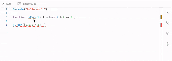

You can see where you stand in relation to all of your code by using the vertical overview bar on the right side of the Expression window. It can be especially useful as your Arcade expression grows because it can show you where errors and warnings reside.

Code colorization
The redesigned Arcade Editor, like the previous version of the Editor, makes use of color to aid readability and debugging. You can see the colorization of code in the Expression window, Results window, and in-editor help. A colorblind-friendly color palette is coming soon!
- Special characters, such as operators, are colored black
- Constants, functions, and variables and their fields are colored blue
- Numbers are colored green
- Texts are colored red
- Keywords (and reserved words) are colored purple
- Comments are colored light green
- Warnings are underlined with dark yellow squiggles
- Errors are underlined with red squiggles.
