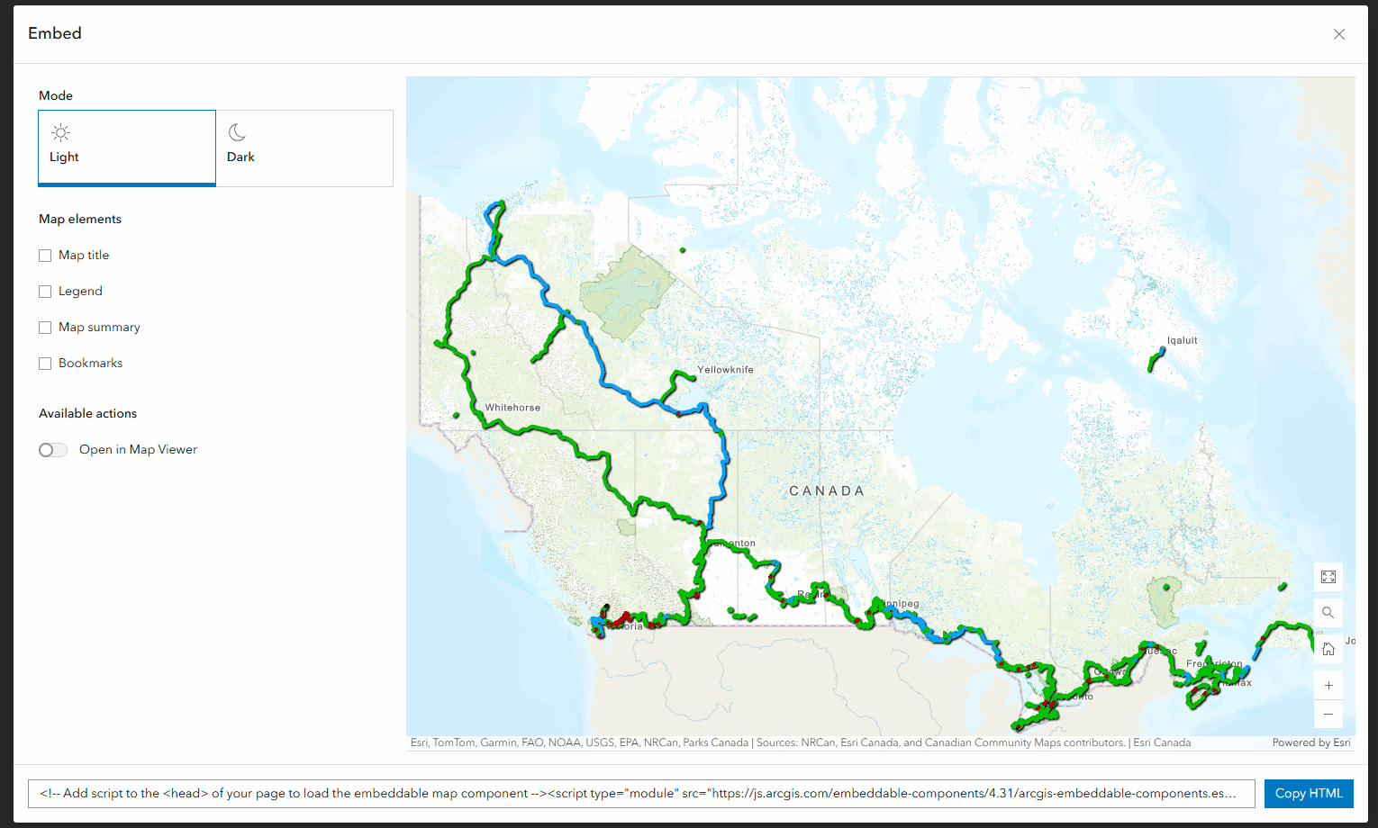

To access the embed option in Map Viewer, ensure that you have a publicly shared web map open. From the Contents (dark) toolbar in Map Viewer, simply click on Embed map to open the configuration setting (Note – if your web map is not shared publicly, you will be prompted here to update the sharing settings).
The embed window provides a preview of how your embedded map will look. As you adjust the settings, you will see them automatically reflected on the preview map. Choose the settings that make the most sense for your web site and map.
An animated GIF showing the embed map configuration options.
Customize the map elements that you would like to include.

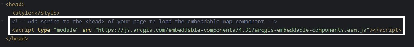

Once you have selected the settings you want, simply click the Copy HTML button to copy the code required to embed your map. The copied HTML code contains a script tag and the custom element with the map to embed. The script tag should be pasted into the <head> of your page. The custom element should be added to the <body> of your page where you want the map to appear. Both are required for the embedded map to display.  Once copied, you can further edit the code if needed to change the size, remove map elements you no longer want, or even swap out the web map ID. In this example, I’ve created a basic website documenting some adventures on the Trans Canada Trail and I’d like to embed this  Trans Canada Trail map from the Living Atlas.
I’ll start by pasting the first part of the Map Viewer output to the top of my page:

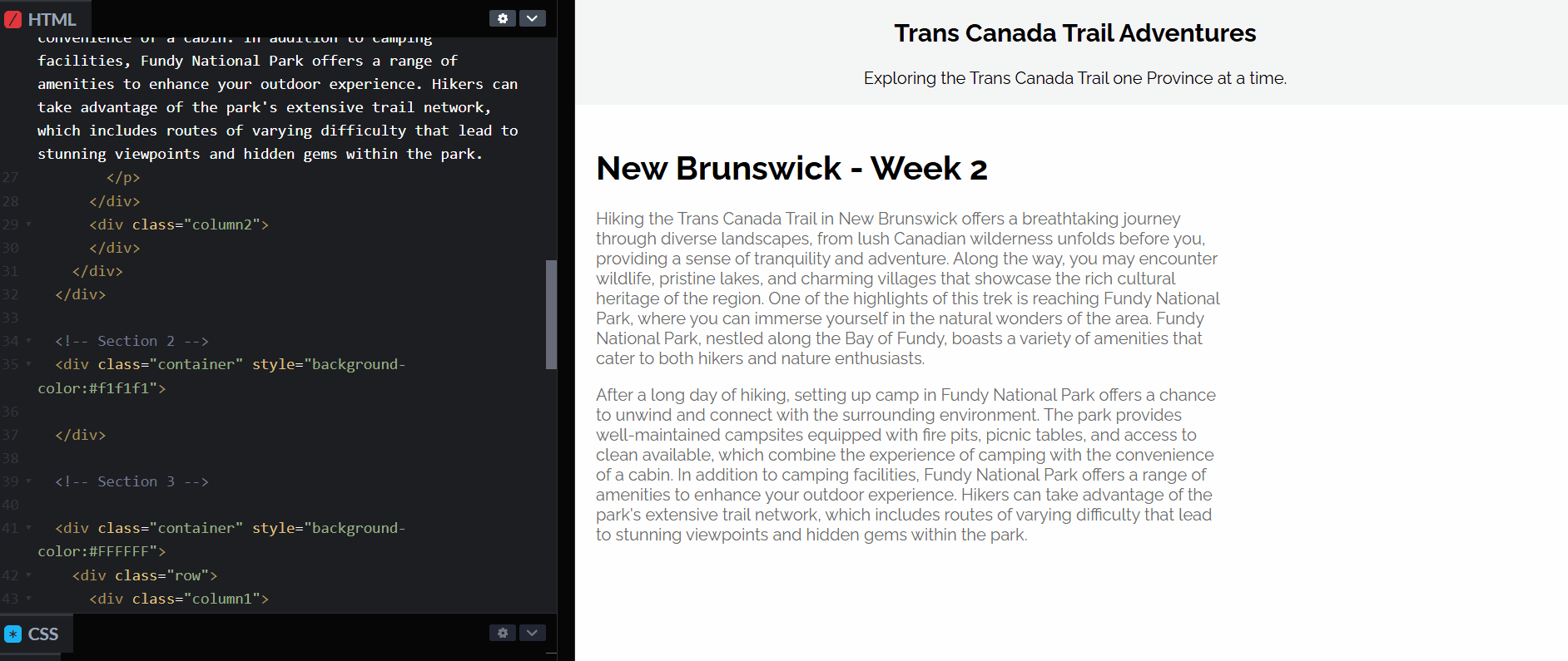

Next I’ll copy the final part of the code into the <body> of my site to see the map:
Embedding a map with the default settings.

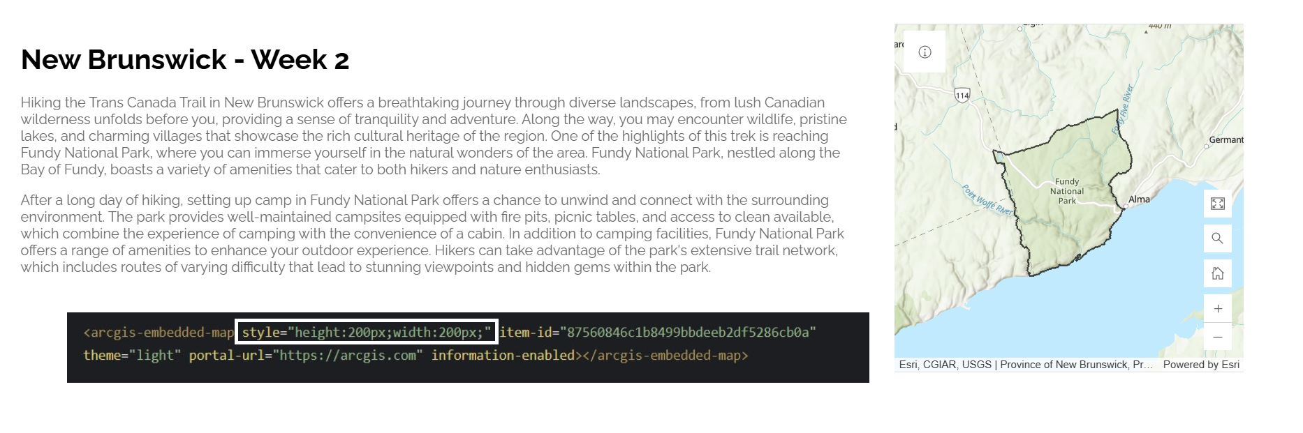

You can embed multiple maps into a single site, and remember – you can customize the size as well. In my example, I’ve decided to include a small map at the top showing the boundary of Fundy National Park.  Simply paste in the code the same way and adjust the height and width values as needed.
Customize the height and width of your map if needed.
