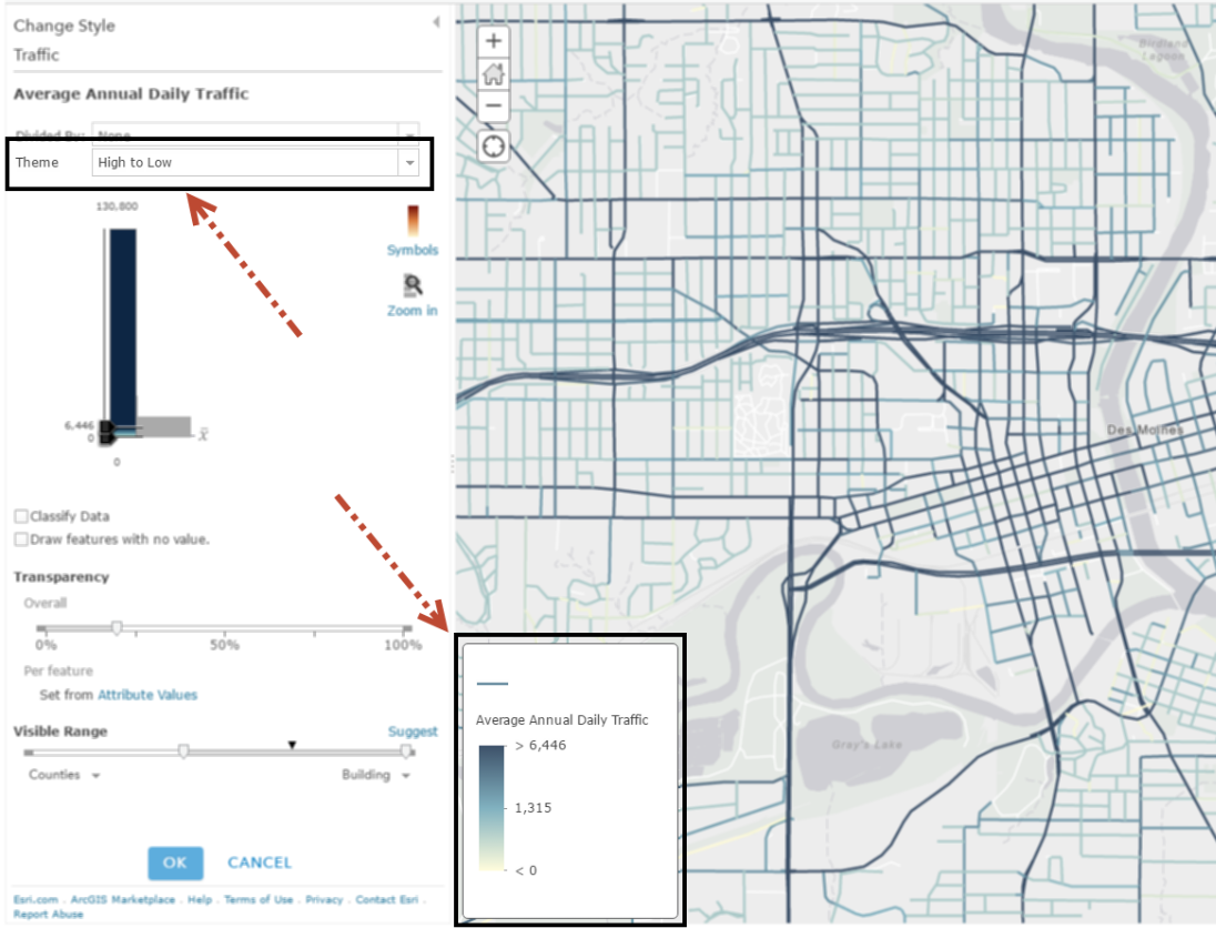

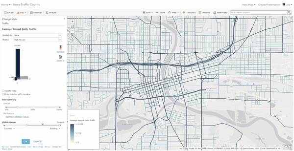

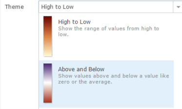

Smart mapping will automatically provide you a map using a “High to Low” theme. This is a great way to emphasize the highest and lowest values in your data using a gradient of colors, or two distinct colors (one for the highest and one for the lowest). For example, if the city of Des Moines, IA wants to map the annual average daily traffic on its roads, the default High to Low theme highlights which roads have the most traffic with the darkest color in the ramp.

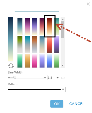

Remember our first tip? Let’s put it into action. We can select one of the many color ramp options to change the roads from the default blue to a brown. The use of brown instead of blue might make more sense to the audience in the context of the map showing roads and car traffic.

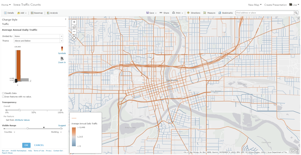

Another way to change the story being told, is to change the theme option to Above and Below. This centers the map around an central value, using color to show which features have values above or below the specified value. By default, smart mapping uses the statistical average of your data, but you can also adjust the center to a value which you know is meaningful to the map subject.
For example, if the city of Des Moines wants to know which roads have above-average daily traffic, they could use the Above and Below theme to easily highlight the pattern. When using this technique, smart mapping provides color ramps that diverge into two different colors, where the value you choose to center your map will be the point at which the colors split. In this map, we can easily see that the brown streets have daily traffic levels that are above average, while blue streets are below-average.
