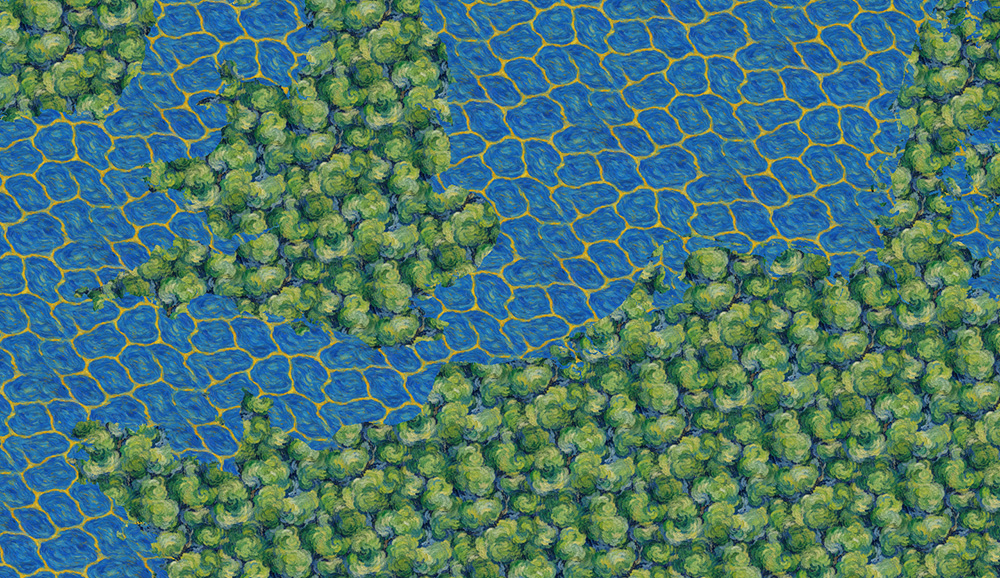

Or go full-impressionist, like this Vincent van Gogh inspired vector basemap.
