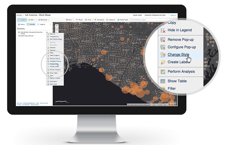

Available in ArcGIS Online and ArcGIS Server, smart mapping appears when working with your hosted data. See the full list of compatible layer types here. To get started, select the Change Style option for your layer. This brings you to into the smart mapping interface.

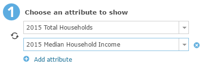

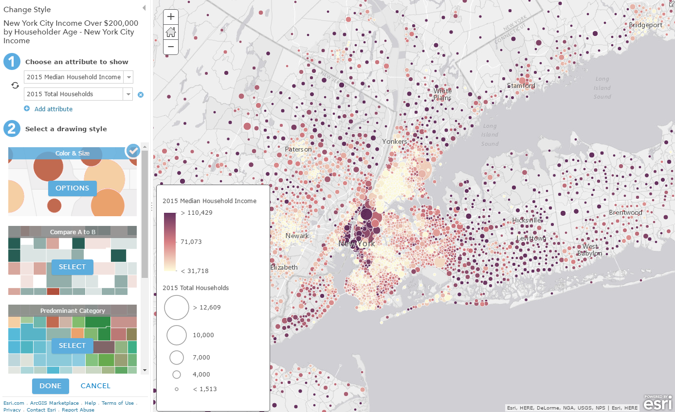

1: Choose Attribute(s)

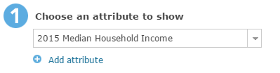

To start, choose an attribute (or multiple attributes) and you’re smart mapping!  Once you choose an attribute, smart mapping provides drawing styles based on the type of attribute. For example, selecting a numeric field such as Median Household Income provides options known as Counts and Amounts.
If you want to explore relationships between two or more attributes—for example, is there any connection between housing prices and life expectancy–you can add a second attribute using the Add attribute button. This technique shows both attributes on the map at the same time.

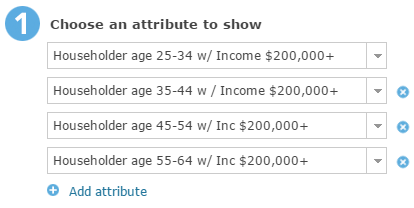

You can also choose up to five related attributes to compare their values. For example, you might want to represent multiple infrastructure projects by the output of each project. Smart mapping will display the project with the largest value within the map, which is technique known as predominance.

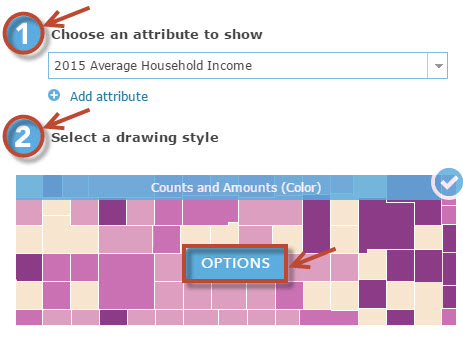

2: Select a Drawing Style
Once you have chosen a single attribute or attributes, smart mapping will recognize your data and attribute types to offer drawing styles.
To choose a drawing style you would like to try, click the SELECT button on the drawing style. The current drawing style appears with a blue heading and a blue check-mark. Smart mapping immediately provides a preview of your selection within Map Viewer. This allows you to dynamically see the map and the Legend as you make changes. It also means you can use the CANCEL button if you want to go back or try different drawing styles.
When selecting a drawing style, this quick reference provides helpful tips about what kinds of questions are answered by each style. Your map is a powerful tool of communication, and the different drawing styles can help you tell your story in the clearest way.
3: Explore the Options

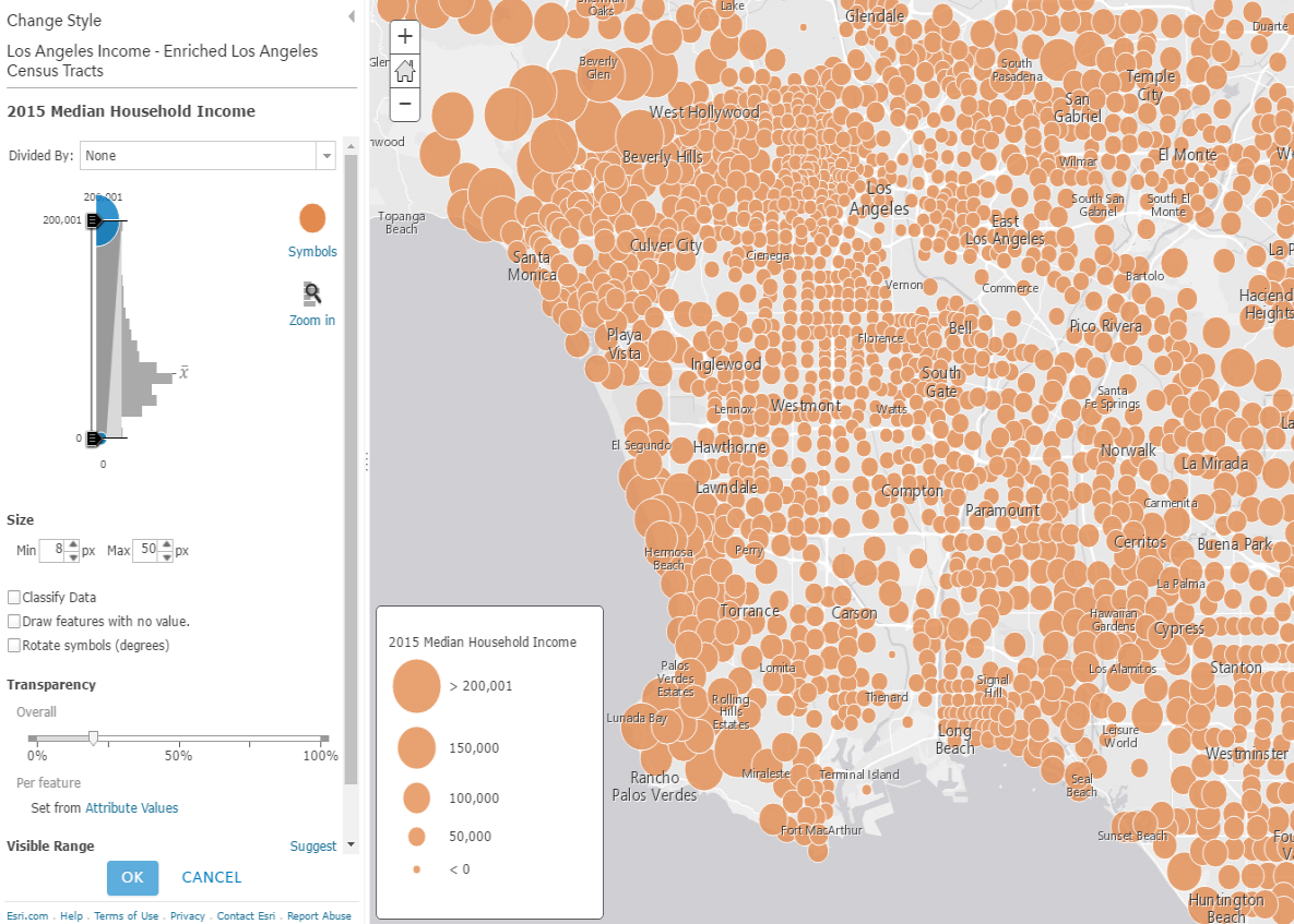

Once you have chosen a drawing style, it contains its own set of options for customizing your map. Click the OPTIONS button to explore your data and make additional cartographic changes. Depending on your attribute and data type, you can change things such as:
– The data classification method
– The symbol size
–  The symbol color and shape
– The transparency of the features
– The rotation of the symbols
Notice that there is also a histogram graph to help you understand how your data is distributed. The x̄ symbol allows you to quickly see the average value within the attribute you are using. By default, the map is set to highlight statistically significant high and low values. Drag the handles or type in a specific value to change the representation of the data values. You can also change the classification to use common methods: Natural Breaks, Equal Interval, Quantile, and Standard Deviation.
