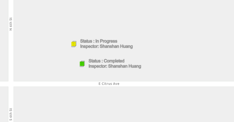

Also using string template literals make it easier to add line breaks into your text. You can simply hit enter to break the string into multiple lines.  Here’s a quick example that is a little more practical.  Let’s create a label expression that shows the status of the inspection, and who it is assigned to.  With each property on a new line.
Screenshot of multi-line labels
return `Status: ${DomainName($feature,"InspectionStatus")}
Inspector: ${DomainName($feature,"Inspector")}`
inside the template literal just use the enter key as if you were typing, and it will be honored when displaying the information (Multi-line labels only work in apps that use the 4.x  ArcGIS API for JavaScript such as the Map Viewer beta).
