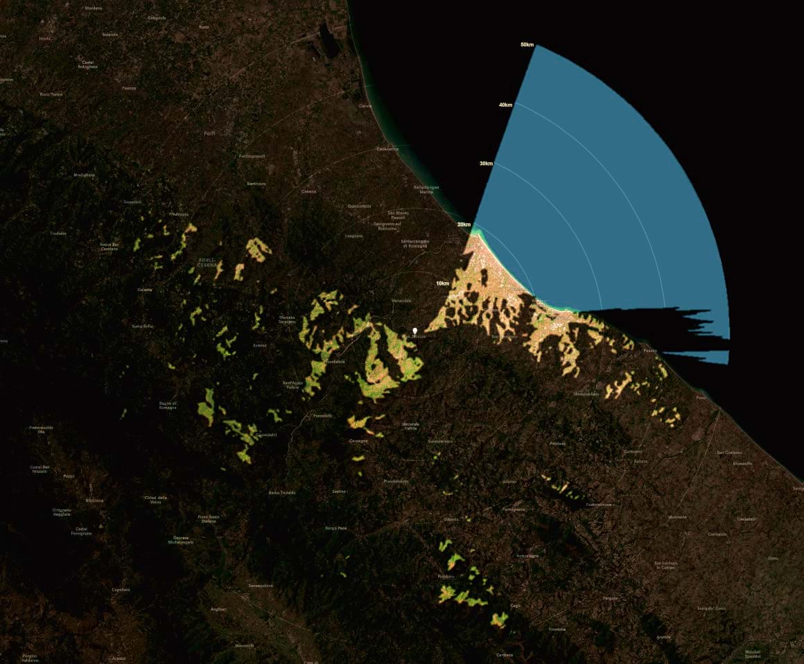

What can I see from here? That’s just the question that viewsheds answer. Viewsheds are a bit of spatial magic, empathy visualized. Here’s how to make a viewshed layer in the ArcGIS Online analysis tools, and how to style it into a sweet illuminating light source.
Ready to light up your map with the glowing terrain of visibility? Here’s how…

Viewsheds are so cool. You feed it some observer locations and, based on underlying elevation data, it cranks out a polygon showing where you can see. So many uses for this. And it’s so easy and fast. I hope you give it a try and share your results!
