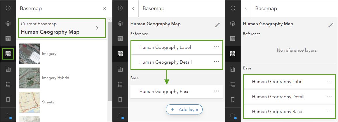

2. At the top of the Basemap pane, click the Current basemap button. Move the Label and Detail layers into the Base part of the basemap.
Reordered basemap layers
This doesn’t have any visual impact on your map yet. But it will be important later.

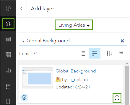

3. On the Layers pane, add the Global Background layer from Living Atlas.

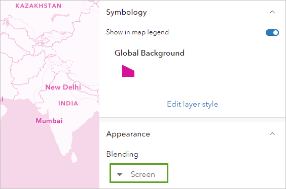

4. Change the Global Background layer’s color to pink. Change its blend mode to Screen.
Blend mode set to Screen
Now you have a pink map! Even the labels are pink, because you moved them into the Base part of your basemap, sitting below the pink layer.

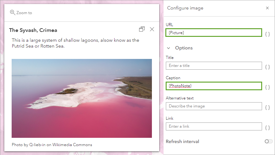

1. In the Pop-ups pane, click Title, click the attribute button and choose the Name field.
Name field
2. Click Add content and choose Image.
3. For URL, choose the Picture field. For Caption, choose the Photo Note field.
Pop-up with settings

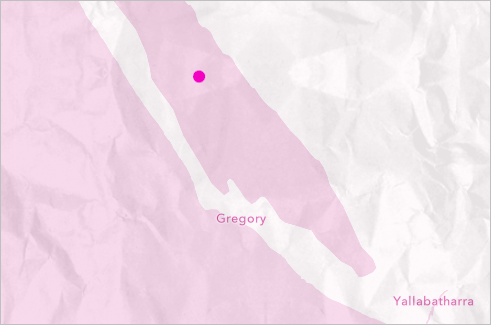

Human Geography Map is probably my favorite basemap, but when you zoom in to any of the lakes, you can’t see much.
Pink map detail

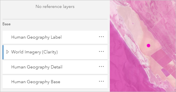

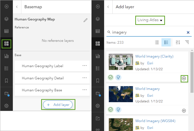

1. Open the Basemap pane to the Current Basemap layers.
2. Click Add layer and add the World Imagery Clarity layer from Living Atlas.
World Imagery (Clarity) layer

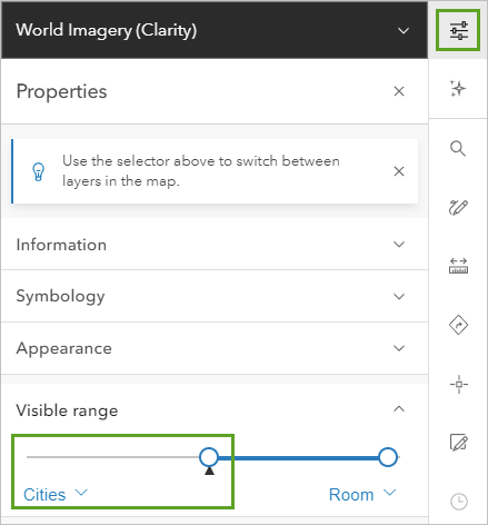

3. Drag the World Imagery layer below the Label layer.
4. In the Properties pane, for Visible range, change World to Cities.
Visible range

5. In the black bar at the top of the Properties pane, change World Imagery (Clarity) to Global Background.
6. For Visible range, change Room to Cities.
Visible range

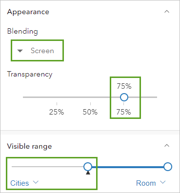

7. On the Layers pane, click Add layer and add another copy of the Global Background layer from Living Atlas. Move it to the bottom of the layer list.
8. For the new layer, set Blending to Screen. Set Transparency to 75 percent.
9. For Visible range, change World to Cities.
Appearance properties

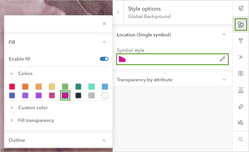

10. Change the color to pink.
Pink symbol

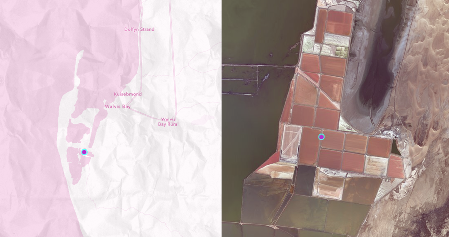

The idea here is to have two copies of the pink Global Background layer. You set the visible ranges so one only appears for the Human Geography basemap, and the other only appears for the Imagery basemap. The one that goes with the Imagery basemap is also transparent, so the imagery can be seen more clearly. It still casts a pinkish tint.
Comparison of two basemaps
