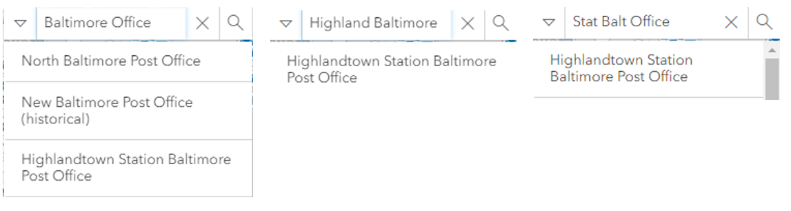

First off you are probably asking – What is a Full-text field index?
This type of index is created when you author a feature search under the application settings of a web map or in the instant apps layer-based search configuration. When the index is created essentially it will take the field specified in the search configuration and then scan the data in the field and tokenize the words within each row. Which pretty much means behind the scenes we are splitting up the data in the field into smaller units, such as individual words or terms that will improve the overall search performance.
Example:
Search is configured on layer with all the US Post Offices and using the Name field. An example result on the name field is Highlandtown Station Baltimore Post Office. The index will split up this example into these searchable terms Highlandtown Station Baltimore Post Office. This will make all the the terms now searchable with the full-text index where you could search Baltimore Office, Highland Baltimore, Stat Balt Office and be able to retrieve this feature from the search results.

The Search widget will now leverage Full-Text field indexes on hosted feature layers layer-based source searches. The index automatically gets generated when feature search is authored on a field for a hosted feature layer in web maps authored after the November 2022 release. You can update existing maps or create new ones to generate these indexes, so if this index type exists on the field being searched the widget will use it automatically. The search type being used in the search widget is called prefix. This will query the field with the characters searched and return results for words that begin with the specified text. These indexes greatly improve performance and stability especially with large search terms which we have seen with our testing take sub second vs. the double wildcard taking over ten seconds (more on the wildcard changes below). You can see an example of this prefix query in the above example Stat Balt Office where the prefix search is used to find Station, Baltimore and then a complete term Office.  However, searched for More you would not get results for Baltimore.
