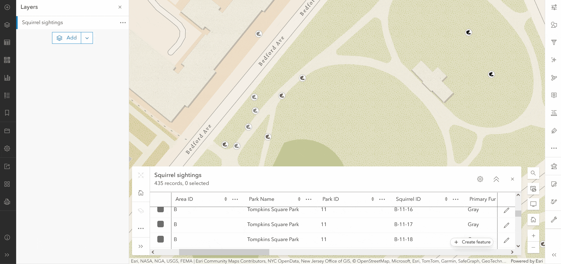

  1. Open the attribute table for a feature layer or table layer with editing enabled.
  2. Click the “Create feature” (or “Create record”) button in the bottom corner of the table.
  3. The Editor pane will open.
  4. If there are multiple feature templates available for your layer, choose the correct one. Optionally, start drawing your feature on the map.
  5. Enter the attributes in the Editor pane, then click Create.
The GIF shows the Editor pane open when clicking the “Create feature” or “Create record” button in the attribute table.
