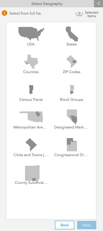

Being that it is a “full list”, it will need to start with the list of geography levels, then drill into our desired level to get the list of features in that level. When the click for “Select from Full List” is selected, the “StandardGeographyLevels” request, which is described above, is sent. The Business Analyst Web Application then associates each of the levels with an image and the result is here:
List of Standard Geographies in the Business Analyst web app

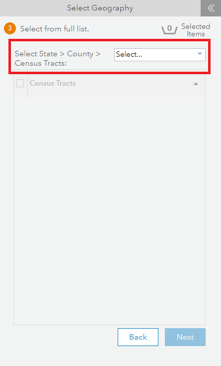

Since, I am looking to pick from random census tracts, I click on the “Census Tracts”. The Business Analyst Web Application uses the response from the StandardGeographyLevels request to query the branches which lead me to the “US.Tracts” level. The only entry leading to the census tracts level is listed above. This results in one possible branch and is displayed in the application as a menu to “Select the State > County > Census Tracts”:
When I click on the menu’s drop down a request is executed which will list all states that fall within the entire country. Here is an example of the request:

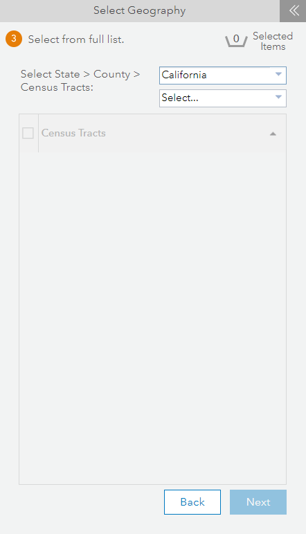

The next request that I send to the server will use some information from this record, like the DataLayerID and AreaID along with the DataLayerID of the counties level from the StandardGeographyLevels request, to ask for a list of all counties in the State of California:
https://geoenrich.arcgis.com/arcgis/rest/services/World/GeoenrichmentServer/StandardGeographyQuery/execute?langCode=en-us&sourceCountry=US&optionalCountryHierarchy=census&geographyLayers=[%22US.States%22]&geographyIDs=[%2206%22]&returnSubGeographyLayer=true&subGeographyLayer=US.Counties&featureLimit=5000&f=pjson
Since there is another level of geography between the US.States level and the census tracts on this branch, this results in another drop-down in the menu where I can choose which county I want to search in:
The drop-down menu is populated with the names of each county in the State of California. I have decided that I am interested in a random area in San Bernardino County, so I search the list for “San Bernardino County”. If looking at the response to my request, I find the following record for San Bernardino County:
