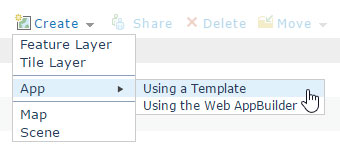

Step 2. From My Content, Click Create, choose App, then choose Using a Template.

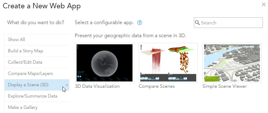

Step 3. In Create a New Web App, select Display a Scene (3D) to view the available scene apps.

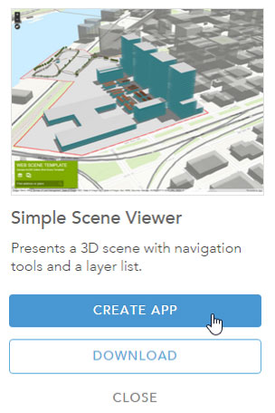

Step 4. Select the configurable app you want to use, in this case Simple Scene Viewer.
Step 5. In the app preview click Create App.

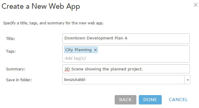

Step 6. Enter the app title, tags, and summary, then click Done.

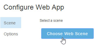

Step 7. Click Choose Web Scene, and browse for the scene you want to use in the app. You can use a scene you have authored, or any other scene in ArcGIS Online.

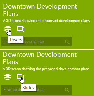

Click Layers and Slides to view different layers and an interactive slideshow tour of various locations.
Compare Scenes and 3D Data Visualization are other available configurable apps you can use to display and share 3D scenes.
