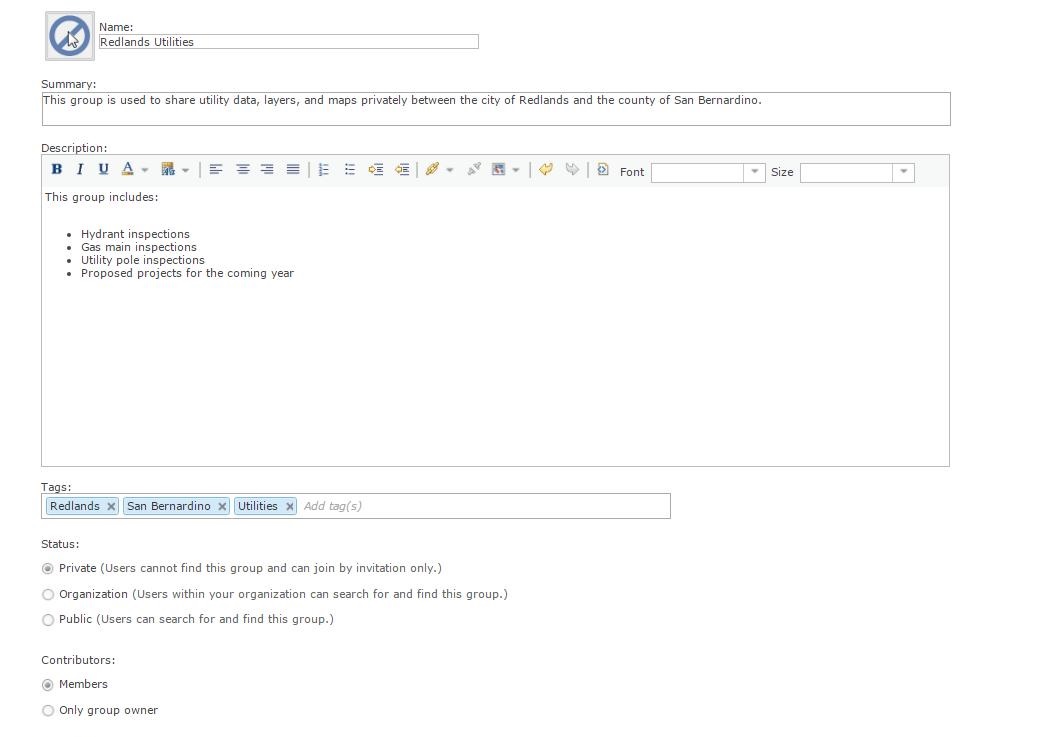

The first step to sharing content privately with another organization is to create a group. An organization member from the city of Redlands creates the group which is used to share content with the County of San Bernardino. In this scenario, the city of Redlands, the organization that owns the data, also owns and manages the group. However, the County of San Bernardino could instead own the group and the City of Redlands share its data with the group. Both options are perfectly acceptable; it primarily depends on which organization should control group membership and content.
The group creator must have the privileges necessary to create a group. An administrator can also create the group and invite members who can then contribute content. In addition to specifying tags, a title, and a description of the group, you also configure the group status to make the group discoverable by the public, only within the organization, or keep it private. If the group is public, anyone can discover the group. However, this does not mean they can see or discover the group’s content. When the group is available to the organization, this means members of your organization can discover it but they cannot see the group’s content unless they are a member of the group.
Finally, you have the option of allowing all group members to share items with the group. In the Redlands example, group members are able to contribute to the group. However, you may configure the group such that only the group owner is able to share items with the group.
Note: Administrators in the organization that own the group are able to see all items in the group, even if not a member of the group and the content is owned by members from a different organization.
Create a group

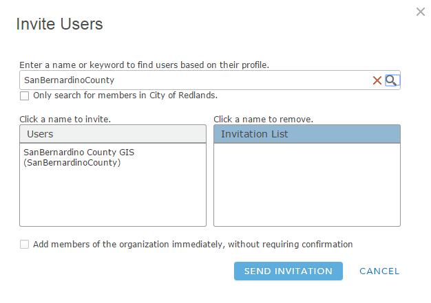

Once your group has been created and configured, it’s time to invite other group members. You can search for the members of both organizations that need to be in the group.
Invite users to your group
You can invite users from as many other organizations as needed. You can create a group that consists of only your organization and one other organization, or you can share content privately with multiple organizations at the same time. As always, you can invite users from your own organization as well.

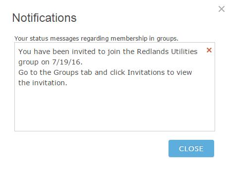

Users invited to join the group will see a red notification alert next to their profile name:
Notification of invitation
When the notification alert is clicked, the user’s notifications are displayed and instructions provided:
Invitation notification info

  • The profile of users from other organizations must be public. If their profile isn’t public, they won’t be searchable when inviting users to join the group. Once invited, they can revert their profile to non-public if necessary. If their profile cannot be made public, your group can be configured as public and allow others to request members. With this approach, potential group members can request membership to your group without having to make their profile publicly available. Once the group has been joined, you can change the group from being public to private without impacting the group members or the content shared with the group.
  • Be sure to uncheck the option to only search for members from your own organization (shown above as “Only search for members in City of Redlands”).

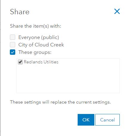

To share layers, maps, apps, and other items with your new group, go to the details page for the item you wish to share and select the group you created in step 1. You may also share the item with the organization, as well as any other groups. This will vary, depending on the specific needs of your organization or the project.
Share items with the group

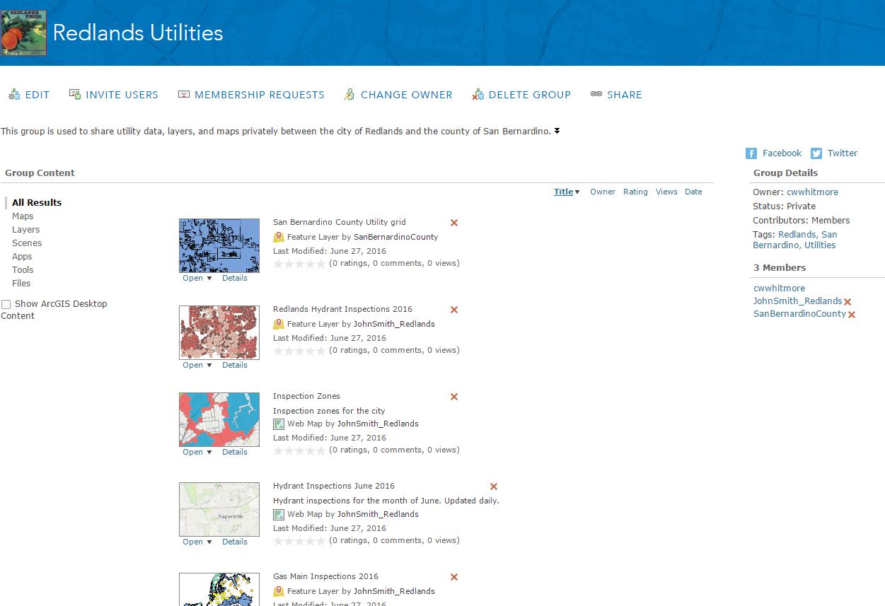

Group configured and items shared privately
