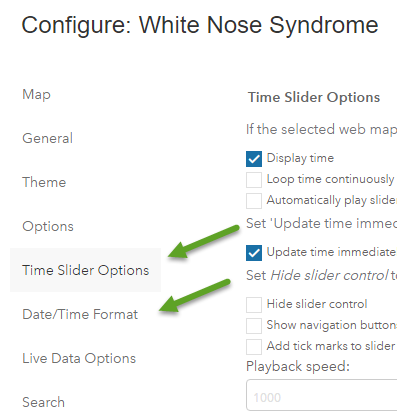

The Time Aware configurable app includes a slider that enables the viewer to play, pause, and interactively move forwards and backwards through time, depending on how it has been configured. The primary tabs for controlling slider functionality and appearance are Time Slider Options and Date/Time Format, found along the left side of the configuration panel.

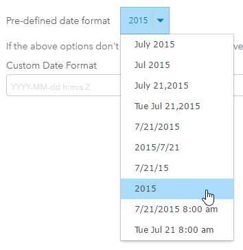

In the Date/Time Format tab, pre-defined date formats can be chosen from a drop-down list.
For example, to display a year, choose the pre-defined date format “2015” from the drop-down. The Time Aware slider appears as shown below:

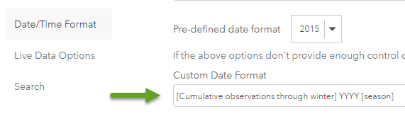

The date actually represents a season – 2012 on the slider represents the winter 2012 season, spanning the end of 2012 and beginning of 2013. To remove any ambiguity, a custom slider label can be created by adding text to the formatted date.
To add text, go to the Date/Time Format tab, and in Custom Date Format construct a string for the slider label. The Date can be expressed in a variety of standard formats, such as YYYY or YYY-MM-dd, and text can be placed within braces – [ and ]. Since our time animation settings were also cumulative, we used the following string in Custom Date Format:
[Cumulative observations through winter] YYYY [season]
The slider now appears as shown below:
