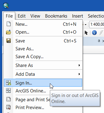

Step 1. Open ArcMap and sign in to your account if you have not done so already. Click File, then Sign In…

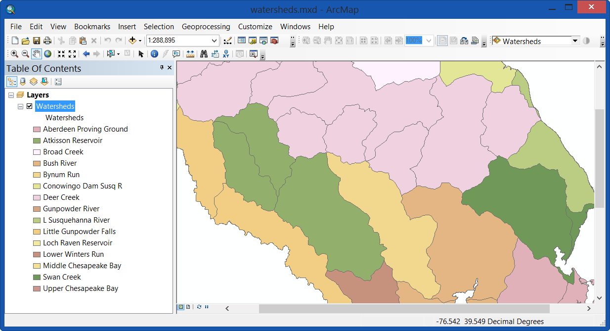

Step 2. Author the map as you want it displayed in the hosted layer.

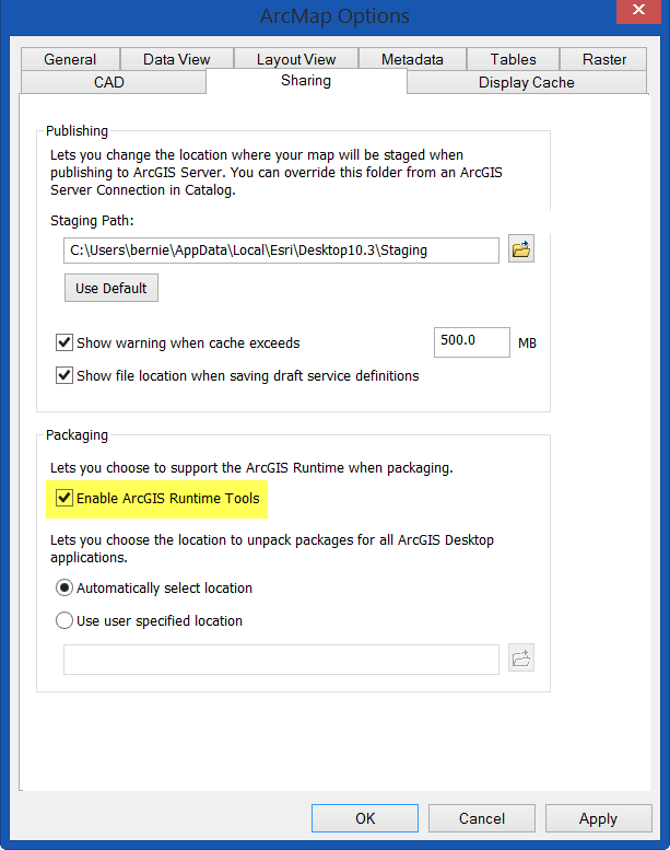

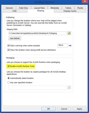

Step 3. Enable Share As Tile Package. The option to Share As Tile Package will not be available unless you have enabled the ArcGIS Runtime tools. In the Customize tab, choose ArcMap Options…
In the Sharing tab check the box to Enable ArcGIS Runtime Tools, highlighted in yellow below:

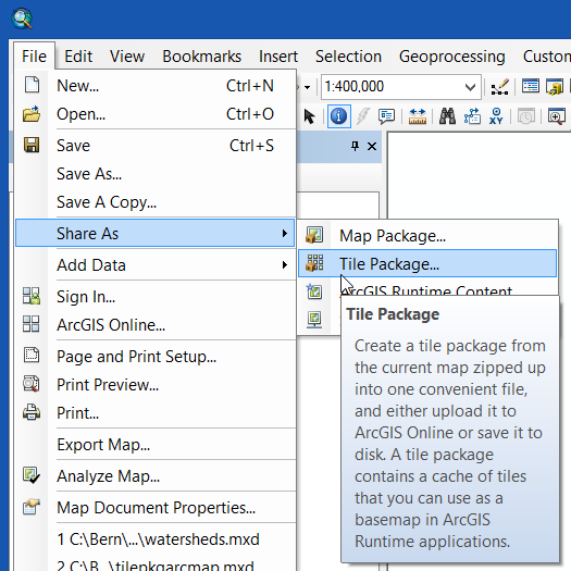

Step 4. Click File, Share As, then choose Tile Package.

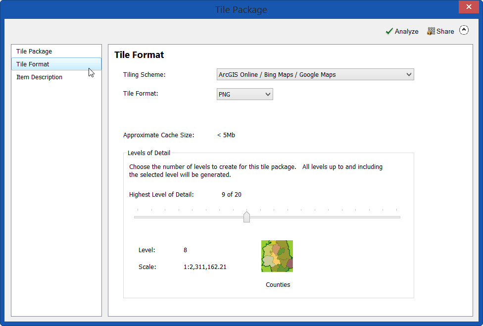

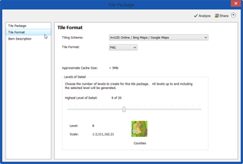

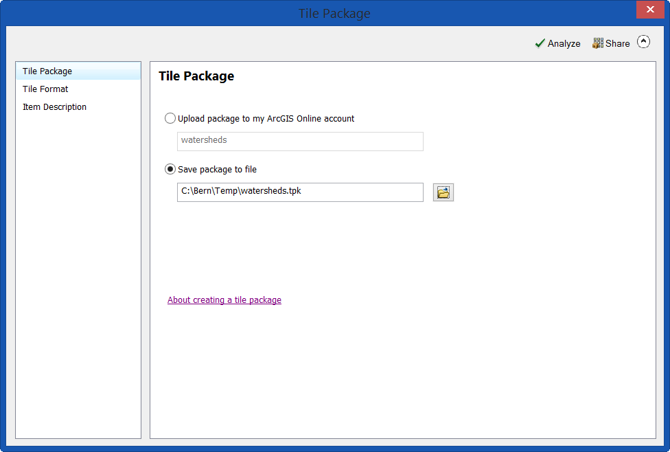

Step 4. Specify the desired options in the Tile Package dialog. Options include:
  • Tile Package: Choose to upload the tile package directly to your ArcGIS Online account, or save the tile package locally and upload it later.
  • Tile Format: Choose the tiling scheme and format. If unsure, accept the defaults. Set the highest level of detail desired for tile creation. This setting will determine the scale at which tiles will be displayed, and will change the size of the tile package – the higher the level of detail, the more tiles will be created, and the larger the package.

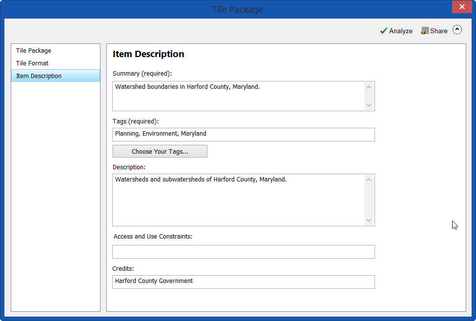

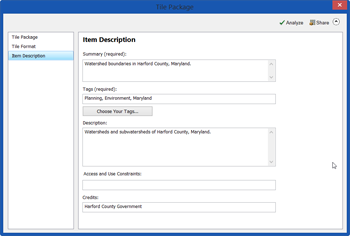

  • Item Description: Include the required information for creating the tile package. If the Map Document Properties (File > Map Document Properties) have previously been completed, they will be displayed.

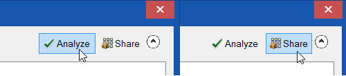

Step 5. Create the tile package. Click Analyze to check for any errors or warnings, and correct as necessary. Then click Share to create the tile package.
Note: Tile packaging in ArcMap occurs in-process, meaning that ArcMap will be busy until the tile packaging is complete. Tile package creation can take a few minutes, or many hours (even overnight or longer), depending on the extent of the data and levels of detail chosen.

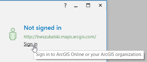

Step 1. Open ArcGIS Pro and sign in to your account if you have not done so already. In the upper right corner click Sign In.

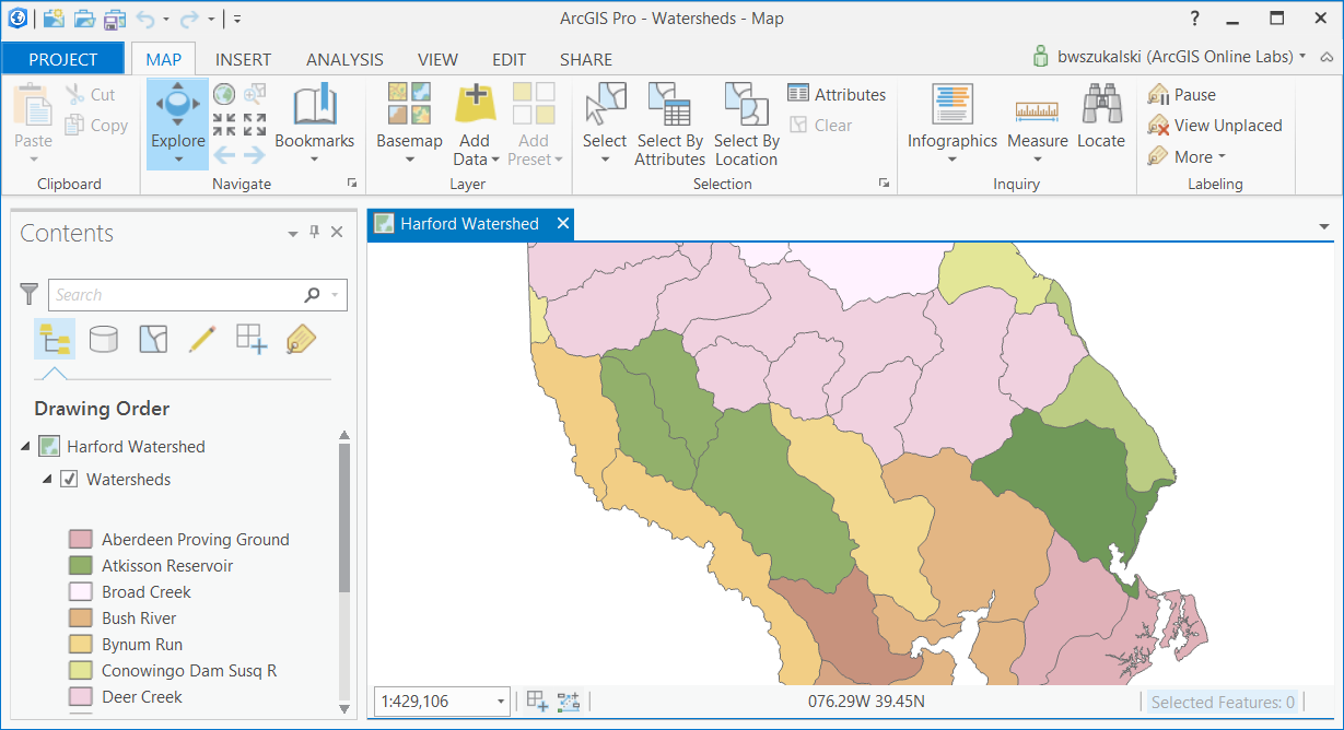

Step 2. Author the map as you would like it displayed in the hosted layer.

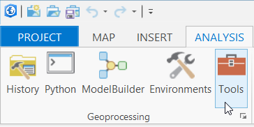

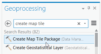

Step 3. Open the Create Map Tile Package tool. On the Analysis tab, click Tools.
If the tool is not already in your recents or favorites, locate it using search in the Geoprocessing pane.

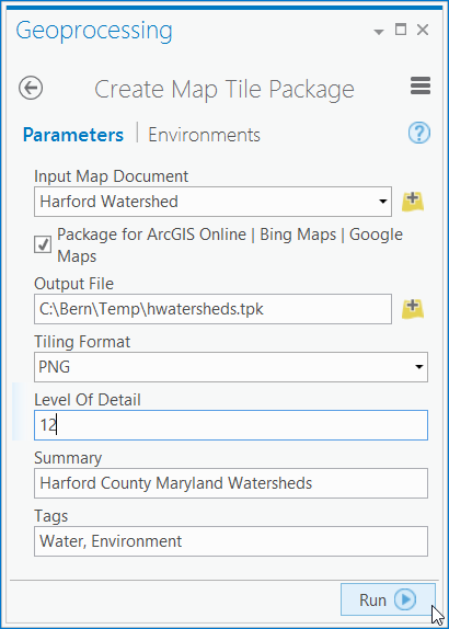

Step 4. Create the tile package. Complete the information and options in the Create Map Tile Package tool pane, then click Run.
The tool runs in a separate process, so you can continue to work in ArcGIS Pro. Check the notification area in the tool pane for successful completion.

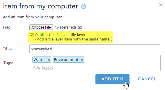

Step 2. Go to My Content, click Add Item, and choose From my computer.
Step 3. Browse for the tile package, enter a title and tags, and click Add Item. Note that you can choose to publish the tile package immediately on upload, or can upload the item and publish it later. The option is highlighted in yellow below.

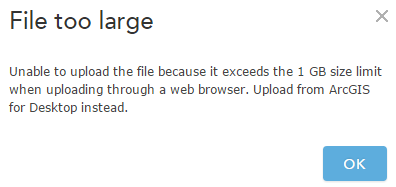

When attempting to upload tile packages exceeding 1 GB, you will see the following message. If the tile package exceeds the size limit for web uploading, upload the package using ArcGIS for Desktop (described below).

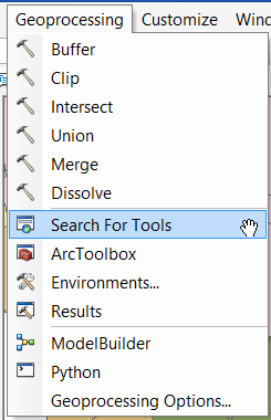

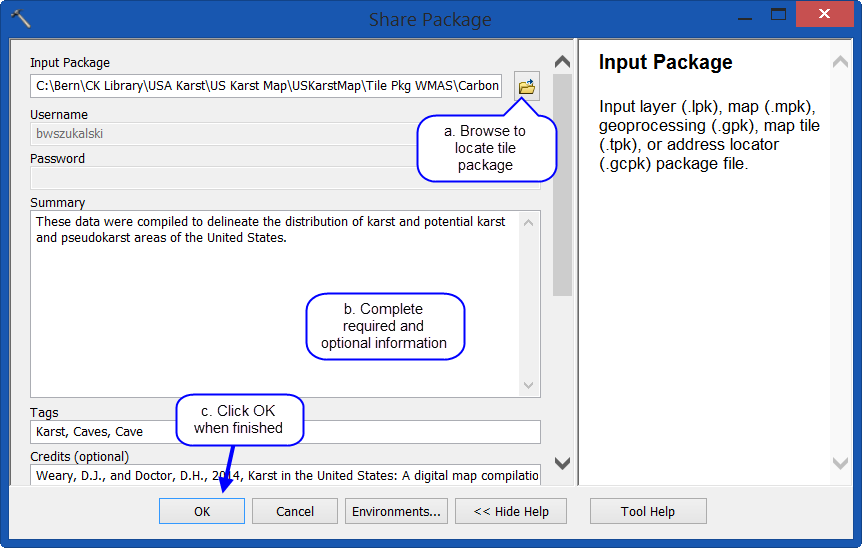

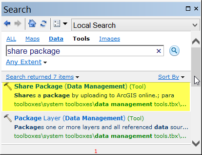

Step 2. Open the Share Package geoprocessing tool. Click Geoprocessing, then choose Search For Tools.
Enter “share package” and locate the Share Package (Data Management) tool, highlighted in yellow below.

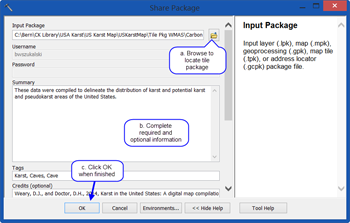

Step 3. Upload the tile package by browsing to choose the tile package from its location on disk, completing the required and optional information, then clicking OK.
The tile package item will be uploaded to My Content.

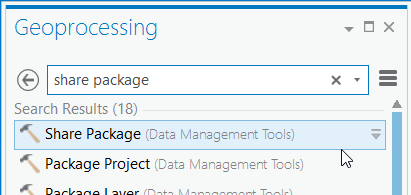

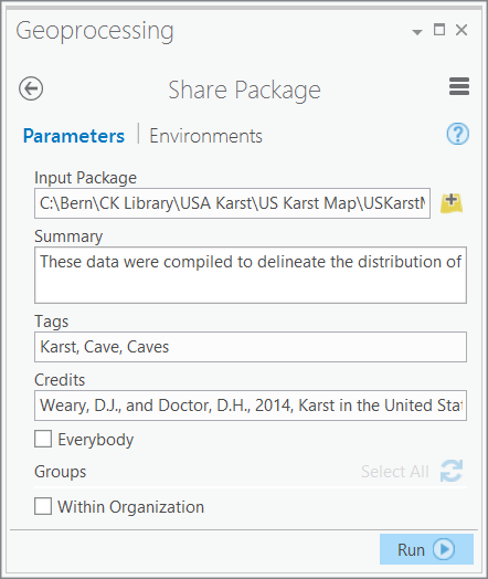

In the Geoprocessing pane, enter “share package” in search to locate Share Package (Data Management) highlighted below.
Step 3. Upload the tile package by browsing to the the package location on disk, completing the required and optional information, and clicking Run to execute the tool.

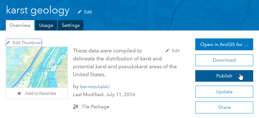

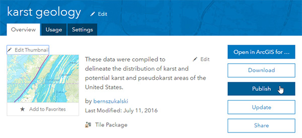

If you have not previously published the tile package, open the item details and click Publish. Note that you will need publish privileges to create hosted layers.

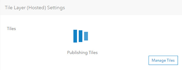

A new tile layer item will be created, and Publishing Tiles will display until publishing has completed.
