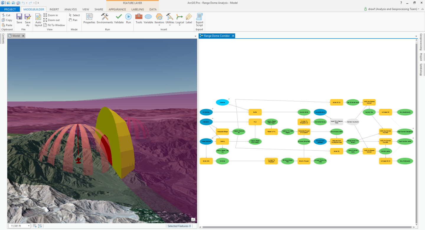

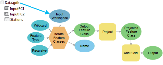

Does ArcGIS Pro have ModelBuilder?
Yes, you can build geoprocessing models in a ModelBuilder view, and run those models in the same ways you do in ArcMap. You can learn about ModelBuilder in ArcGIS Pro here and get migration tips here.
Will models built in previous versions of ArcMap work in ArcGIS Pro?
Yes, most of the time. There are a few exceptions:
- If a tool in the model is not yet available in Pro, then the model will not work. You may need to wait until that tool is available in a future release of Pro, or you can remove the tool and try to find a workaround.
- If a tool in the model has changed in Pro, then the model will not work until you update the model (simply open the model in Pro, validate, and save). Refer to a tool’s help page to determine what needs to be changed for the tool to work in Pro. One common issue is the Calculate Field tool has changed to support only Python expressions. Learn more about that specific change here.
Caution! Models that are built new, or opened and saved in ArcGIS Pro, cannot be directly used in ArcMap. But you can always save the containing toolbox as a previous version (10.3, 10.2, etc.) and then use that toolbox back in ArcMap. It’s safest to make a copy of the original toolbox before modifying any models in Pro.
What is the difference between Tasks and ModelBuilder?
Tasks and ModelBuilder are conceptually similar, but have different goals and capabilities.
Tasks are a set of preconfigured steps through a process or workflow in ArcGIS Pro. Task steps can include any GIS tasks, such as zooming to a specific feature, editing a layer, running geoprocessing tools, authoring a map, and sharing it online.
ModelBuilder on the other hand is specifically designed to author and automate geoprocessing workflows. It includes features to support powerful operations like batch processing and simulation, and can be used to create a custom geoprocessing tool that can be used by others with different data.
Tasks are not a replacement for ModelBuilder, and ModelBuilder tools can even be included as one step in a Task.
