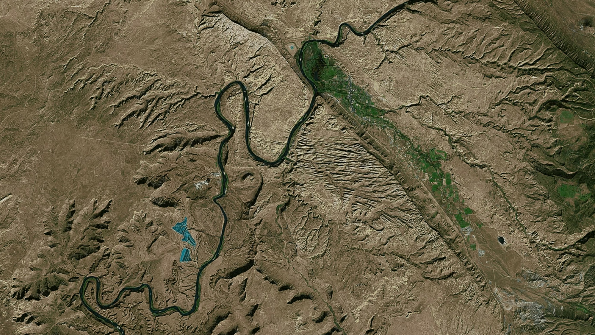

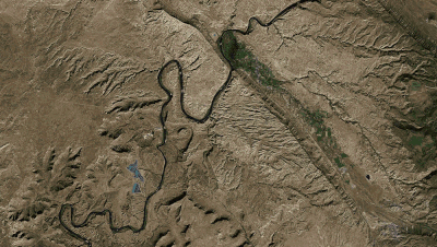

In ArcGIS Pro, I’ve set my basemap to Aerial and navigated to an especially topographically interesting part of the United States around Moab, Utah.

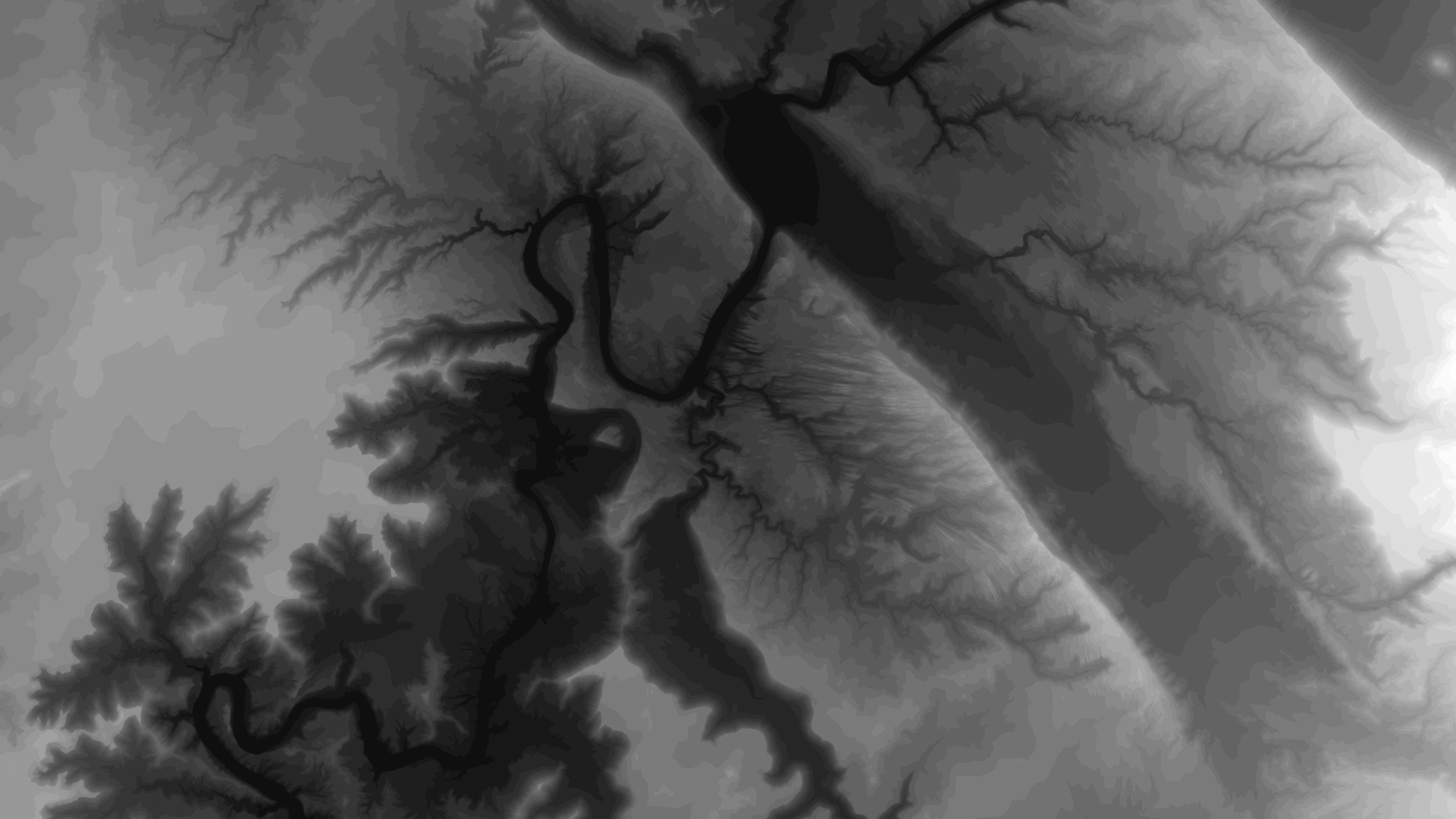

Next, I pull in a DEM layer from the Living Atlas. There are lots of options, but I happen to be using “Terrain: Ellipsoidal Height.” The default symbology of a DEM is generally white (high elevation) to black (low elevation).
This is the only layer I’ll be monkeying with to try to approximate the lighting effects, similar to that of Allen’s sunrise photo, and the alpenglow image from the International Space Station. It will be used once to create a hillshade layer, and then two more times to re-create darkness and fog. Let’s do this!

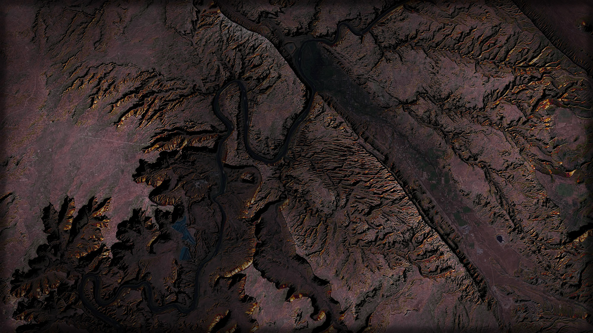

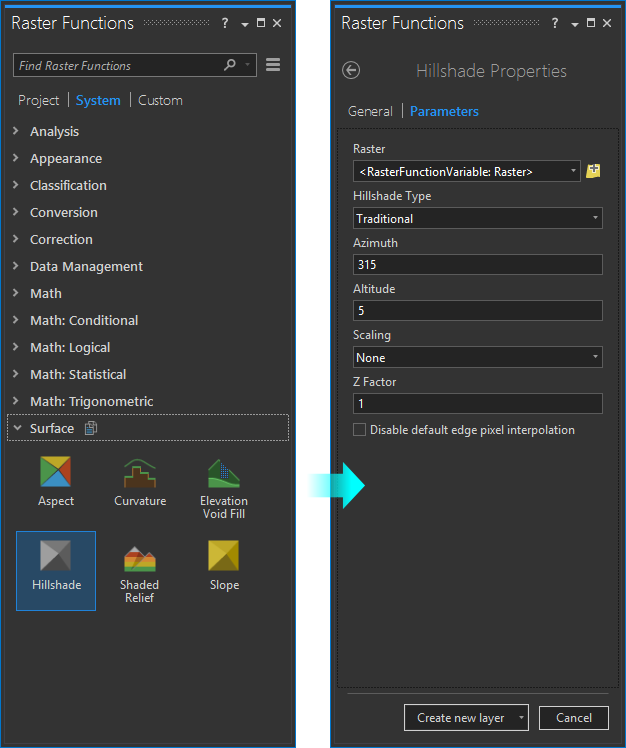

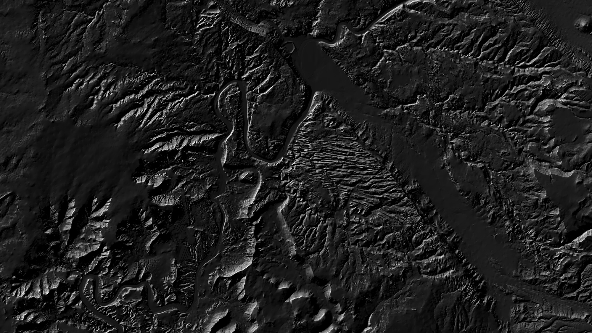

In ArcGIS Pro, from the “Imagery” tab, I select “Raster Functions.” In this menu there are a host of interesting options to hammer on the DEM. Within the “Surface” category of raster functions is “Hillshade.”
In the Hillshade menu (psst, did you notice the dark Pro theme? It is a beautiful new feature of 1.4), you can set a couple sun-angle preferences. The first is the origin of the light source. I leave it at the default, which is from the northwest. Even though this is pretty much the opposite of the real life light source in the Northern Hemisphere, it’s what our brains generally want to see (otherwise our visual systems tend to invert it, making valleys look like mountains, etc.). The important bit is the “Altitude.” This replicates how high the sun is above the horizon. The default is 45 degrees, but I want to replicate a sun that is barely skirting over the horizon, so I set mine to just 5 degrees.
The result is still an amazing thing to me. The previously flat gradient blobs now look like peaks and troughs -like something I could touch. Seeing a hillshade paint in is one of those frequent opportunities to marvel at how awesome it is to be a cartographer.
It’s pretty dark looking because of the low sun angle I gave it. But there’s no reason you need to stick to the default color gradient used to paint in these pixels. My absolute favorite feature of ArcGIS Pro is the ability to include a transparency within color gradients. It opens up so many amazing cartographic options.

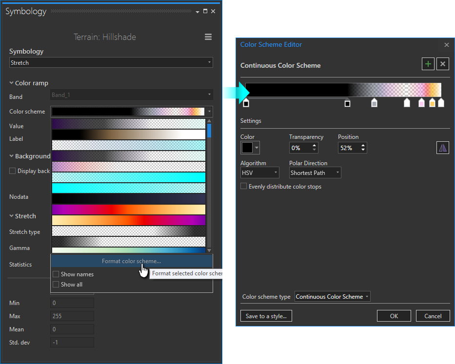

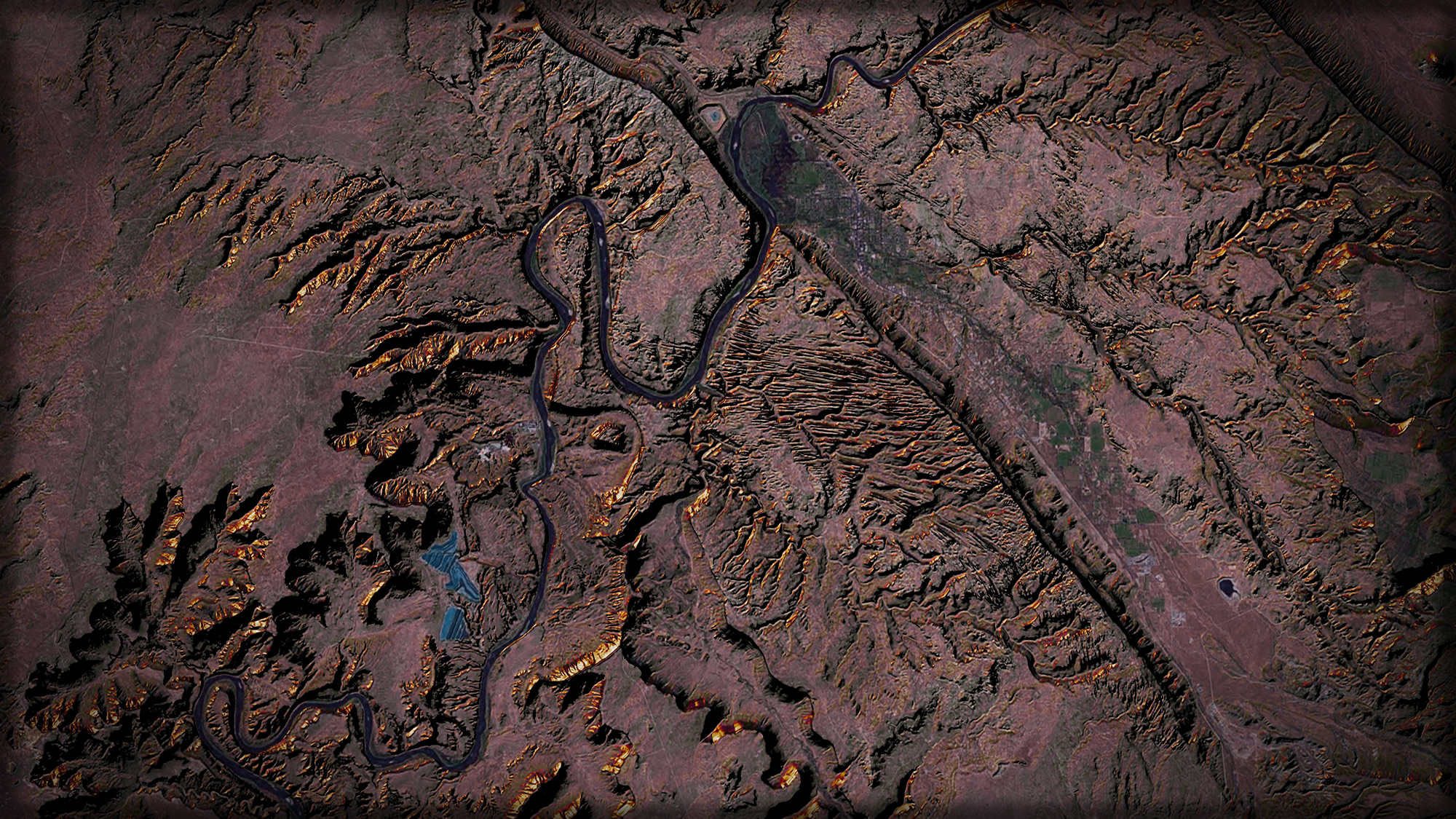

Today the cartographic option I want to exploit is defining a color (and transparency) gradient that somewhat resembles the beautiful golden hues in Allen’s photo. So, I opened up the symbology menu and dragged colors (and transparencies) around until I got something that seemed passable (if you’ve read other posts of mine you may recognize some of the other gradients in the droplist).
Here, I’ve settled on a gradient that is full black all through the shadows, transitioning into a transparent slate blue in the mid ranges (areas of flat topography). Then the transparent slate blue transitions to the magentas and golds on the steepest sunrise-facing slopes, right into full white. The resulting hillshade layer, when drawn on top of the aerial imagery, looks like this…
That is a really big difference from the raw aerial imagery we were looking at a moment ago. Now, the hillshade layer is painting in the long deep blue shadows and splashing the vibrant golds of sunrise against the steep sunny-side faces of the terrain. I like it.

When perched in a plane, looking down, I notice that the lower elevations tend to get less overall light. Makes sense. So next I’ll add the raw DEM layer again, with the goal of tweaking the color gradient to full black at the lowest elevations of the area, and fade up to fully transparent near the highest elevations. And then I’ll draw it on top of the hillshade layer -since the bright reflective surfaces of sunrise illumination don’t actually happen in basins and valleys.
The result, when drawn on top of the hillshade and aerial imagery, adds a sense of depth to the relief, giving the mountains greater dimensionality and realism.

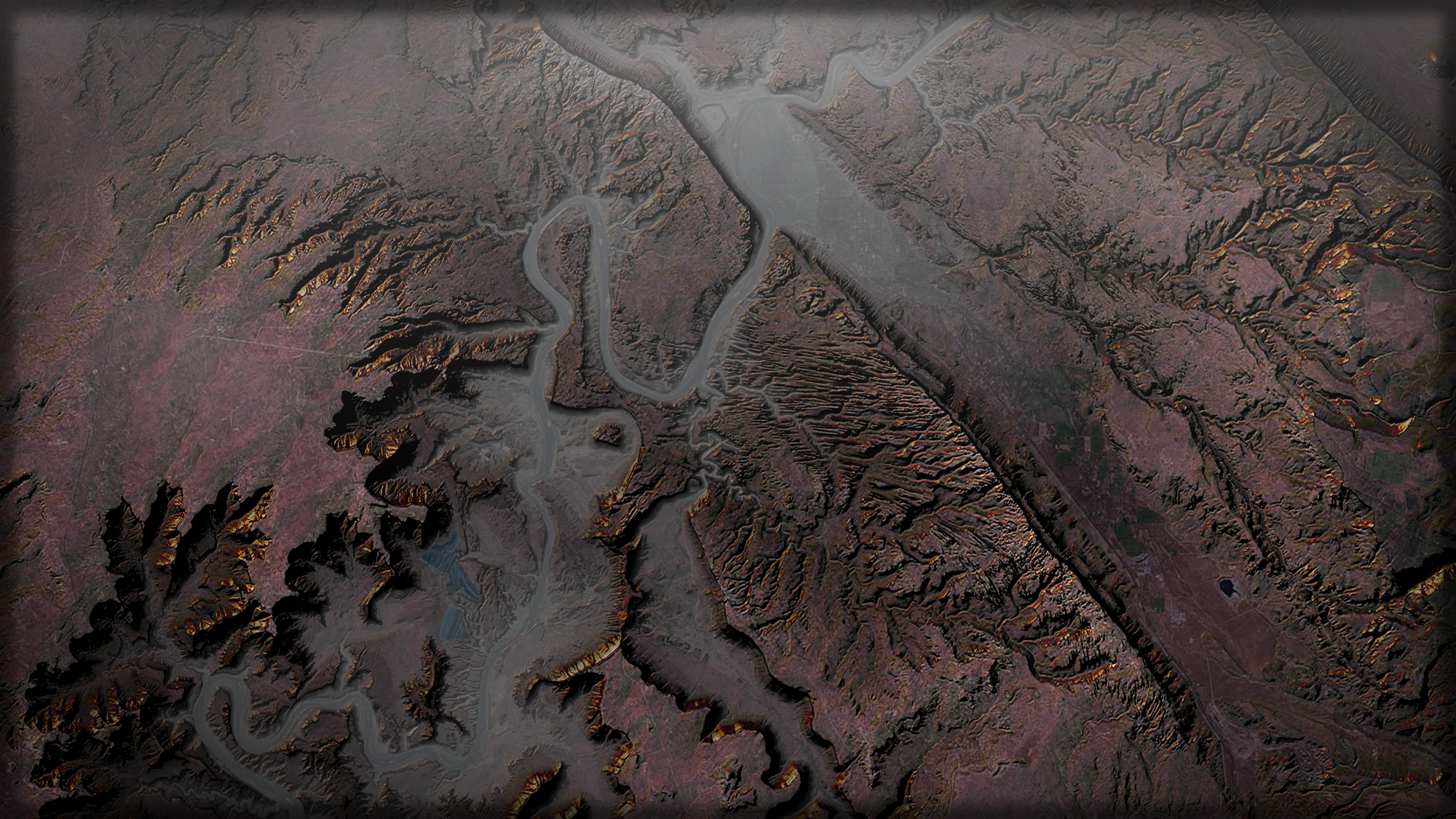

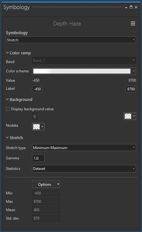

Pulling in the trusty DEM a third time, I set the symbology gradient to a wispy white at the very lowest crevices of the landscape.
Now, this addition of mist on top of the darkness layer, the hillshade layer, and the aerial imagery, gives the view an atmospheric sense of a landscape in an early morning inversion.
Click to embiggen…
There it is. Hacking a sunrise using only an aerial basemap and a DEM layer rendered in three different ways.

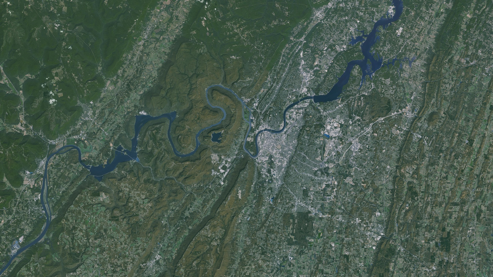

Here’s a stretch of the Appalachian Mountains from above…
And here it is with a hacked sunrise…

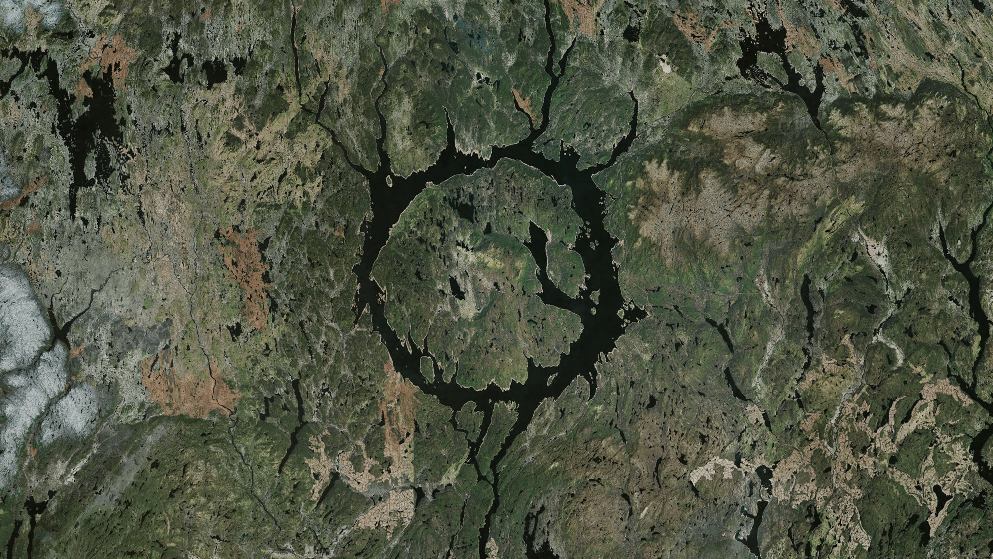

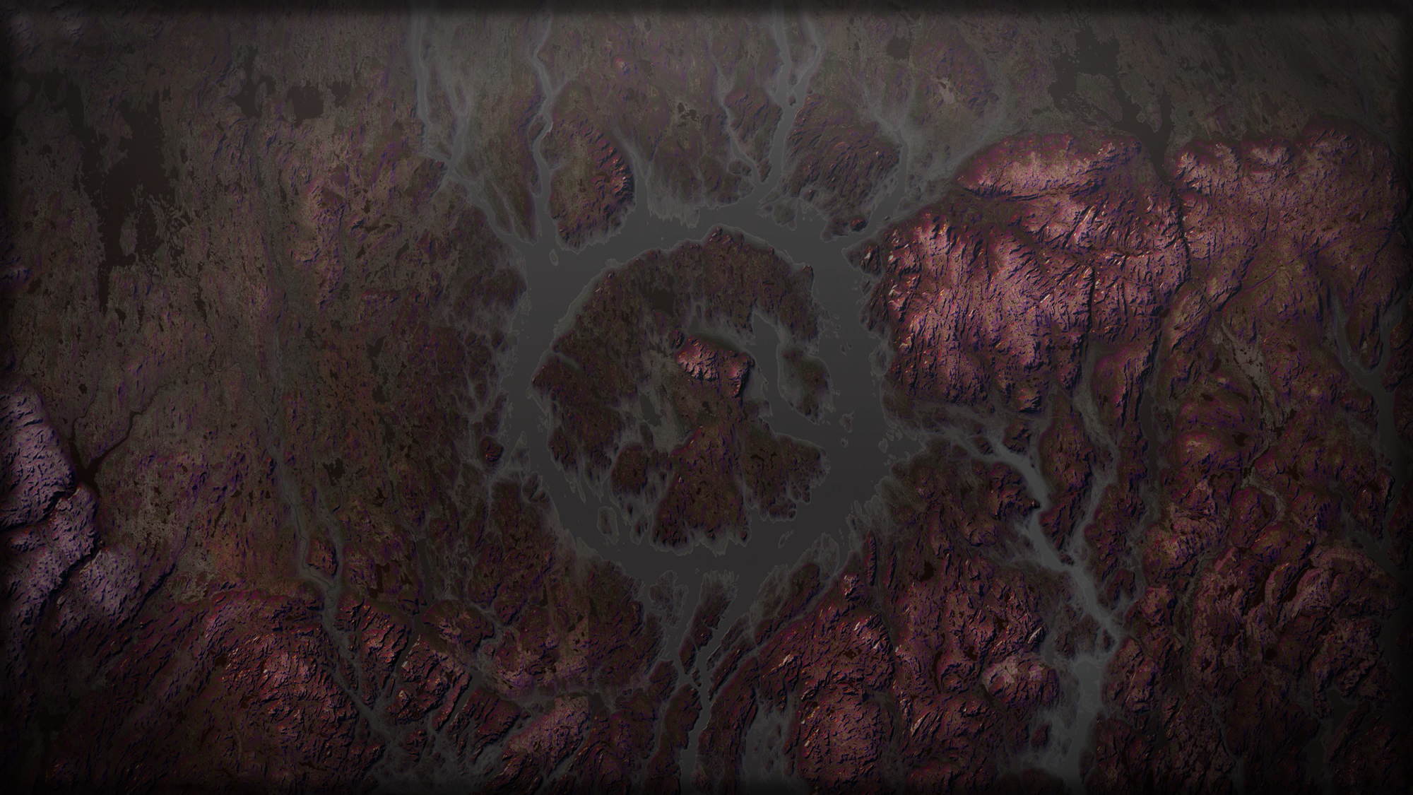

This is the already-amazing Manicouagan crater in Quebec, Canada…
And here is what it might look like from your window seat on an early morning flight…
