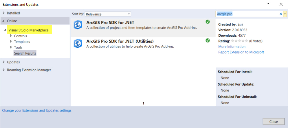

  • VSIX Packages – Installation is now through VSIX packages only, which are available from My Esri and also are available directly through the Visual Studio Marketplace.  MSI installer packages for the Pro SDK are no longer supported at 2.0.
The following is a screenshot of accessing the Pro SDK installation from the Visual Studio Marketplace directly within Visual Studio 2017:

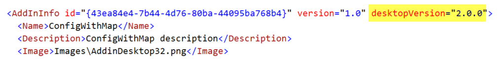

The process for migrating your 1.x add-in code to 2.0 is straight-forward:
  • Change the desktopVersion attribute in your Config.daml ArcGIS element to “2.0”
  • Recompile your code (whether your code has breaking changes or not)
  • Fix any compilation issues due to API breaking changes

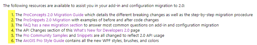

Detailed information, as well as links to migration procedure documents and code snippets are found in the Highlights Section of the What’s New for Developers page.
