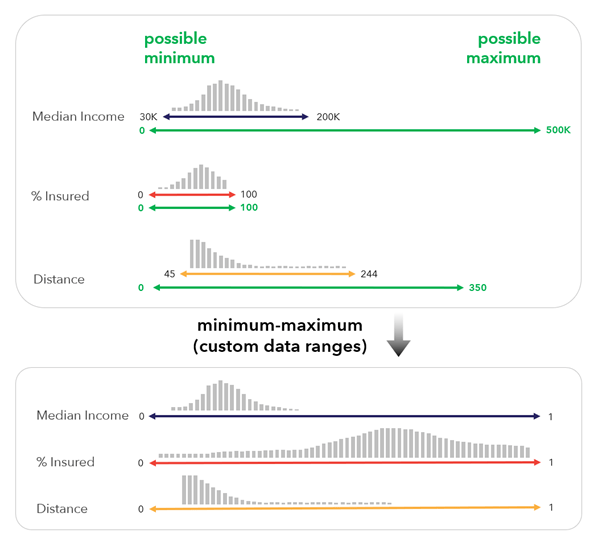

(3) What is the difference between simple min-max and custom min-max scaling for pre-processing input variables?
A simple min-max scaling takes the minimum value in the variable’s range and assigns it to 0, and the maximum value in the variable’s range and assigns it to 1, and scales every value in the middle between 0 and 1. This can be a great way to get all of your variables on the same range while retaining data distributions. For min-max with custom data ranges, the values assigned to 0 and 1 are specified by you, the user. This could allow you to use a standard scale over time (not changed by each year’s respective min and max), or to set up the scale with a theoretical minimum and benchmark maximum
illustration showing how custom min-max scaling

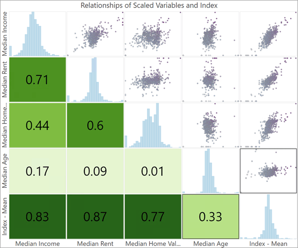

(5) How do you make correlation- and scatter-plots?
The correlation plots and scatterplot matrices we share in demos are automatically created as output with each run of the Calculate Composite Index tool.
You can also create these plot matrices yourself outside of the tool as a pre-analysis step using the built-in charting in ArcGIS Pro.
correlation and scatterplot matrix

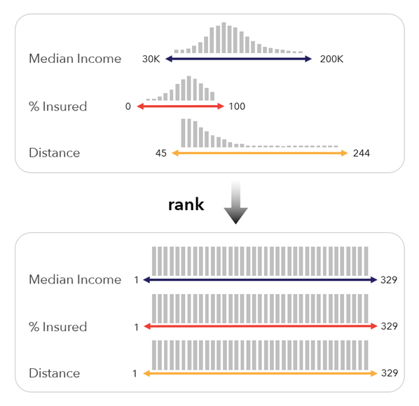

There are no distributional assumptions when calculating a composite index, but it can be useful to know if your pre-processing methods will be affected by things like skew or outliers. Methods like min-max scaling are very susceptible to what we call “data compression” when there are extreme outliers or extreme skew, so something like a percentile or rank scaling could be more appropriate.
illustration of the rank pre-processing method
