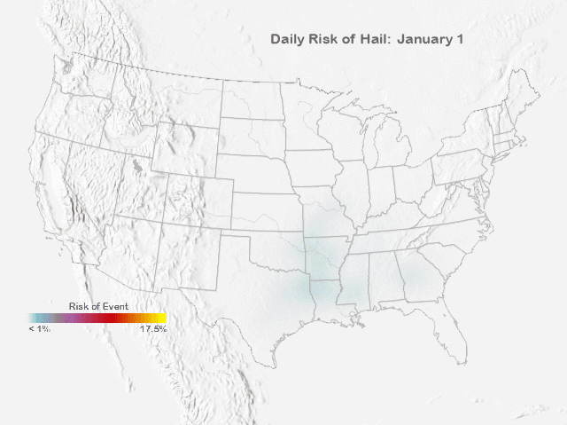

Daily risk of hail. The risk value can roughly be interpreted as the probability that an extreme weather event will occur on that day within 80 km of the location. A hosted imagery layer for use in visualization and analysis workflows is available here.

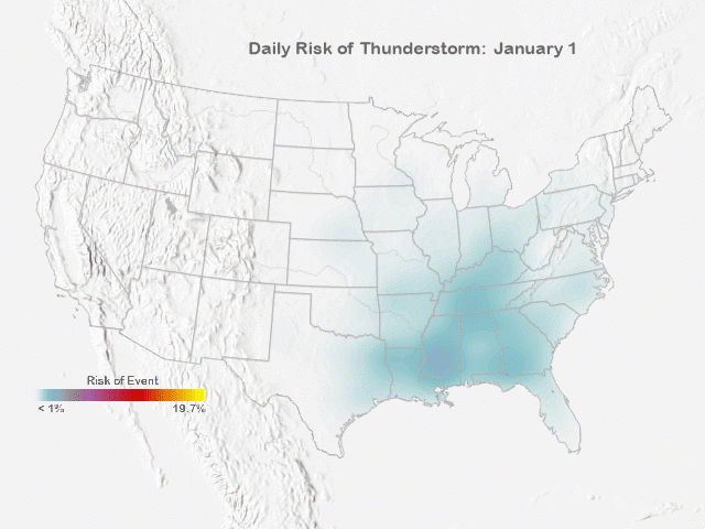

Daily risk of thunderstorm wind. The risk value can roughly be interpreted as the probability that an extreme weather event will occur on that day within 80 km of the location. A hosted imagery layer for use in visualization and analysis workflows is available here.

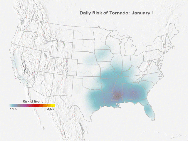

Daily risk of tornado. The risk value can roughly be interpreted as the probability that an extreme weather event will occur on that day within 80 km of the location. A hosted imagery layer for use in visualization and analysis workflows is available here.

This analysis builds on NOAA’s well-established techniques for severe weather climatologies but uses Space Time Kernel Density to calculate probabilities of severe weather events across space and time. The input data comes from NOAA’s Storm Events Database, which documents significant weather events with sufficient intensity to cause loss of life, injuries, or substantial property damage. The database contains point locations and includes date ranges for each event type: hail (1955–2023), tornadoes (1950–2023), and severe wind (1955–2023). In total, the dataset used includes 74,299 tornadoes, 494,107 severe wind events, and 379,295 hail events.
These event points were processed using the Space Time Kernel Density tool. For this analysis, a spatial bandwidth of 240 kilometers, a temporal bandwidth of 30 days, and a cell size of 80 kilometers were specified (roughly equivalent to the values used by NOAA). The tool calculates smoothed density values and converts them into expected counts, representing the probability of severe weather occurrence at each location over time. Additionally, the kernel smoothing helps address locational and temporal uncertainty in the dataset, mitigating inaccuracies in the reported event coordinates.
Once the expected counts were generated by the kernel density tool, they were aggregated into recurring daily values (one map for each Julian day of the year) using the Aggregate Multidimensional Raster tool. This step created daily averages for each location, representing the likelihood of severe weather on any given day of the year. The resulting data allows you to explore spatial and temporal patterns of severe weather risk while accounting for data limitations and seasonal variability.
